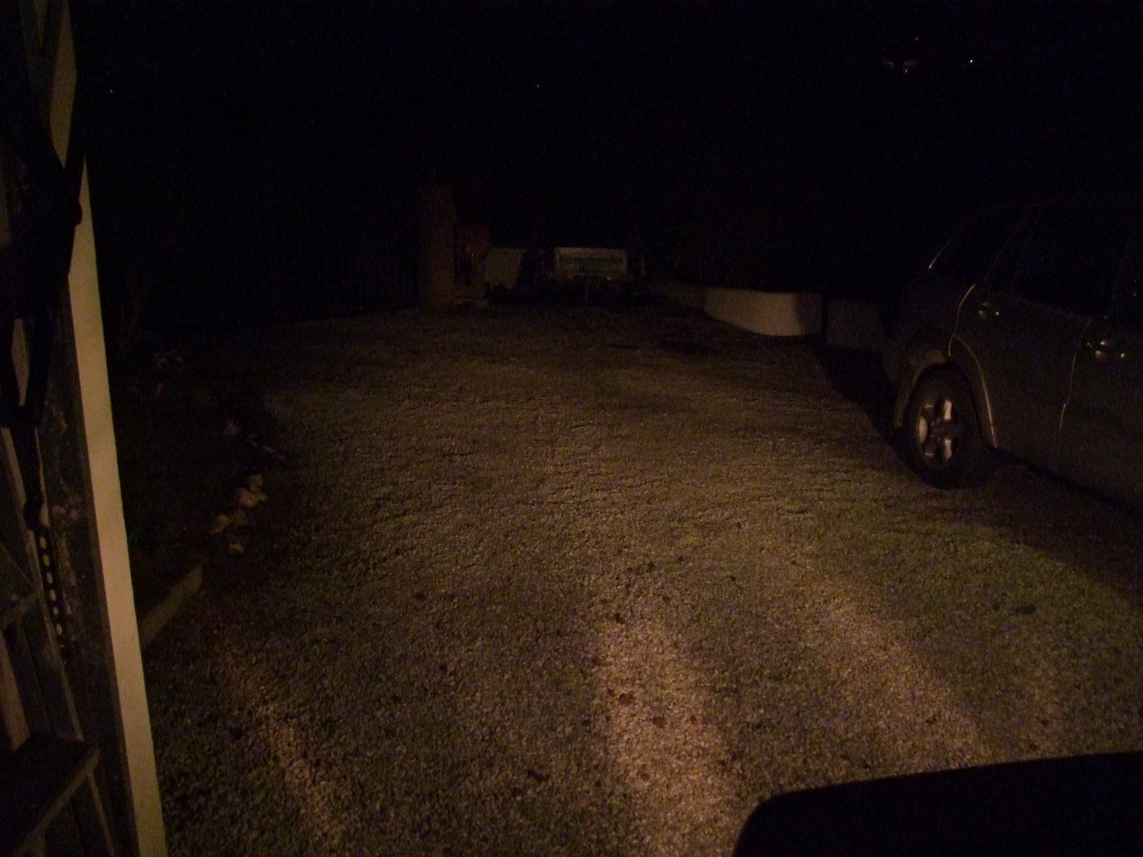

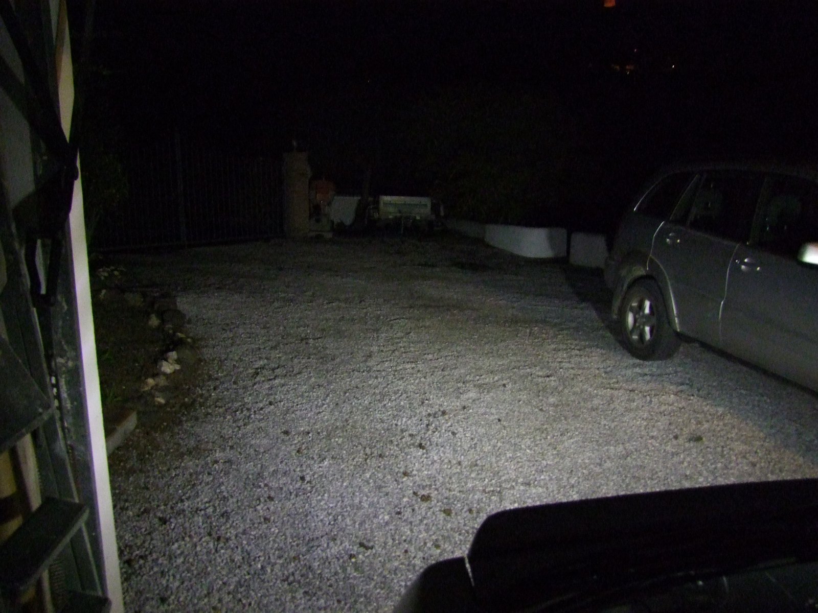

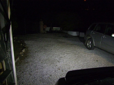

Have upgraded rev lights on both XM and RAV4 last year.
XM bulbs were originally standard tungsten P21W 21-watt bayonet, behind a smoky-black tail panel.
replaced with these...
Available in different base types.
Check the overall length of these and existing bulbs, as the LED items are slightly longer.
Colour output of these is cool white, but not bluish.
A 50W version also available, as are canbus versions.
NB wattages are roughly tungsten equivalent light output, not actual LED consumption.
XM Before: After: Same camera settings Cree produce some of the highest quality LEDs, and the curved reflector arrangement on these lamps is well thought out. MAXGTRS shop on Ali has search and browse tools.

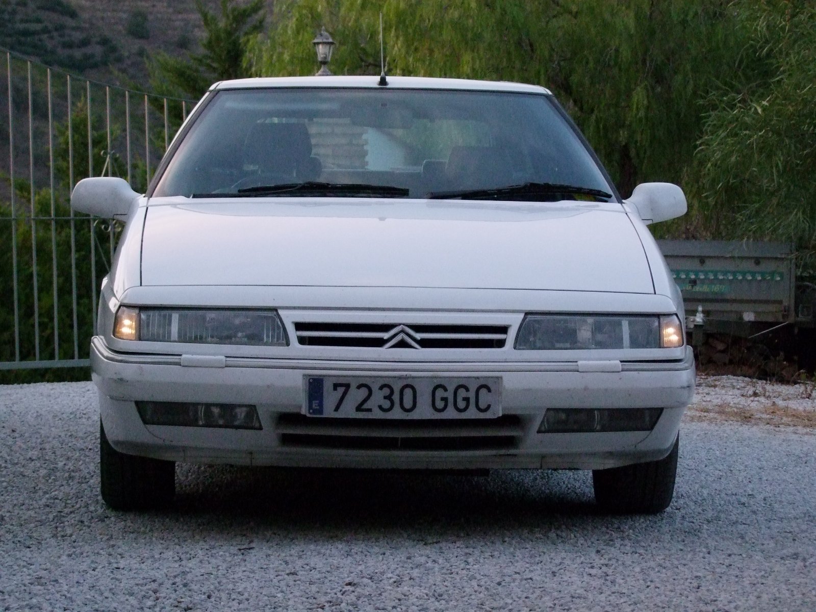

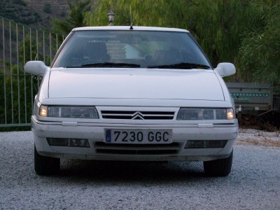

_________________

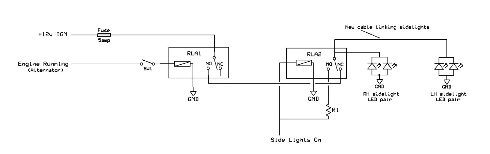

Have also used 50W (warm white) W5W versions for turning the XM's small sidelights into DRLs...
2 x 50W fitted, as not enough space for 1x100W... Side-light brightness... DRL brightness... Circuit
DRL full brightness only operates when
- engine running (alternator outputting), and lights are Off
At reduced illumination (equal to originals) when
- lights are switched on, engine running or stopped R1 for those two 50W LEDs was 130R. Used 2 x 68R (2W) in series.
The 'engine running' connection was made to the Alternator small terminal, which leads off to the dash warning light.
The two small relays, resistor and switch were mounted in a small ABS box, with the six cables leading off to the various engine-bay connections.
_________________

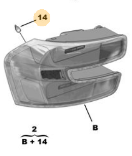

Hi Willy - this is correct - just keep everything to do with this issue in the same thread
Edit
Chris posted his response before I submitted mine, but unfortunately it won't be relevant in this case because you have the LED design and cannot swap these as they are not standard fittments, but a module.
For your specific Picasso according to your VIN you have the rear LED lamp cluster - so apart from the bulb shown below (item 14) which is a W5W filament bulb, the others will be a complete module and not user serviceable. You can't replace the components yourself and if faulty, will need to replace the cluster.
That's why we ask for the VIN, so we can tell you what you have. Other models depending on trim level may have all standard bulb light clusters. There are 3 types that were available and yours in the LED version above.
Now a word of warning!
Before you go tearing it apart, consider the replacement cost of the rear light clusters:
Left Rear Cluster, part number: 9678271580 £606.04 inc. VAT
Right Rear Cluster, part number: 9678271380 £654.78 inc. VAT
So unless you are planning to sell off the family jewels, I would leave well alone to be honest unless faulty.

Never mind, Chris. Thanks for trying.white exec wrote: 07 Feb 2020, 12:37 Yes, sorry about that - unfortunate timing - and not relevant to Willy's rear clusters.
BTW, I LOVED my XM 3.0 - wonderful car, but my Grand C4 Picasso has everything the XM had (except the hydraulic suspension) in spades, and more. My 2.0 Bluehdi 150 Picasso is just as comfortable, much faster through the gears but the same on top speed, and so much more usable than my XM, RIP 2010.
Willy

Thanks Marc,GiveMeABreak wrote: 07 Feb 2020, 12:04 Hi Willy - this is correct - just keep everything to do with this issue in the same thread![]()
Edit
Left Rear Cluster, part number: 9678271580 £606.04 inc. VAT![]()
Right Rear Cluster, part number: 9678271380 £654.78 inc. VAT![]()
I already knew about the unbelievable price - why £50 difference between left and right..? - which was why I asked before attacking mine. I have a friendly car breaker near me, so I'm going to see if he has one I can buy and strip that down. If I find anything, I'll report back here.
