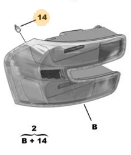

Please forgive me if I have not followed correct protocol here (not sure if continuation of the thread is allowed or if I have to start the whole conversation again).GiveMeABreak wrote: ↑05 Feb 2019, 12:11 That 'projector' is simply a plastic lens that covers another LED inside at the bottom and magnifies that light outward - it does nothing for the LEDs mounted around the bulb itself.
Example:
I am getting to the point of ripping my tail light cluster apart to see if the reversing LEDs are plug-in or dedicated LEDs permanently attached to the cluster. There are improved replacement LEDs available from HORIZON LEDs ( www.horizonleds.co.uk ), but they don't know if those in my 2015 Excl+ Grand Picasso are replaceable or not
Do you know if anyone has opened the tail light cluster to check? In desperation I'm getting to the point of endangering the life of one of my tail lights just to see if the BRAKE and Reversing LEDs are replaceable.
2015 (Jul) C4 Grand Picasso 2.0 Bluehdi 150 EAT6 Exclusive+ now running on 17" wheels - SO MUCH MORE COMFORTABLE AND SMOOTH THAN 18" - AND better fuel economy

For your specific Picasso according to your VIN you have the rear LED lamp cluster - so apart from the bulb shown below (item 14) which is a W5W filament bulb, the others will be a complete module and not user serviceable. You can't replace the components yourself and if faulty, will need to replace the cluster.
That's why we ask for the VIN, so we can tell you what you have. Other models depending on trim level may have all standard bulb light clusters. There are 3 types that were available and yours in the LED version above.
Now a word of warning!
Before you go tearing it apart, consider the replacement cost of the rear light clusters:
Left Rear Cluster, part number: 9678271580 £606.04 inc. VAT
Right Rear Cluster, part number: 9678271380 £654.78 inc. VAT
So unless you are planning to sell off the family jewels, I would leave well alone to be honest unless faulty.
