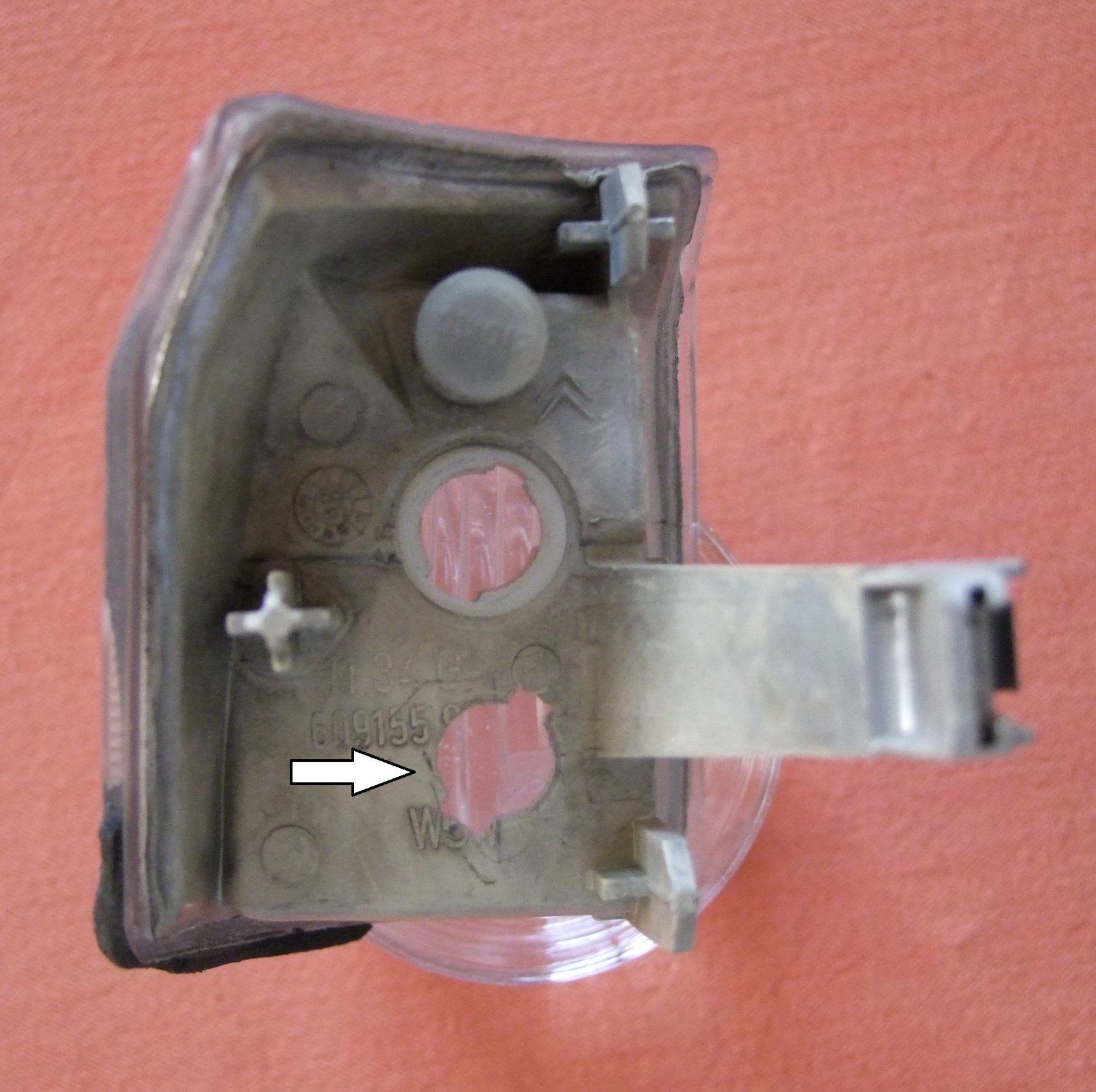

Please forgive me if I have not followed correct protocol here (not sure if continuation of the thread is allowed or if I have to start the whole conversation again).GiveMeABreak wrote: ↑05 Feb 2019, 12:11 That 'projector' is simply a plastic lens that covers another LED inside at the bottom and magnifies that light outward - it does nothing for the LEDs mounted around the bulb itself.
Example:
I am getting to the point of ripping my tail light cluster apart to see if the reversing LEDs are plug-in or dedicated LEDs permanently attached to the cluster. There are improved replacement LEDs available from HORIZON LEDs ( www.horizonleds.co.uk ), but they don't know if those in my 2015 Excl+ Grand Picasso are replaceable or not
Do you know if anyone has opened the tail light cluster to check? In desperation I'm getting to the point of endangering the life of one of my tail lights just to see if the BRAKE and Reversing LEDs are replaceable.
2015 (Jul) C4 Grand Picasso 2.0 Bluehdi 150 EAT6 Exclusive+ now running on 17" wheels - SO MUCH MORE COMFORTABLE AND SMOOTH THAN 18" - AND better fuel economy

Have upgraded rev lights on both XM and RAV4 last year.
XM bulbs were originally standard tungsten P21W 21-watt bayonet, behind a smoky-black tail panel.
replaced with these...
Available in different base types.
Check the overall length of these and existing bulbs, as the LED items are slightly longer.
Colour output of these is cool white, but not bluish.
A 50W version also available, as are canbus versions.
NB wattages are roughly tungsten equivalent light output, not actual LED consumption.
XM Before: After: Same camera settings Cree produce some of the highest quality LEDs, and the curved reflector arrangement on these lamps is well thought out. MAXGTRS shop on Ali has search and browse tools.
