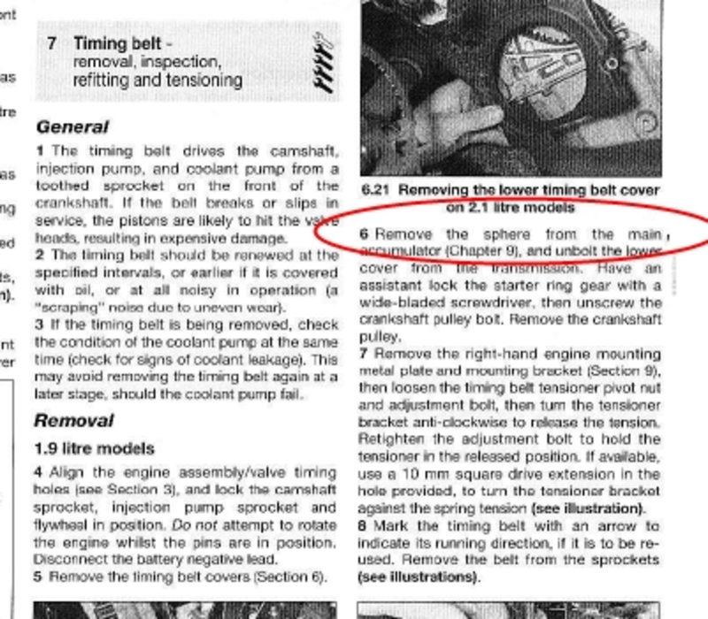

romie wrote:hey, I've not been able to check the pulley plate yet, (lots of rushing around this morning including going back to Citroën and picking up some sphere seals for when I need to remove the front right hand sphere to do the belts... over £6 for two seals!?).
Now I'm confused, why are you removing the sphere to do the belts???
As for the alignment, it is most likely to be off due to the manual tensioner needing to be replaced.

Re: I take it this car has Air Con?
Unread post by romie »
Kenny, good idea about the link!
says so in the Haynes manual :/
hmm?
Unread post by jgra1 »
ahh I see Romie, that's haynes way of being able to lock the crank so you can get the nut undone on the pulley side of engine..
you may want to try the starter motor automated method instead ;)
I have not tried it, but you want a decent breaker bar and socket on the nut, then rotate engine till bar is resting on the ground somwhere under the compressor..
then flick the key briefly ;)
others will check this description..

Unread post by Chris570 »
jgra1 wrote:ahh I see Romie, that's haynes way of being able to lock the crank so you can get the nut undone on the pulley side of engine..
making sure of course that the engine can't start ;)
So I don't need to take the sphere off at all?
Fantastic!
I didn't like the idea of disturbing that when there was nothing wrong with it.
I could see that turning into another project in it's own right :(
... Right-o.
Three cuts on hand, one on head, (from crowbar).
One big argument with 11mm bolt hiding between the top timing belt cover and the turbo feed inlet pipe and fuel line.
Lots of swearing over the total lack of room to do anything in the engine bay...
... and both belts and the alternator is changed.
Didn't undo the crank shaft pulley bolt by turning over the engine in the end. There was a bolt in the flywheel just visible enough that a screwdriver could be wedged in, holding the flywheel and therefore allowed the bolt removal.
Thanks to everyone for your invaluable information and thoughts - greatly appreciated!!
