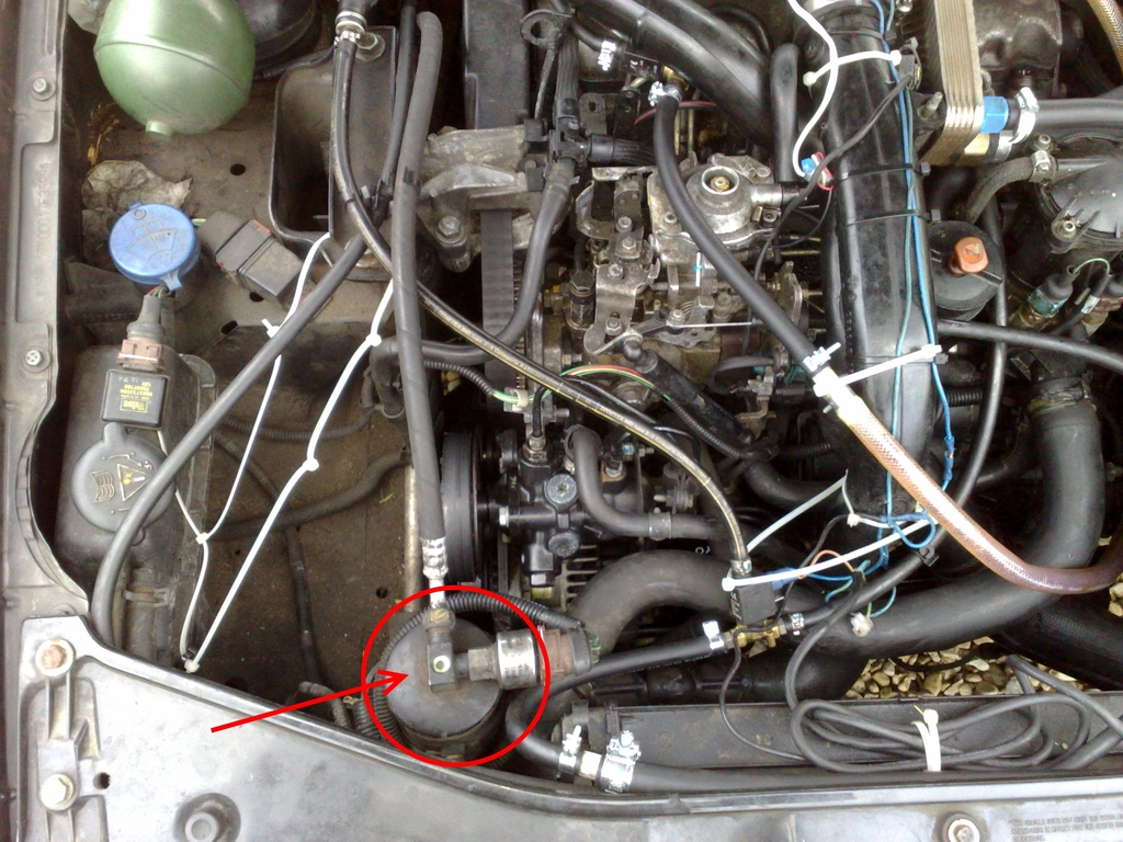

Hey, I need to order a couple of belts for my car, (yes looking at the picture it should have been done years ago!!).
To do this I need to know if this car has Air Conditioning fitted.
It definitely looks like it as it has, what seems to be an air con dryer and three rads, (presumably the air con condenser).
It's a little confusing as there is no indication in the car that is has air con, like an A/C button or some sort of light or something.
Also where is the air con compressor?? In the Haynes manual is says it should be 'above' the HP pump?
Can't see it there?
Can anyone confirm that this car is definitely fitted with air con and that I need the auxillary belt for an air con car?

hi Romie yes thats part of the aircon
comp should be under alternator
John
ps your timing belt looks a little of the inj sprocket?
pps have you wired your wvo heater to the glowplugs? :)

That's the dryer or dehydrator as it's called by Citroen, the compressor is at the bottom under the alternator.
I'm pretty sure the air-con button is to the right of the column on the dash, it has a snowflake emblem.

jgra1 wrote:hi Romie yes thats part of the aircon
John
Thanks :) I'll scrabble under the car later and see if I can see the air con compressor.
Hi, yes both belts are running slightly off. They have been for a couple of years now and don't seem to mind.
I was hoping that changing the aux belt and repositioning would sort the aux belt position out, and so therefore was hoping to only get the belts and not the whole expensive 'kits'? :/ Then at the same time change the brushes in the alternator.

Gibbo2286 wrote:That's the dryer or dehydrator as it's called by Citroën, the compressor is at the bottom under the alternator.
Fantastic, I'll go check for buttons...

That silver thing on the right of your red circle (but still in the circle) is the pressure switch, which determines if there's enough gas in the system to allow it to turn on, if theres not enough or too much pressure it cuts the power to the compressor so it wont have been running the whole time. On a phase 1 Xantia the AC button is to the right of the clock, it's the snow flake button.

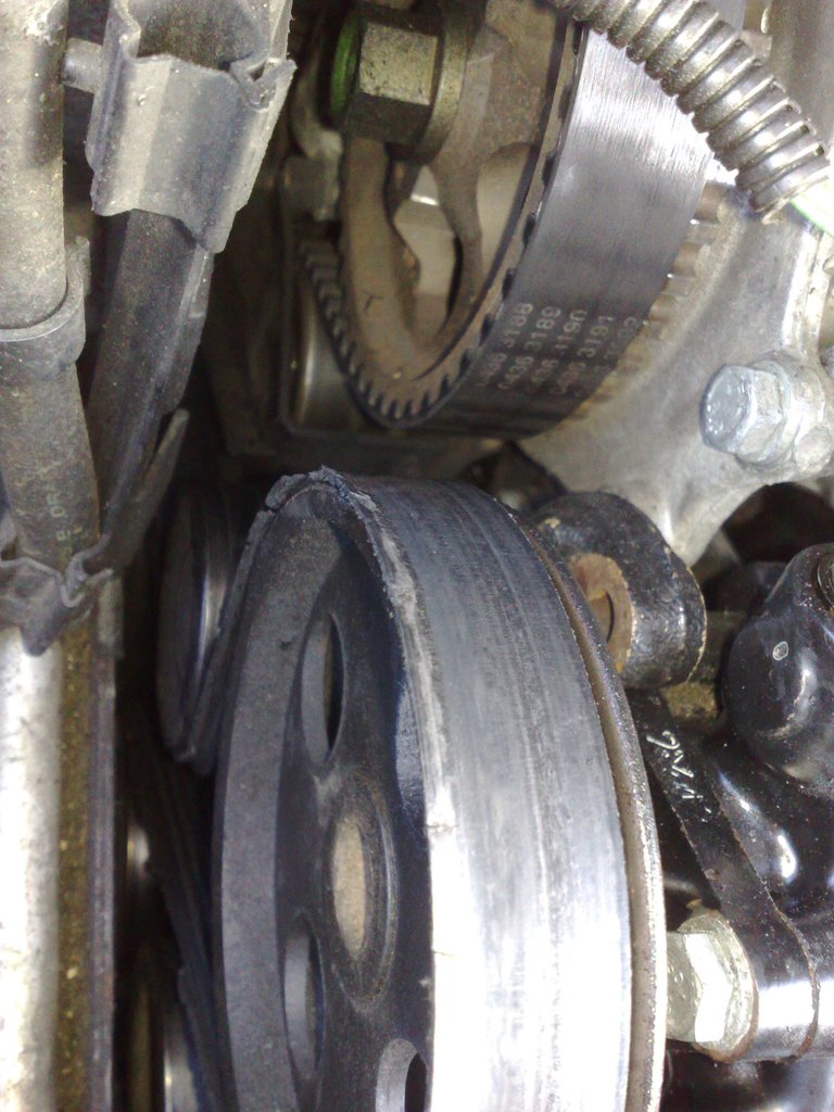

Cam belt - Is it on the edge of the pump sprocket or does it actually overhang? If it overhangs, get those tensioners and water pump replaced ASAP and get a cover for it! If it doesn't overhang, get a cover for it!!!!!
Aux belt - I can't see from the pic if you've got the auto tensioner or the earlier manual one. If it's the auto (ie has a spring behind the hydraulic pump) you need to replace the tensioner and the spring.

Xac wrote:Cam belt - Is it on the edge of the pump sprocket or does it actually overhang? If it overhangs, get those tensioners and water pump replaced ASAP and get a cover for it! If it doesn't overhang, get a cover for it!!!!!
Fuel pump - see that plunger that goes to the trottle arm? Remove it.
Cam belt: On edge, not overhanging. I've got the cover somewhere. Didn't replace cover after repairing the IP ages ago, are you saying replace the cover due to mechanical or safety reasons?
Aux belt: I'll get a picture from the side of the engine to confirm auto tensioner if that's ok? If so, back in a bit with piccy.

Dommo wrote:That silver thing on the right of your red circle (but still in the circle) is the pressure switch, which determines if there's enough gas in the system to allow it to turn on, if theres not enough or too much pressure it cuts the power to the compressor so it wont have been running the whole time. On a phase 1 Xantia the AC button is to the right of the clock, it's the snow flake button.
ahhh, fantastic.
I've got an air con matey, I'll get a vac test done on the system before recharging and testing compressor. Or might test compressor quickly (v short running time) before recharging with gas.
I assume R134a gas?
Wonder where the schrader valves are for testing high/low pressure sides and for refilling? :/

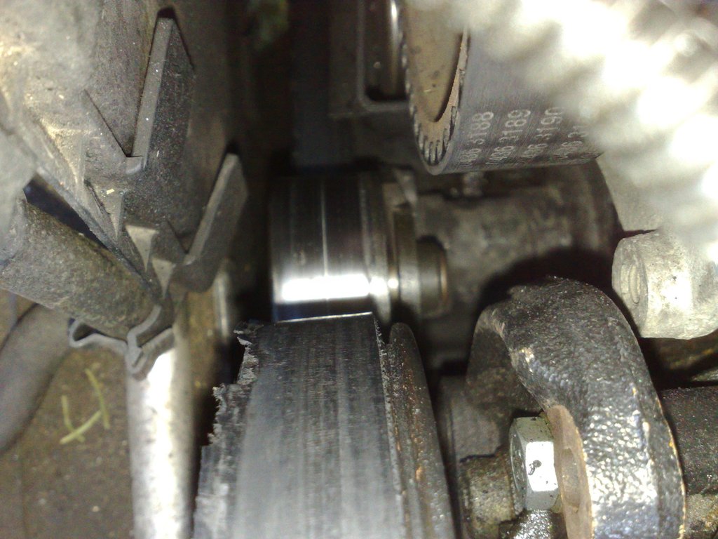

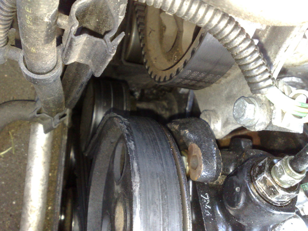

romie
Posts: 451
Joined: 07 May 2010, 14:02
x 2
Re: From this picture, I take it this car has Air Con?
Unread post by romie »
Hey Xac,
Can you see if it's got an auto tensioner from the below pics? I just want to be ready as possible for when I change the belts :s

Looks like manual tensioner to me, so yours is a bit of a mix between the 1.9 and 2.1 pictures in the haynes book.
Get the cam belt cover on to protect it. If the aux belt were to snap or debris get flicked up it'll be staight into your cam belt and if it doesn't snap it, all it takes is for something to get between the belt and a pulley and your timing slips potentially destroying the cam.

Is it my eyes or is that aux belt too wide also, looks as though the outer ridge hangs over the side of the pulley

411514 wrote:Is it my eyes or is that aux belt too wide also, looks as though the outer ridge hangs over the side of the pulley
It's been badly fitted, not enough care taken to get it fully on.
