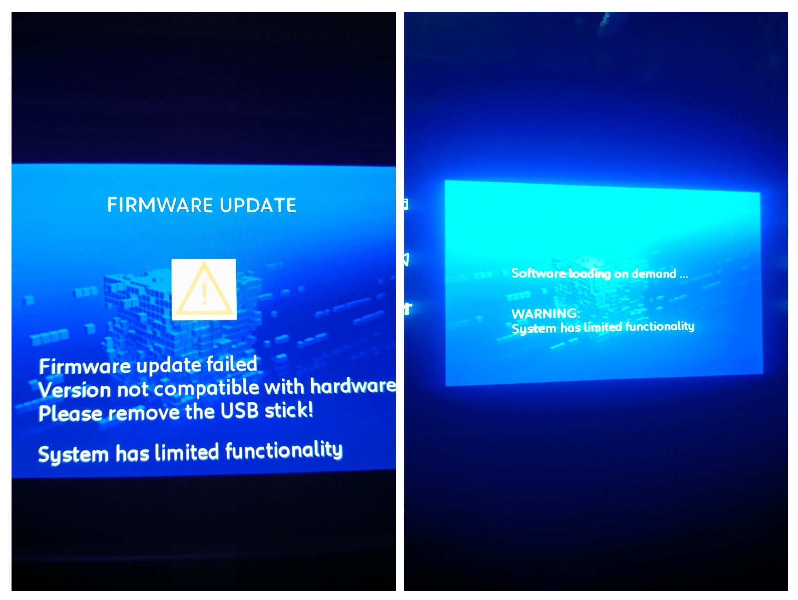

Re: PSA NAC RCC Updates
I think the problem is in the software. what you gave and the key is the same that generates Peugeot update.GiveMeABreak wrote: 10 Nov 2024, 14:34Disconnecting the battery and reconnecting isn't going to work! You need to do a proper BSI Reset / Battery Disconnect / Reconnect Procedurefasi wrote: 08 Nov 2024, 18:21 Hello,
Today I downloaded the screen update via Peugeot Update. The update was installed with the engine turned on and then I got the message: Firmware update failed
Version not compatible with hardware!
Please remove the USB stick!
I downloaded the update from this thread and added my file in the license directory.
4 pendrives and each time after a few seconds the same message.
I have to disconnect the battery before each attempt.
The car does not turn off and the battery discharges.
HELP!
VIN VF3**************[VIN obfuscated, can be read by forum staff]**************[VIN obfuscated, can be read by forum staff]

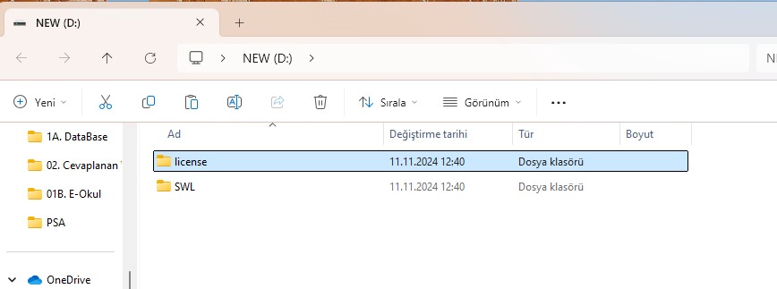

Kakirman
- Posts: 8
- Joined: 10 Nov 2024, 17:18
Below is the content of the USB stick I created with Peugeot Update...GiveMeABreak wrote: 11 Nov 2024, 12:50 I wasn't suggestion YOU personally had done any of the above - these are just general reasons why updates can fail.![]()
No, you cannot use different licence files - these are uniquely generated for both the vehicle and the specific firmware version and are not interchangeable.
As per the BSI reset, removing the '+' terminal when the negative '-' is inaccessible is ok, just be careful to avoid short circuiting.
Post up a picture of your USB folder contents in the route, so I can check to see if there is nothing obviously wrong.
SWL folder contents
There is a numbers folder in the SWL folder contents. Under that folder there are also Certificates folder, Firmware folder, MediaHeader folder and HashList file.
Sincelery...
- x 6963
Ok I can see the problem straight away. You are missing the Updateinfo.xml file from the route of the USB. Without this the system cannot update!

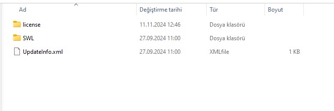

Kakirman
- Posts: 8
In the flash memory that I created in the second manual, I created those files with the latest version of the 7zip program. When I said guide, I made a spare usb stick. I threw the files with Manual 7zip. (without using the Peugeot app)
I did as you said in the sequence in that memory.
1.license
2.SWL
3.Updateinfo.xml
So it's a very interesting situation.
Well, let's add this ubdateinfo file to the flash memory created by the peugeot application, let's try it like that.
Best regards...

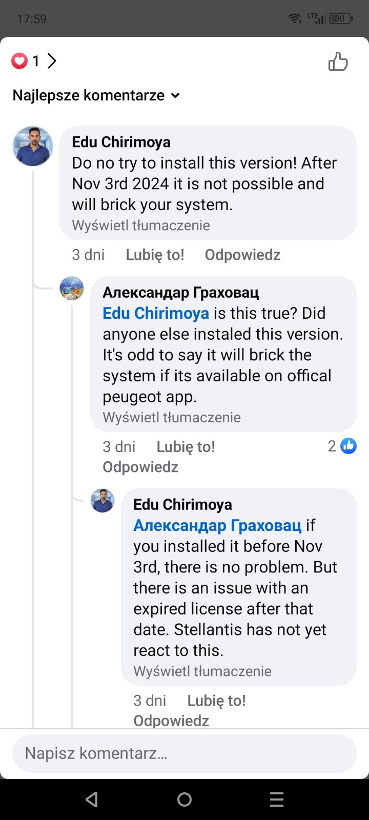

- x 6963
I have this version on my vehicle and have done since 2022 without issue. I can't comment on the above though.
If you're having issues, then you may need to contact your dealer directly if the update is being offered but you are unable to install it.
