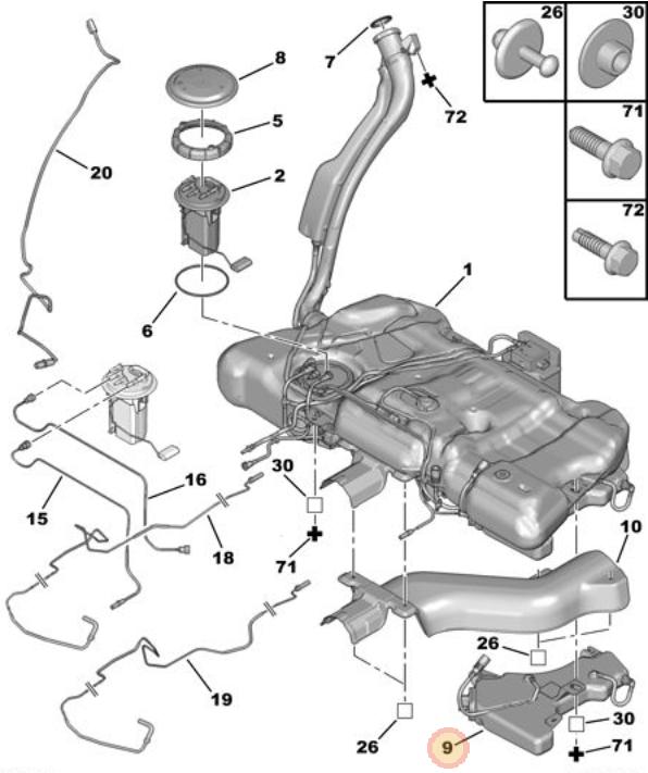

Hi all
I haven't posted on here is absolutely ages - life getting in the way etc. I still have all my previous Citroen's and will get round to updating some of my previous threads at some point. Reason for this post is on Christmas Day I made a rash purchase... An X7 with an eolys fault (P1442 - o/c, intermittent) and I collected it yesterday. nb: I can't even blame alcohol for the rash purchase because I didn't drink a drop on xmas day!
VIN is: VF7**************[VIN obfuscated, can be read by forum staff]
Please could you check and confirm:
The correct additive fluid for this car;
The wiring diagram for the tank pump (so I can check and confirm if it's pump/wiring that's at fault etc.);
The part number for the replacement tank (complete).
Thank you

Hi Iain.
For the C5 X7, it needs a specific Eolys fluid, which is Eolys EXTEND (Black).
(9) PEF Additive Tank, part: 1500NK, £475.73
As for the fault Code:
So there is the possibility of the engine fusebox to consider here.
Diagram for Particle Filter:
With the exception of the wiring codes, most of the component codes are indexed here:
PSA Electrical Diagrams - Wiring & Symbols Codes Index
