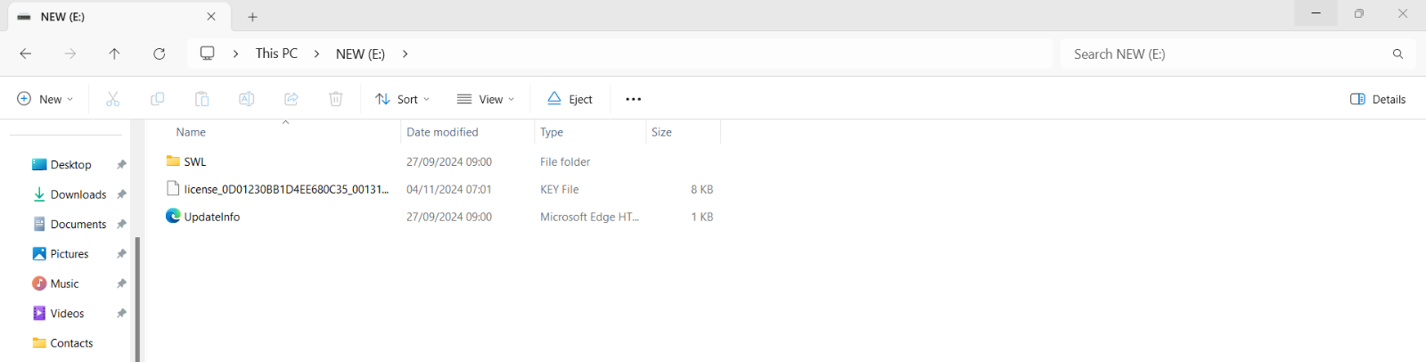

Hi there, same issue for me unfortunately...
I'm trying to update my Citroën C3 Aircross 2018 NAC with the latest 20.08.50.92_NAC-r0 firmware, but unfortunately I'm still having trouble.
Current versions (updated july 2024) :
- NAC : 21.08.87.32_NAC-r1
- Maps : 27.0.0-r0
VIN Number : VF7**************[VIN obfuscated, can be read by forum staff]
The update is marked available on the My Citroën app. I have used the Citroen Update software on Windows to format and load a 32 GB USB stick. Unfortunately I get "No media found" followed by "Version is not compatible with hardware". I have tried the following :
- Re-format USB stick with default allocation unit size instead of 16 kB
- Remove the license folder and connect the NAC to WiFi via phone Access Point to grab license OTA
- In this case, I don't get any "not compatible" error, but nothing happens
- Copy the files from links provided by GiveMeABreak for other users (which I understand is not recommended) - didn't change anything of course
- Poke into the menu for software versions, and into available updates (list is empty), to try and trigger an update message.
Here's what the file/folder structure looks like on the USB stick. Any ideas of what I could try ?
Thanks !

- x 6963
Re: PSA NAC RCC Updates
So don't expect it to work with somebody else's licence file if this is what you have done, as they are unique for the intended vehicle.
Firmware Version 21.08.90.52_NAC-r0
TheMitten Licence File
Instructions for Updating NAC or RCC Firmware, Maps & Licences
The 'No Media Detected' message is perfectly normal as when you first insert a USB, it looks for MP3 files or other media, so just wait for this message to disappear then it will detect the update.
If you are still unsuccessful, this can be because of previously failed update attempts and the system can get 'stuck'. So in this case, follow the BSI Reset / Battery Disconnect / Reconnect Procedure and leave the vehicle for a good 10 minutes or so to ensure the NAC unit totally powers down. Remember to follow the guidance and DO NOT open any doors or press any switches whilst waiting for the time period before disconnecting the battery, otherwise the networks will re-awaken, defeating the purpose.
