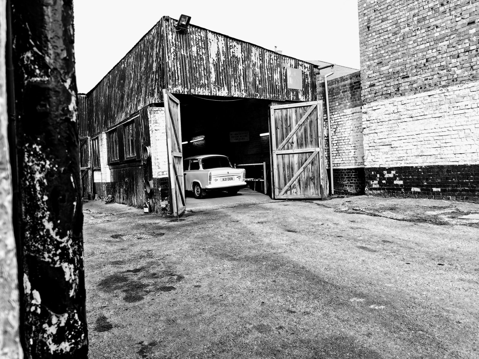

MattBLancs wrote: 24 Mar 2024, 08:52 As well as good candidate for the "lovely old garages" thread (think already featured previously) is also a good "period correct" match between car and old shed.

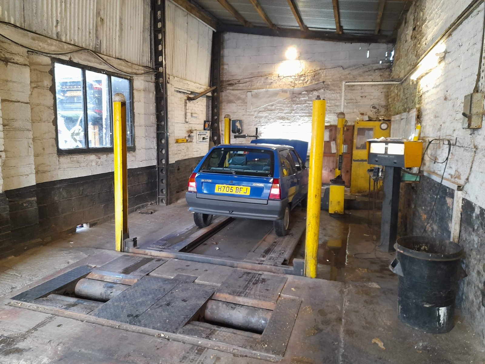

Here (via a bit of artistic licence/ my phone's "filters" ) is the car in for inspection at the height of the cold war:
:-D
Nice work Matt "Garages Gallery Ancient and Modern" has indeed featured the "Two Wrestlers" but has no barrier to repetition or images new and old to put before the class of March 2024.
Here's Citrojims former white AX up on the Wrestler's lift.
viewtopic.php?p=672605&hilit=wrestlers#p672605

I have one of Bluebell, my blue AX, up on the lift too. On her first MoT in my care...

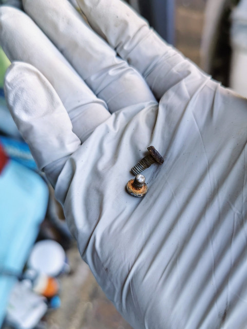

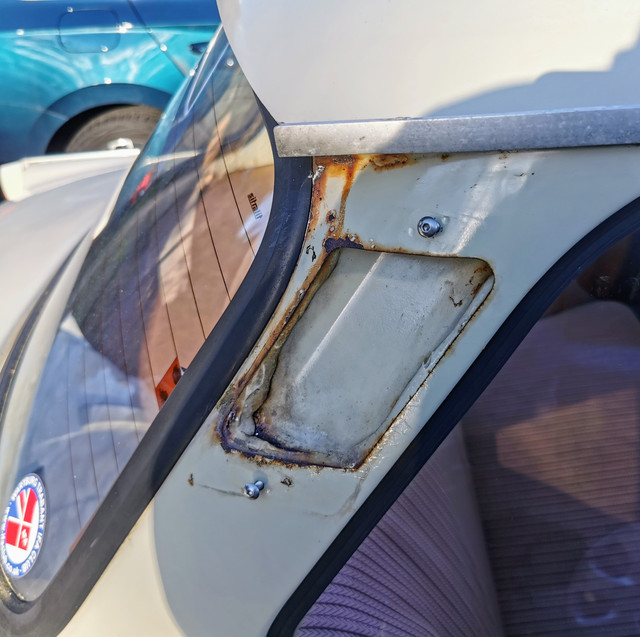

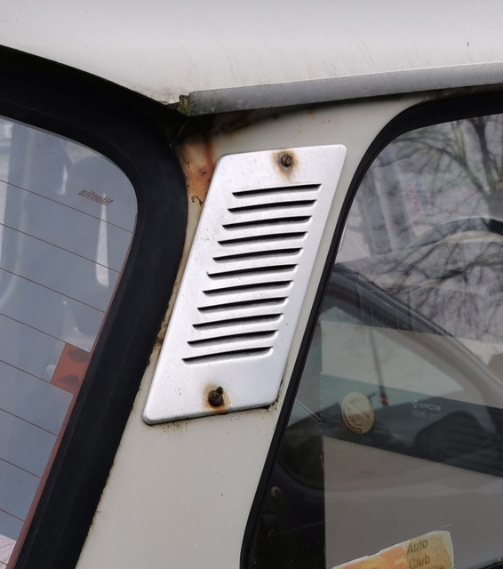

Following the irritatingly erratic weather on Saturday it was lovely on Sunday. However my body decided that lumbering with me with a headache threatening to turn in to a full on migraine for a good chunk of the day was a great idea so my productivity was rather limited.

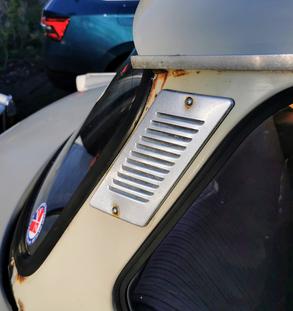

In the quest to get some of the grime and rust streaking off the Trabant, I really wanted to get these covers off the rear pillar vents. I wanted these off to look behind them anyway as I wasn't in any way convinced that these weren't in some way responsible for our water ingress issues.
Surprisingly the first screw actually came out without progress, the second however snapped pretty much as soon as I looked at it.
I wasn't planning on reusing these anyway, so it was just drilled out and re-tapped to take an M5 A2 stainless machine screw instead. With a bit of grease applied to the thread for good measure.
I'm not at all convinced this isn't a point of water ingress.
The seam sealer which attaches the inner section there feels like it's gone brittle just like the stuff on the front bulkhead had, so I'll be giving that a good slathering with some PU sealant when I've got a bit more time and working brain available.
There's a good couple of millimetre gap behind these grills and the surrounding metalwork (there's actually a spacer in there to ensure they do NOT sit flush), so basically all the water running down off the roof is going to run behind the grill and into the chamber rather than being deflected over it as you'd think to look at it. I reckon that putting a seal around the top and sides of the panel might be a decent idea. That way water will largely be kept out of this area.
At least I know I can easily get in here again in future.
Need to get a bit more elbow grease involved in removing that rust staining.
Do have some slight nervousness regarding what the top of that screen surround will be in once the screen is removed. We know that needs to happen as I know the offside lower corner of the surround is holed and the screen needs to come out to fix that. Sure that will be an interesting day. That will likely not be done by me, by the way. That will be entrusted to someone who knows how to fix this sort of tinworm damage.

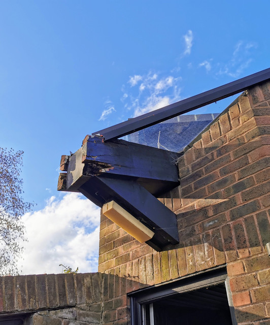

In other fun house news, it appears that the company who did a load of work on our roof has vanished into the sunset. Their phone numbers all go straight to voicemail, and their email addresses all bounce. Basically every Google review for the last six months is a one star one saying "These guys never turn up, don't touch them." Aside from one reviewer saying they're having to take legal action against the company to get issues resolved.
Great. I'm trying to get in touch with them to get a couple of things which didn't survive the winter sorted. Relatively minor in the grand scheme of things, but indicative that they'd done a shoddy job of fitting the final trims and such. Which gives me little confidence in what I *can't* see. So much for the ten year warranty.
Also means I now need to find someone *else* to come and sort this mess out.

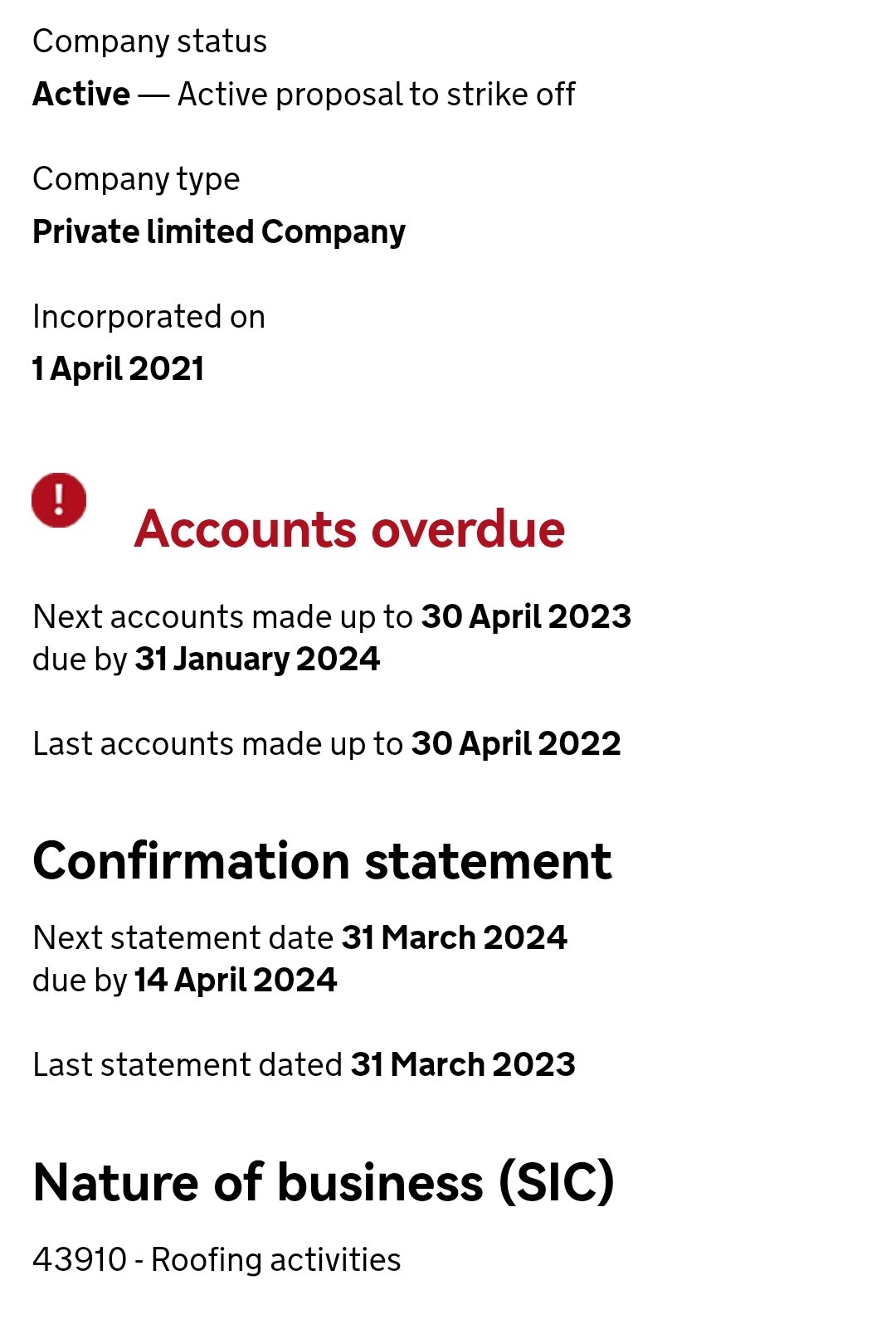

myglaren wrote: 27 Mar 2024, 19:01 Can you trace them through Companies House?
Yes. Though that doesn't help my confidence.
Companies House basically haven't heard from them since April 2022 if I'm reading that right.
Incorporated in 2021 doesn't exactly match the "Family run company for the last 20 years" claim on their marketing materials either...
To be honest, knowing their registered address (which matches what's on their still active website) doesn't really gain me much. Based on the quality of the work that's failed and the last 6 months of reviews on Google, I'm honestly not sure I'd want them to be coming back to do remedial work anyway.
I guess in theory we could get remedial works done as necessary and then push a claim against them through the small claims court - but knowing this type they'd declare themselves bankrupt and wind up the company if they lost anyway so we'd be right back at square one, probably another year down the line and with a legal bill we're left to foot.

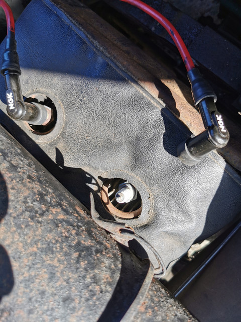

The Trabant has never been particularly fond of idling smoothly (even by two stroke standards), but it was definitely better after changing the blown head gasket. Today I had the thought of using an IR thermometer to compare the two jugs to see whether both cylinders were properly contributing. Imagine my surprise when I pointed it at cylinder number 2 and realised that the spark plug was moving.
Yep, it wasn't even finger tight and I was able to turn it about two turns tighter by hand. With that tightened up the idle seemed to be a good bit better, though I've not actually done a test drive to get it properly back up to temperature since. Wish all fixes were this easy.

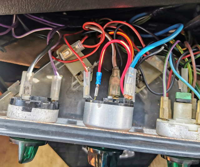

I knew something was up with either the headlight switch, circuit or way the switch was hooked up. This was because as soon as you clicked the switch to the first notch, which should be side lights, you got side and headlights - exactly the same as when set to the correct headlight position.
Yes, that would do it.
With this jumper wire removed everything appears to work normally. Though I'm guessing the switch has proven to be intermittent in the headlight position once warmed up. Can't see any other reason you would do this.
I've removed it for now (not least because the gauge of wire isn't even close to being up to the job) and will investigate further at a future date.

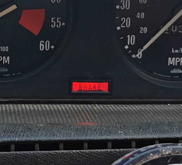

I had also wanted to have a look at seeing if I could sort the handbrake switch as currently the brake warning light on the dash only comes on via the float switch on the reservoir, and it should also work when the handbrake is on. I know the lamp itself does work as I've tested it.
However I failed at the first hurdle - how to get into the centre console far enough to find the switch. I'll need to consult a manual to confirm where the fixings are so I can get it apart without breaking any bits of brittle, near 50 year old plastic.
