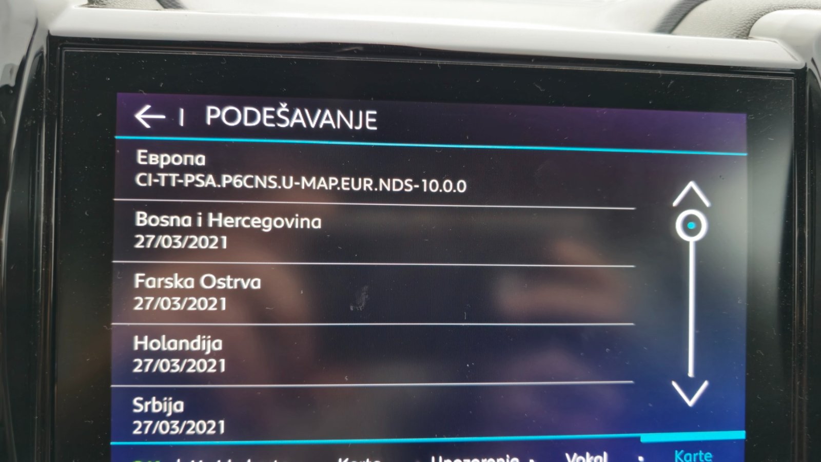

Ok it looks like im already on this sw version with the latest update from Citroen ( see atached)
Wither way i have downloaded both and ill try with the updates and update as soon as i finish :)

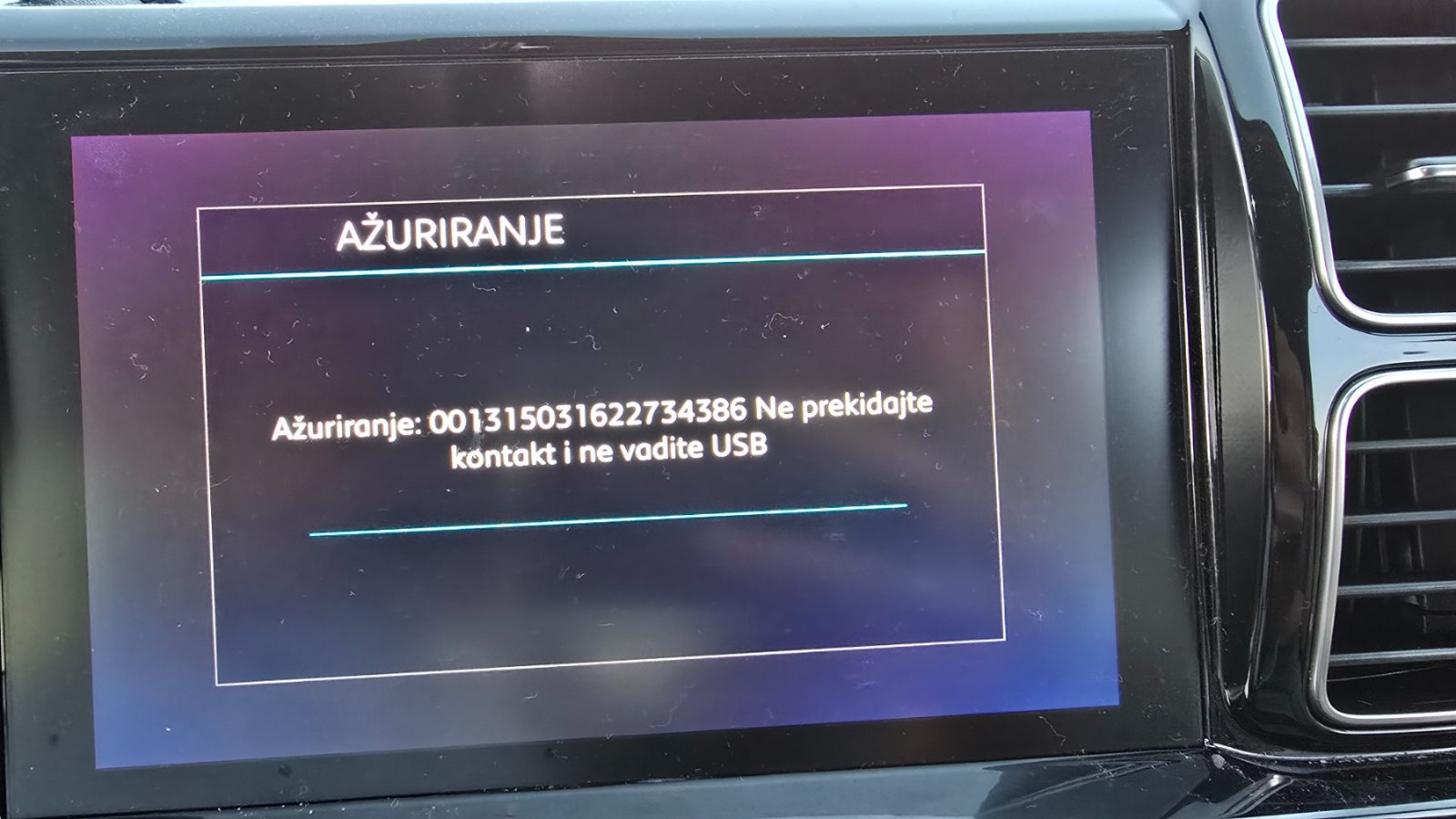

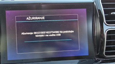

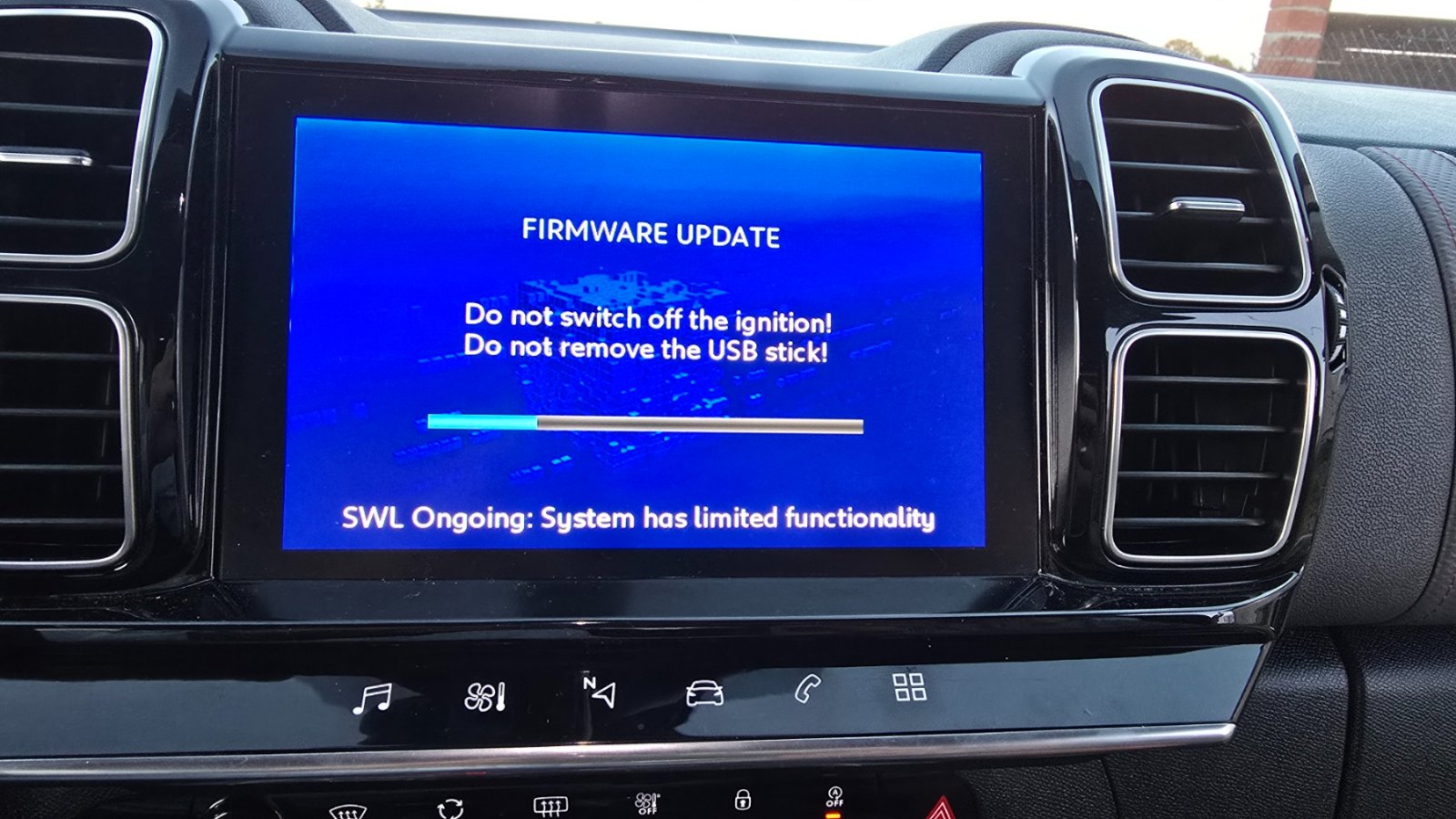

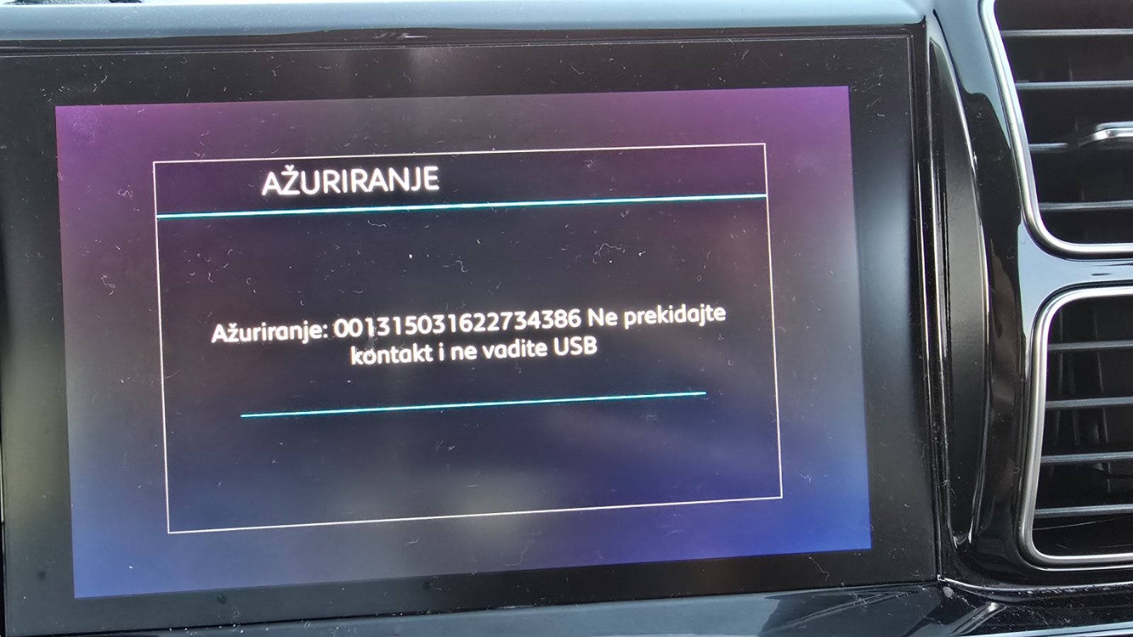

Hi, me again :)
I've downloaded swf from the link and updated car but maps wont updated - it says unsupported hardware.
I didn't missed any step, tried with the 3 different usb drivers and still the same error.
maps are still v10. and swf is now from the link 42.03.33.42_nac-r0
any thought on that ?

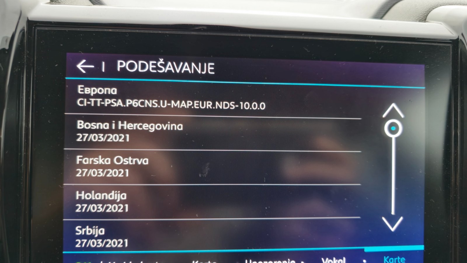

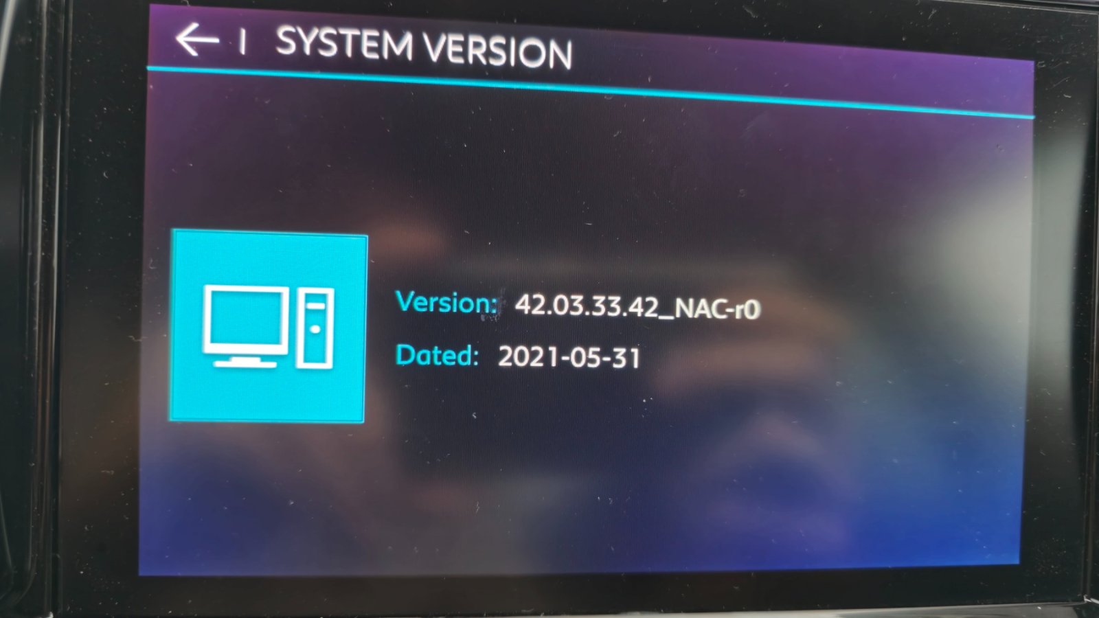

Just to be sure, my current version is wave3 or wave4 (SYSTEM VERSION
Version: 42.03.33.42_NAC-r0
Dated: 2021-05-31 )
Do I need to go up with system version or just to try these maps v16 again on the current system.
From the link in the first post you provided, system update done,maps v16 update failed.
I hope I didn't create confusion in previous post.
And I really appreciate your support and effort to help me with this.
x 6945
Re: PSA NAC RCC Updates
It's possible. If you've tried the map update from the link again that I posted above and it still won't accept it (and you are 100% sure you have formatted the USB again in FAT32 using a PC not a MAC), then it may require a later firmware. If you can't update it further with the same message, then perform a BSI Reset / Battery Disconnect / Reconnect Procedure and make sure you leave the interval before battery reconnection for at least 10-20 minutes to allow sufficient time for the Head unit to fully power off.

GiveMeABreak wrote: 12 Oct 2024, 15:54 It's possible. If you've tried the map update from the link again that I posted above and it still won't accept it (and you are 100% sure you have formatted the USB again in FAT32 using a PC not a MAC), then it may require a later firmware. If you can't update it further with the same message, then perform a BSI Reset / Battery Disconnect / Reconnect Procedure and make sure you leave the interval before battery reconnection for at least 10-20 minutes to allow sufficient time for the Head unit to fully power off.
I have a good news, so after disconnecting battery unit for 30 min and cooling down, map v16 went trough without reformatting usb.
Looks like system was stuck with reading usb after system update although i did reboot it and drove car all afternoon. ( im IT so yes that part with formatting and preparing usb is not an issue)
I really appreciate all the work and links you provided, maps and system are up to date and I can continue with traveling around Europe :)

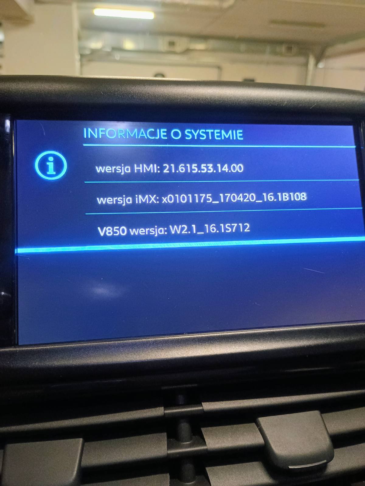

Hello :-)
I carfefully read the subject, and i found that to update my RCC ifrom 2016 installed to my 2014 2008 i need to have a licence/certificate key.
My VIN is VF3**************[VIN obfuscated, can be read by forum staff]
Thanks in advance and best regards from poland.

Sorry you don’t have an RCC system, you are way too early for RCC. You have a SMEG system and I don’t support these.
Posts: 9377
Joined: 07 May 2009, 16:24
x 1938
Unread post by Paul-R »
He says he installed it from a 2016 car. Does that make a difference? None of the information in the picture looks like SMEG to me.
