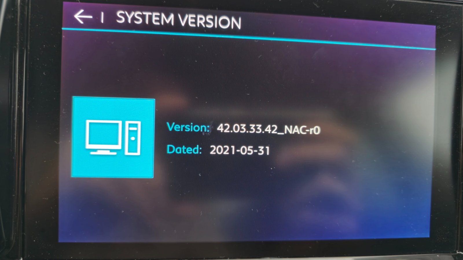

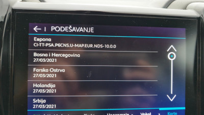

Could someone elaborate me my version of software and maps plus what type of navigation my car has.
I've been able to upload latest firmware via windows Citroen download apk (aprox 24gb) and no other updates are available. (maps and firmware we updated from 31.09.46.62_NACr-0 and maps were CI-TT-PSA.P4CNS.U-MAP.EUR.NDS-6.3.0 )
Is it possible that there are no more map updates or ability to download latest maps from 2024 in any way??
Car info :
C5 Aircross 2019
System version : 42.03.33.42_NAC-r0
Map Version : not showing ( from maps menu > CI-TT-PSA.P6CNS.U-MAP.EUR.NDS-10.0.0 ) 27.3.2021
Car info :
C5 Aircross 2019

So note that from factory you had a Wave 3 unit. There is a 'bridging Firmware' that converts this to Wave 4 and this is where a lot of systems have problems, because the bridging firmware contains both a combined firmware and map update in one.
So below is the firmware and Map combination, and the licence file underneath.
Separately I have included the Map V12 as a standalone update.
Firmware V42.03.33.42_NAC-r0
Licence File
Map Version 12
Instructions for Updating NAC or RCC Firmware, Maps & Licences
Licence File
Map Version 12

GiveMeABreak wrote: 06 Oct 2024, 09:56 So note that from factory you had a Wave 3 unit. There is a 'bridging Firmware' that converts this to Wave 4 and this is where a lot of systems have problems, because the bridging firmware contains both a combined firmware and map update in one.
Licence File
Map Version 12
Ok it looks like im already on this sw version with the latest update from Citroen ( see atached)
Wither way i have downloaded both and ill try with the updates and update as soon as i finish
PS: what is the name of the navi system used here?
I saw some DS7 using same map packs is that good or bad ??
Thanks for the help and links.... updates on the way
