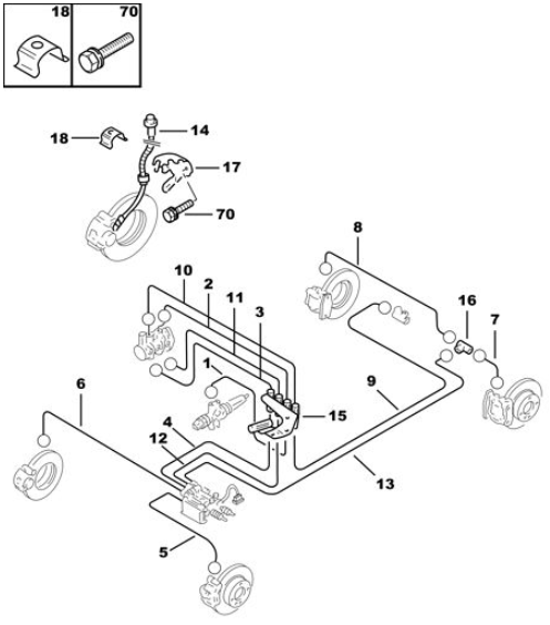

GiveMeABreak wrote: 07 Aug 2022, 10:01 Hi Chris
Not sure which pipe you want so here are the ABS pipes. Let me know which one you need the part for:
Brake Piping
I think the only rubber hose to the ABS block is the return hose to the LHM reservoir. It would be on the return lines diagram, probably part of a complex harness.

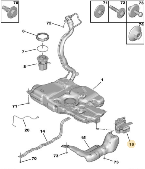

Hi to all,
I need info about Eolys Powerflex refill procedure. I cannot find on internet accurate information, is it pouch or tank. I plan to buy refill kit but I am not sure what option is the most recomended.
Eolys content: 1080ml
Thanx!
Brake Piping
Thanks, I did suspect that. I'll get a pic tomorrow.
Yes its part of the Octopus. Are they the same for all Xantia? The pipe last split 2 years ago, I've managed to shorten and reattach it, but I think this might be the last time due to its length.

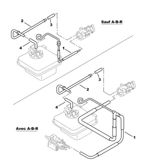

c.morewood wrote: 07 Aug 2022, 22:43 Thanks, I did suspect that. I'll get a pic tomorrow.
I was originally going to post this, but kept to the ABS!
Let me know which one you need the part number for.

Your vehicle has a reservoir, not a pouch, so you need a refill kit. It uses Powerflex additive and is gravity fed. Don't forget you will need to reset the additive counter using professional level diagnostics like Diagbox after you have filled it, otherwise the engine ECU will not know you have refilled it.
The tank is located at item (16):

GiveMeABreak wrote: 08 Aug 2022, 12:37
No1 please Marc. I believe that is the return from the ABS at the bottom.
Thank you,

x 6950
Ok so item (1) part: 5270R6, (no longer available) Chris....
... but have a look here:

Unread post by pejcicbozidar »
GiveMeABreak wrote: 08 Aug 2022, 12:44 Your vehicle has a reservoir, not a pouch, so you need a refill kit. It uses Powerflex additive and is gravity fed. Don't forget you will need to reset the additive counter using professional level diagnostics like Diagbox after you have filled it, otherwise the engine ECU will not know you have refilled it.
Thank you very much, Marc!
It will be no problem with DiagBox.
Regards,

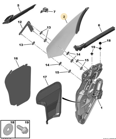

Hi marc, do you have parts numbers for the rear ns passenger rear window plus diagram 206cc mines getting a little stuck when the window comes up , i think there's a spring missing on a part that holds the window to the mechanism vin number is
VF3**************[VIN obfuscated, can be read by forum staff] many thanks
:-D
x 6950
Rear Quarter Glass
9203FN (Left)
9204J0 (Right)
Both no longer available from Peugeot.
Any other 'bits' you need part numbers for let me know.
