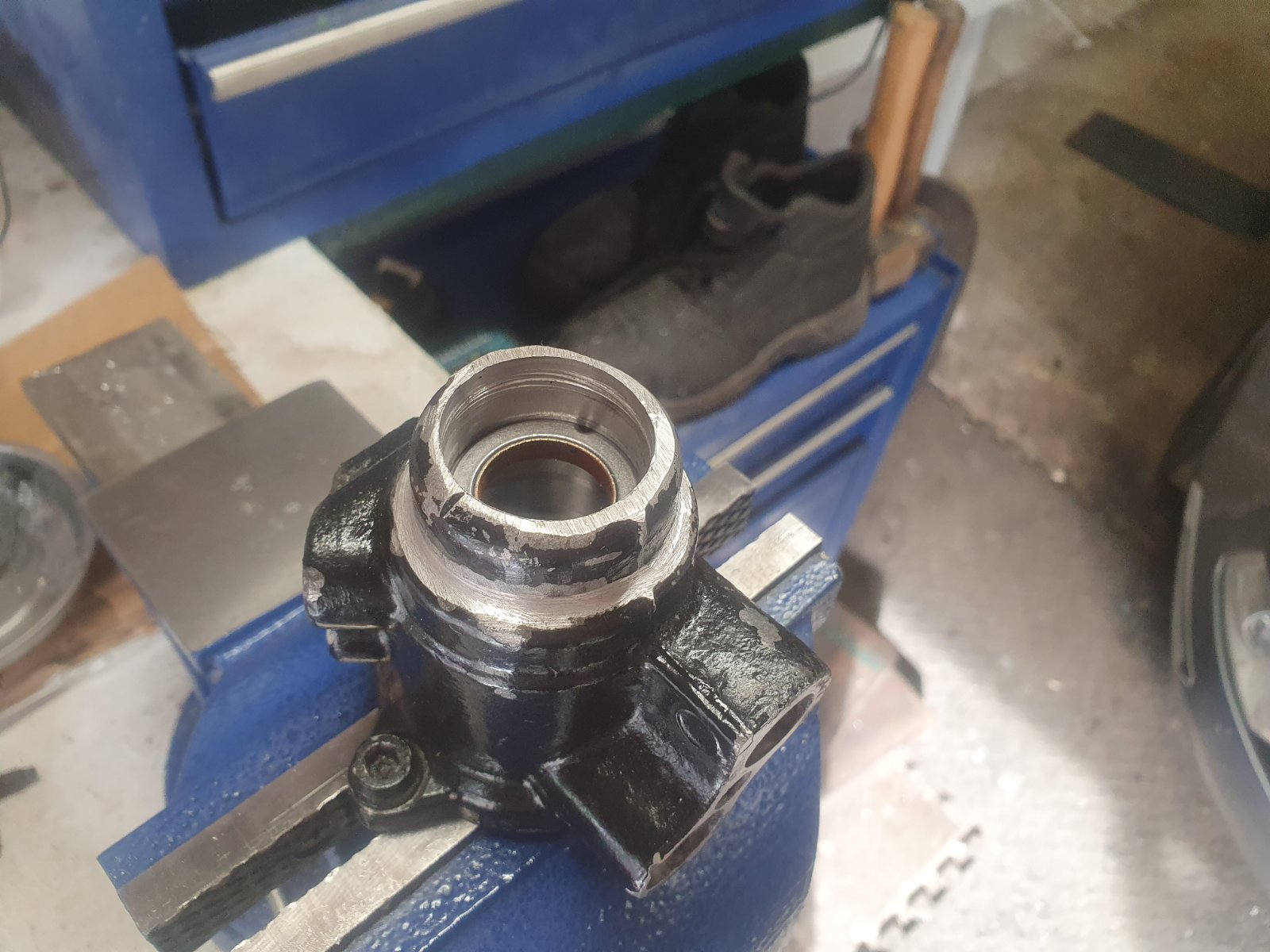

this is wildaerodynamica wrote: 08 Mar 2025, 13:39 Hopefully there's not something I've missed because I've gone ahead and got medieval on the housing.
The block chopped off, 25mm hole now 30mm, a bit of a groove to the outside to help a rubber gaiter stay attached, a circlip groove cut in the new 30mm bore for a circlip that I don't have yet..
Pic shows it now and the metal ring now fitted back in.
i wonder if it will work for you

Re: C5x7 3rd time steering leaking
the bronze ring is the bearing
From the inside of the housing, the Simering is pressed in,
then the ring is pressed in - the bearing
everything is pressed with a tool to the required depth
if you leave out the bearing ring, it will be bad.
the shaft is inserted into the housing and it's done

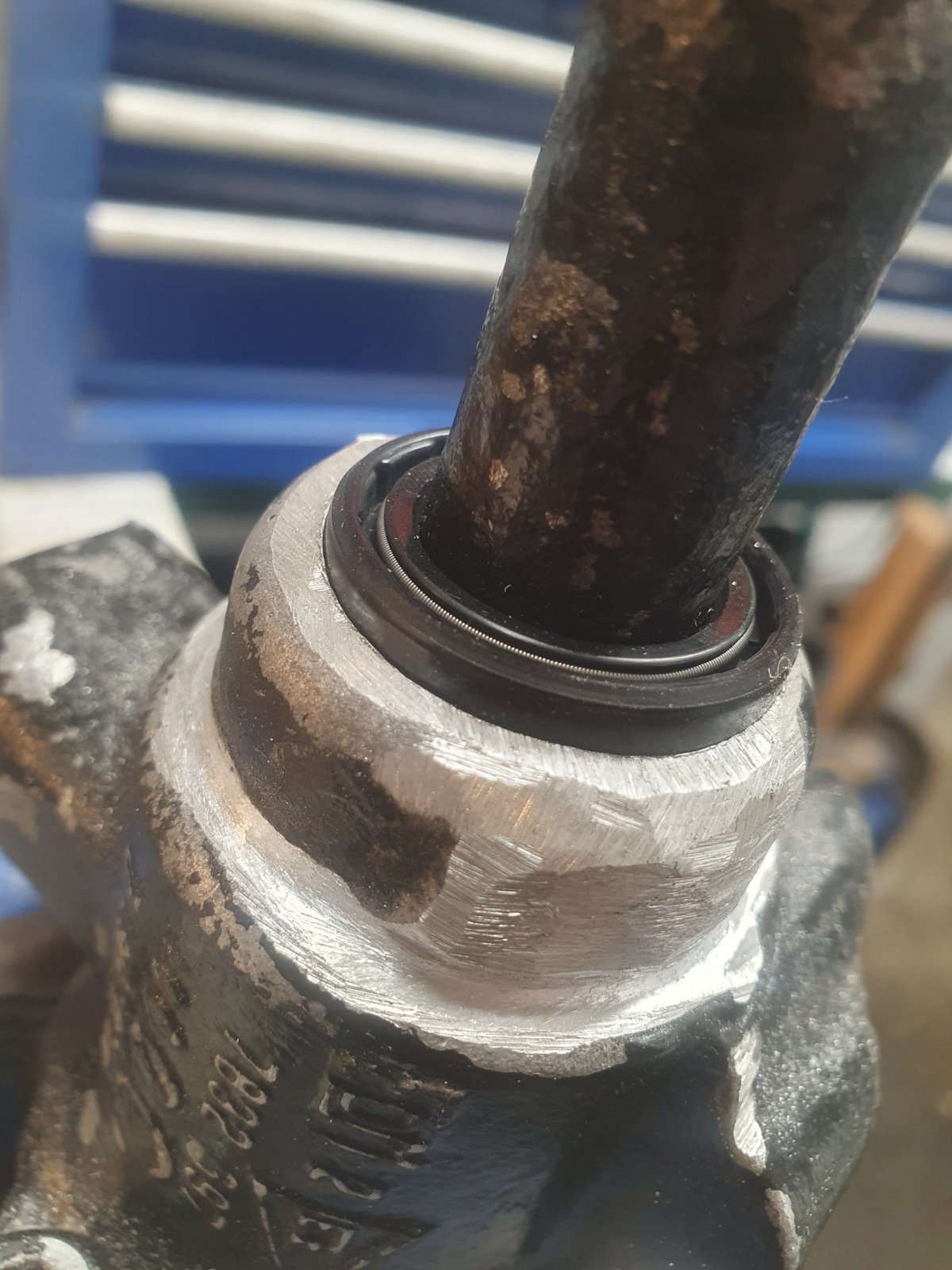

Are the seals double lipped? If not they seem to be the wrong way round. The lip/spring side should be on the oily side. I realise they're not fitted yet and may just be placed for a photo but after the great work that you're doing it would be a bugger to say the least.
I think this seal is intended as a cover sleevemoizeau wrote: 09 Mar 2025, 09:05Are the seals double lipped? If not they seem to be the wrong way round. The lip/spring side should be on the oily side. I realise they're not fitted yet and may just be placed for a photo but after the great work that you're doing it would be a bugger to say the least.
The oil seal is under this
I'm glad you're saying that because I actually was going to put them in this way. The one that came out was that way and the ones I saw elsewhere were also that way round.moizeau wrote: 09 Mar 2025, 09:05Are the seals double lipped? If not they seem to be the wrong way round. The lip/spring side should be on the oily side. I realise they're not fitted yet and may just be placed for a photo but after the great work that you're doing it would be a bugger to say the least.
Incidentally the refurb rack only had 1 seal fitted and the top seal was missing. This had allowed the seal to drift upwards.
I think I'll turn the seal to the orientation you suggest
I think so, the final fitting will take account. These are single lip oil seals and I hope the sleeve works well with them.PATaMAT wrote: 09 Mar 2025, 10:07I think this seal is intended as a cover sleevemoizeau wrote: 09 Mar 2025, 09:05Are the seals double lipped? If not they seem to be the wrong way round. The lip/spring side should be on the oily side. I realise they're not fitted yet and may just be placed for a photo but after the great work that you're doing it would be a bugger to say the least.
The oil seal is under this![]()
Incidentally, do you still have a C5 and has your original work from 2017 lasted?

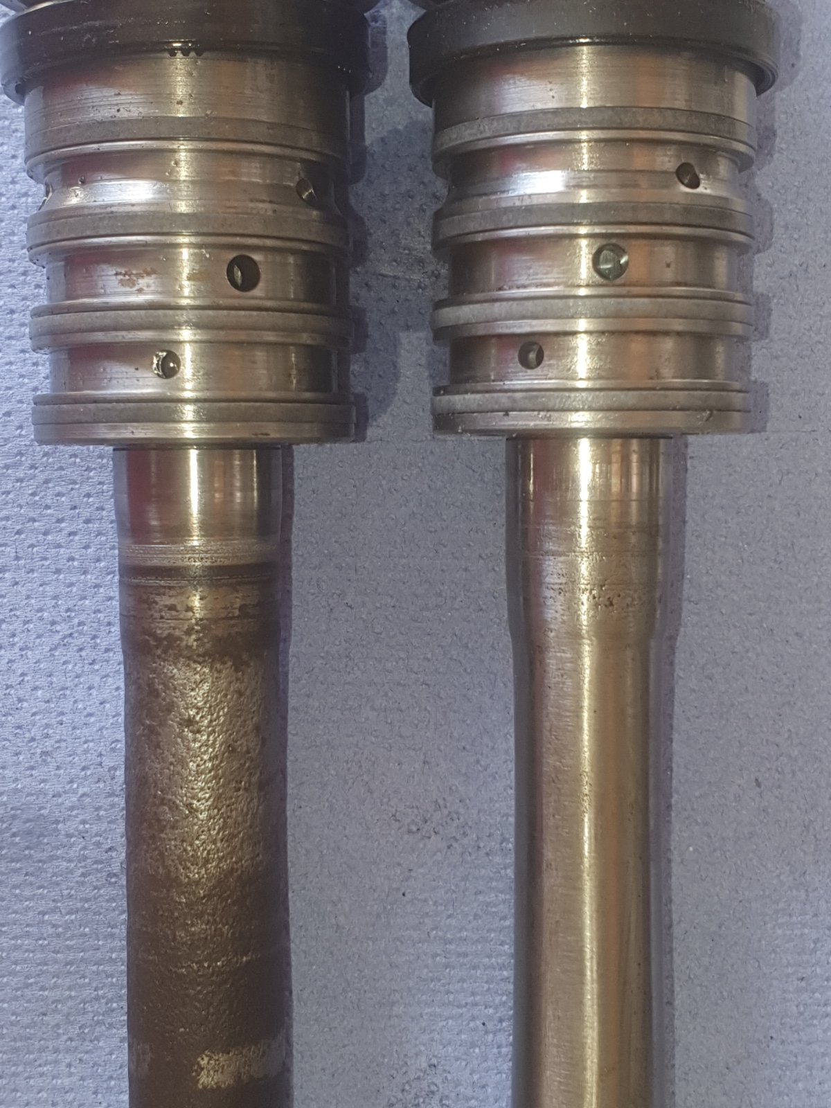

Hi Matt, that was the plan but having carried out the work I found that the pinion valve/ shaft that has come off the car is identical to the one from The rack Stu sent. In fact the one fro. The car that is leaking is so badly damaged that it has deep scores that look difficult to fix.MattBLancs wrote: 10 Mar 2025, 08:18Well, you could end up with an LDS puddle, but we are starting at that point, so the only way is up!![]()
Agree with your thinking aloud below, I'm sure it's controlled by the rack rather than the pinion. I think I'd be keen to get this done and fitted, if it becomes possible to "turn the wheels too far" I'd think it was perfectly "liveable" in that state. Repeated the job on the rack / pinion you take off could then be optional / done at your leisure.
One on the left is the leaking one off the car. Ot has a groove worn in it. No wonder it was gushing out. It measured at something like 19.2mm at the worn part..
