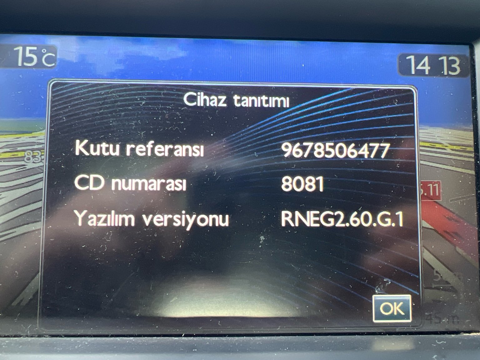

sametcakal
- Posts: 1
- Joined: 08 Feb 2026, 14:39
Re: RNEG Firmware or Software
Harita güncelleyece?im. Yaz?l?m yükseltmeme gerek var m? yükseltsem ses sorunu ya?arm?y?m.
I'm going to update the map. Do I need to upgrade the software? If I do, will I experience sound issues?
Only update 2.77 or 2.80 is the current best advice.sametcakal wrote: 08 Feb 2026, 14:42 Harita güncelleyece?im. Yaz?l?m yükseltmeme gerek var m? yükseltsem ses sorunu ya?arm?y?m.
