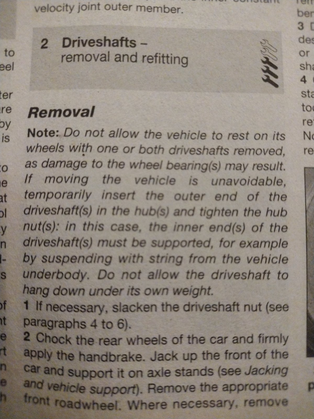

An update on this, not actually as per thread title "Saxo wheel bearing" but (206) wheel bearing news all the same.
Having again got a wobbly wheel I formed a hypothesis:
Assuming hub not distorted, and I may be wrong assuming that, but will keep that assumption at present.
If CV joint was incorrectly formed then is potential a tightened hub nut would not clamp the bearing inner races with the correct force, or perhaps to the correct area.
This side has had a new CV joint in my custody and has had multiple wheel bearing replacements since.
So, having found a very cheap CV joint I've set to with replacement.
Points of note thus far:
  • Inner CV boot is not split, but early stages of perishing. Will order one and do it in the spring.
  • New and old CV joints (gsp from GSF; and J&R bought direct on eBay, respectively) do seem a little different (will make a template to compare contact areas)
  • slight play present in the J&R joint - attempt to twist the joint / driveshaft how it would under engine power and can feel a tight movement. Red flag - don't believe any play like this is normal. So worth a joint change anyway. In all other respects joint seems healthy
Outer boot is in good order, so will reuse that in this instance. Is a new one in the kit but will keep that as a spare.
Posts: 55216
x 8462
Re: Saxo wheel bearing
Good thinking Matt :) I'm watching with interest...
It's certainly possible and there is a big warning once issued for (I think) Xantias that stated the cart should never be rolled on its wheels with no driveshafts fitted as the wheel bearing would be destroyed...

CitroJim wrote: 30 Dec 2022, 17:32 Good thinking Matt :) I'm watching with interest...
Very familiar message - am pretty sure it's in every Haynes (that I've read) not to do that.
Here's the 206 manual (3757)
