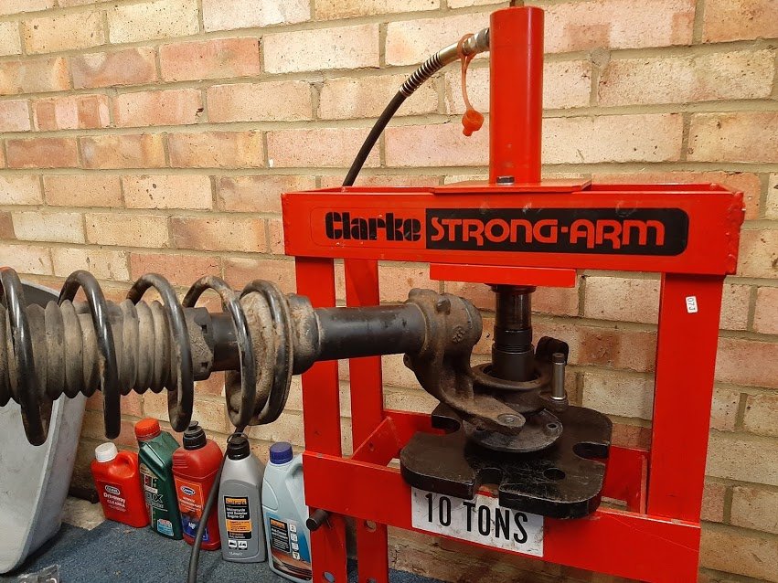

Wheel bearings are easily damaged when being installed in their hubs and hammering is a sure way to damage them. So is pressing on their inner races to install them. You must only ever press on their outer races and when pressing in the front axle - the one that has the brake disc and wheel mounting flange - you must firstly freeze the axle to make it shrink a little so that it can slide in a little easier and then press in as shown in the picture below...
This is an AX strut and hub but the Saxo is very similar...
