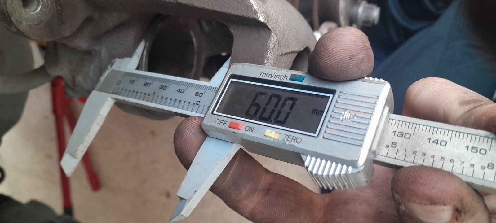

So today i removes both front wheels, the rotor tracks straight even the hub and the only thing i can find is that the caliper of the dragging side has the 'ears' wider than the other side. The non sticking side is 17mm and the dragging side is at 18.5mm! This will cause sticking am i right?

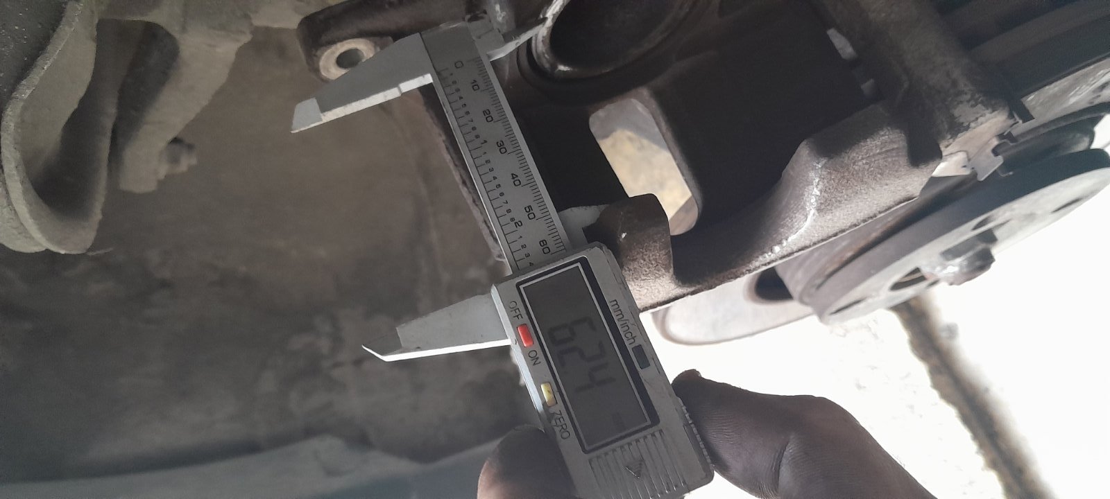

According to the measuring tool 2.4mm difference! No wonder the pads wont go in when new

Surprisingly large difference between those two - are there any part numbers visible as wondering if one is right part and the other "similar but wrong"
Sorry I lost on the 17 Vs 18.5mm ears - can you take another picture please?

By ears i mean the thickness of the two outer parts that grab the outer pad. I ground the opposite part of the caliper piston so that it is roughly the same size as the other side and the wheel was not dragging as much but turns out there is another issue, i think this caliper either was damaged in an accident or something, when i fully tighten the two bolts securing the caliper it starts to drag. Only choice is to leave one of the bolts slightly loose. I will try to find a replacement caliper

Thanks for clarifying, I wouldn't worry about thickness of those bits, only the gap between them and piston (as you previously measured) - casting by different manufacturers could vary this without ill effects, it's only the gap for pad-disk-pad that is important.
