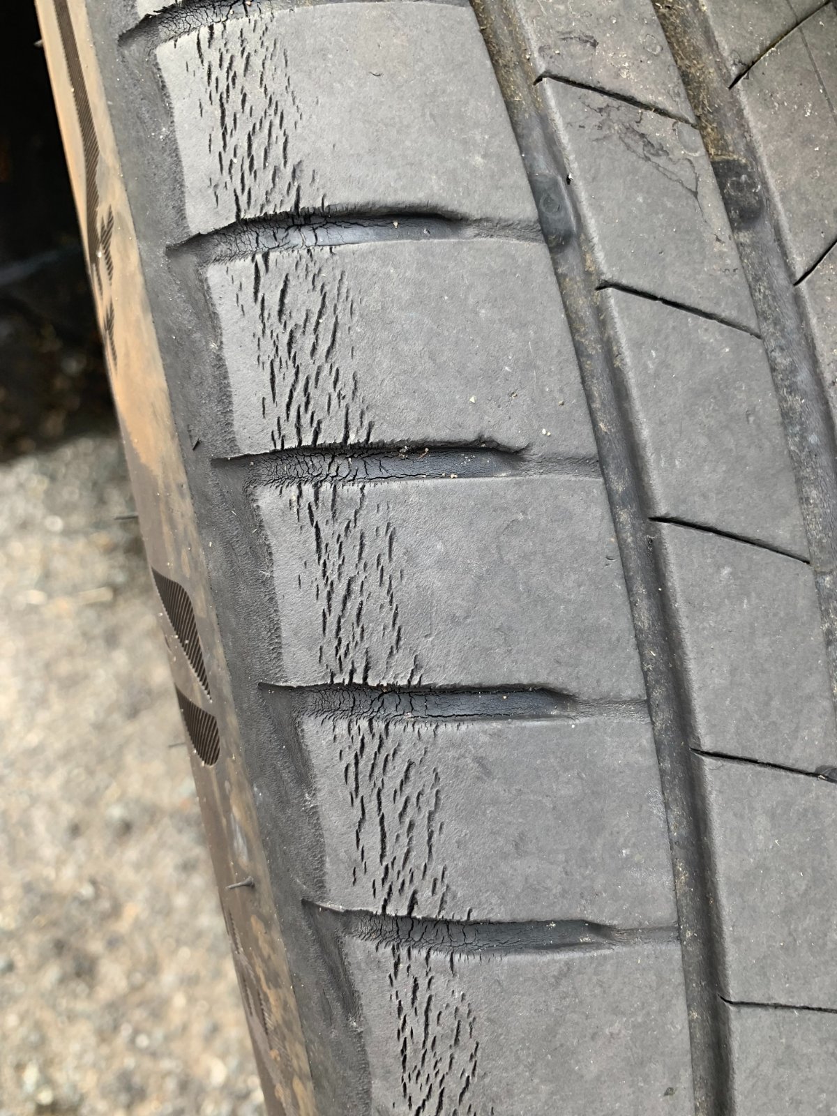

Marc has ditched these year old tyres, and had a decent rant about them!
as posted in his blog here
viewtopic.php?p=692585#p692585

I've re-attached the image Neil so people can click to zoom it - and I've just noticed that if you zoom the image, you can see that the crumbling rubber is also inside the outer grooves, so has to be bad rubber or a defect during the manufacturing by the looks of things.
And whilst I'm at it, I've just fired off a complaint to Bridgestone customer services. I may temporarily keep the tyres when they change them on Friday in case Bridgestone want them. If not, as I've already paid the environmental disposal cost for the tyres, I'll ask if I can take them back for them to dispose of pending the outcome from Bridgestone..
