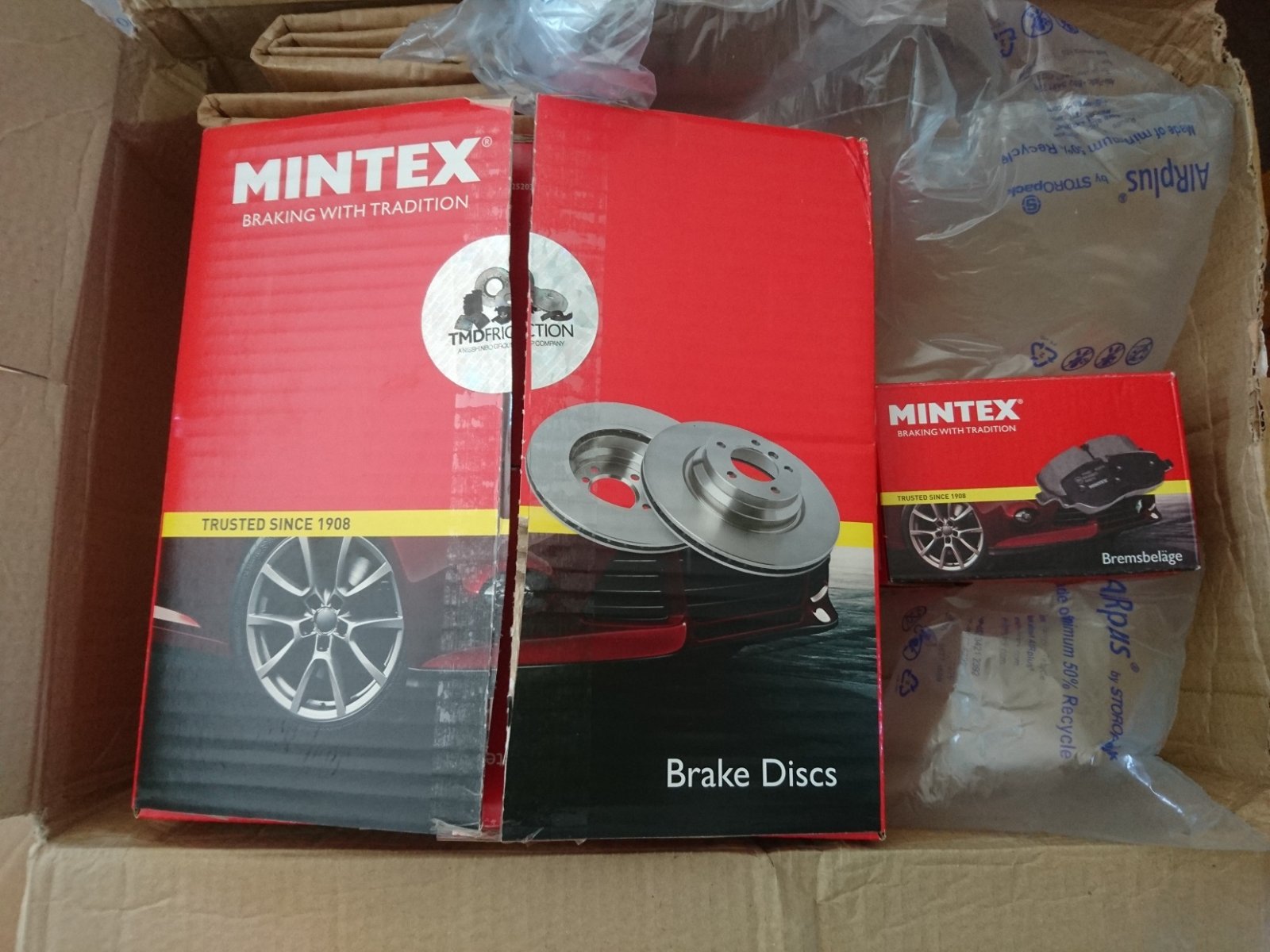

I actually managed to get over to the mancave today to complete the service on the legacy!! So we jacked her up to remove the engine and transmission sump plugs. Levelled the car and allowed them to drain!! All good. Then replaced both engine and transmission filters, interestingly both cartridge type but well labelled with their destinations! Then it was time to fit new washers to the plugs and refit them ready for refilling. Refilled the engine first with fully synthetic 5-30 as specified, I used Shell, and the transmission with Subaru's own ATF made for the car and cost a fortune!! Then it was time to check the front and rear diff oils and both had very clean clear oil to the right level so I decided to leave them as they had obviously been replaced recently. _ Pub O'clock had arrived so we slipped off to our local for a sandwich and light refreshment.
Returning to the cave after lunch it was time to finish the job by replacing the front discs and pads. We jacked the car onto axle stands and removed the front wheels. We settled down in front of one wheel each and set about removing the calipers - no problems for either of us. On removing the pads we both found them badly worn with severe grooves which did not surprise us as we had seen the state of the discs!!
Time to remove the caliper brackets which Dave did first, as we only had one breaker bar between us, and then it was my turn. I removed the top bolt as normal and then the trouble started. The bottom bolt was frozen solid. Lots of penetrating fluid and numerous efforts on the bar finally yielded a result. Shame it wasn't the one I wanted. The head of the M12 fine thread high tensile bolt sheared off leaving the bolt still through the caliper bracket mount and screwed into the bracket. So at this point the only option was to remove the disc and bracket together and then roll the disc out of the bracket leaving the frozen ex bolt, now stud, protruding from the bracket. It was then a job for vice and blow torch and after much straining the "stud" finally gave in and unscrewed leaving the bracket thread undamaged. Phew!! that was a relief, all that was needed now was a replacement bolt and the job could be completed. So I removed the old disc which you do by screwing 2 M6 bolts, I think they were, through the disc threaded holes which then push the disc off the interference fit hub boss. I prepped and fitted the new disc and set about the broken bolt problem.
Then the real problems began because although we must have hundreds of bolts in stock we did not have an M12 fine thread 35mm high tensile bolt or anything we could adapt! None of the suppliers I called had the required bolt in stock, so we decided plan B was the best option. I refitted the stud in the bottom of the bracket and slid it home and installed the top bolt. So the carrier is securely bolted to the top mount and effectively has a screwed in "dowel" through the bottom which will stop it from twisting around the top bolt. Then I used the piston compressing tool to push back the twin pistons, installed the new pads and shims and refitted the caliper. Dave had completed his side so we refitted the wheels and jacked the car off the axle stands and I gently reversed it out of the work area and parked it in a bay out side. I then borrowed the red mini which Dave has finished rebuilding but not got around to selling yet, luckily for me!, and drove the 30 miles home. Tomorrow I will be going to my local Subaru dealer, in Cambridge!!, and hopefully getting a new bolt to go and insert and the car will be ready for my three longish trips planned over the next couple of weeks!! Heyho!! :( :( :)

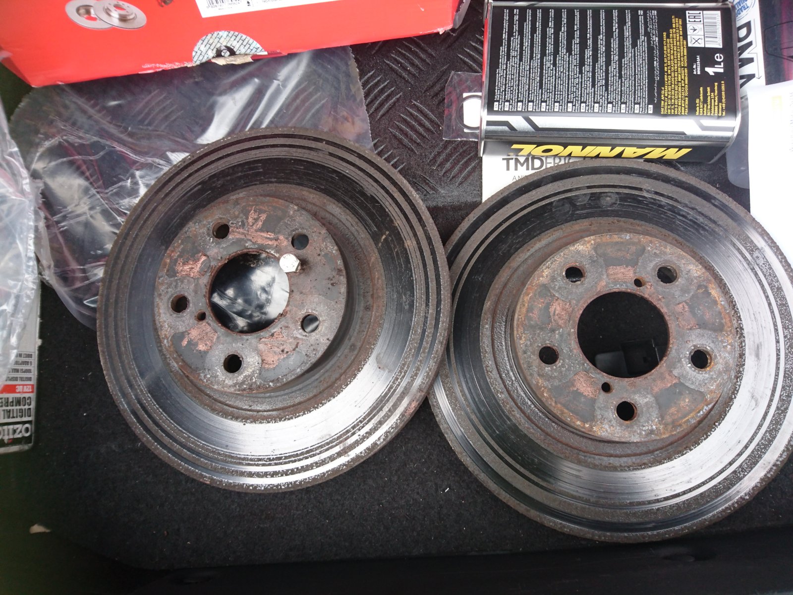

Well the job is complete and the car is back outside where it belongs. It is driving so much smoother with very impressive throttle response and brakes which are at least twice as good as they were and when you see the old discs it is easy to understand that!! : :-D
Own work
Own work
As you can see a maximum of 50% of the surface was being used for braking and now it is 100%. I find it hard to understand how the previous owner let them get that bad!! Together with fresh fluids throughout, new air filter and pollen filter it is genuinely like driving a new car, and I was reasonably happy with it before I started!!. All the belts have been checked and adjusted as necessary, timing belt in very good condition as are the plugs and previously mentioned rear brake pads so the replacements I had bought have gone into stock. Now looking forward to a couple of decent trips around the country in the next couple of weeks, Cheltenham on Friday, Thruxton on Sunday and Warrington on Monday week and Wednesday week!! :-D

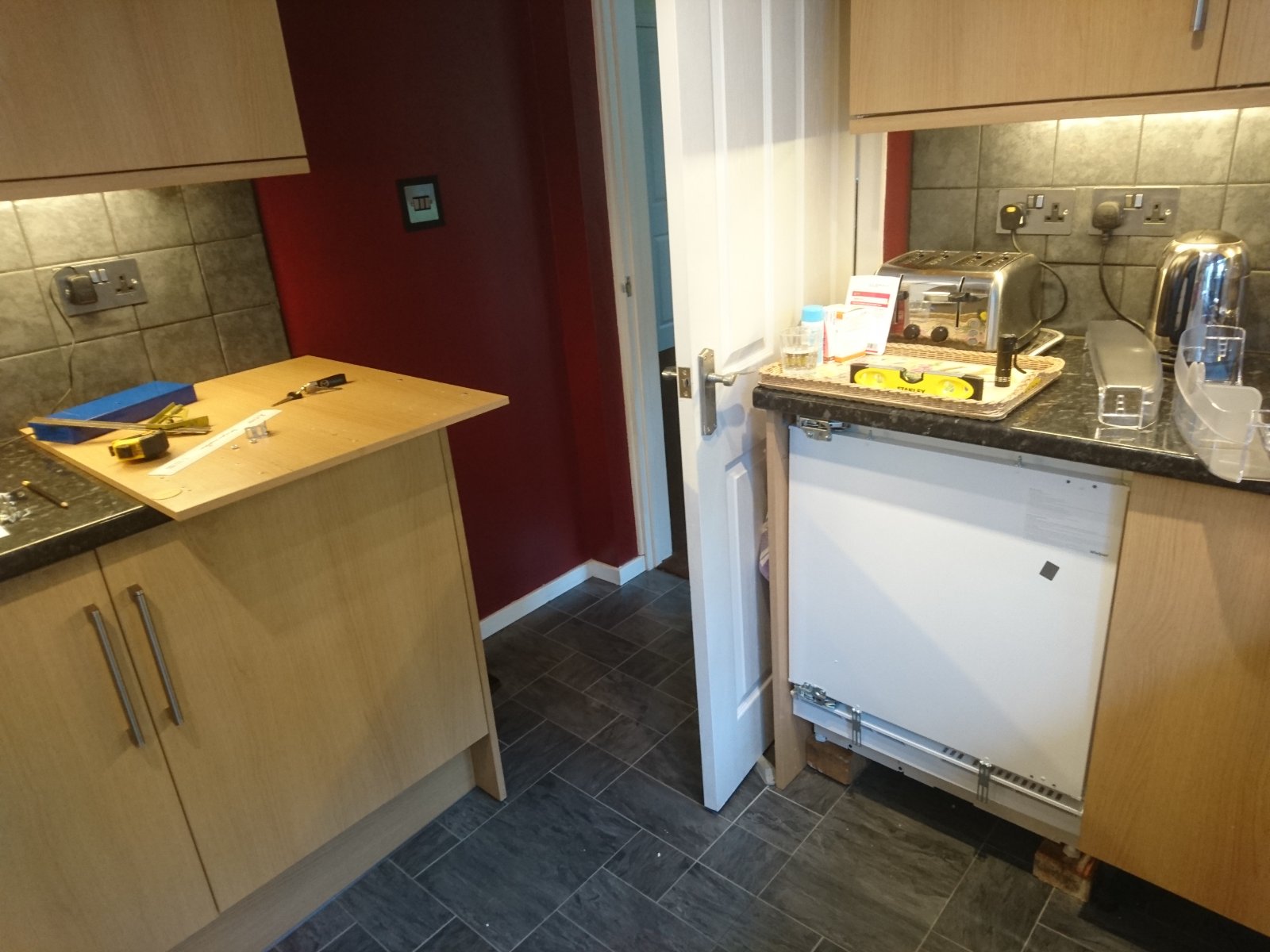

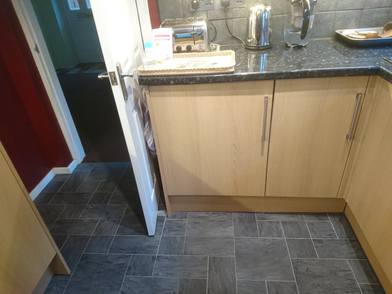

Had to turn to domestic issues today. Our integrated under counter fridge has been playing up for at least two months so about three weeks ago I ordered a replacement thermostat for it and installed it. After another week of iffy behaviour I decided it was suffering a fluid leak and just wasn't going to work. So SWMBO decided that she wanted a new one which I found and ordered from AO.com. (Having first ordered the same model from Amazon and then cancelled 6 hours later when I realised their delivery date was 22nd September!!)
So AO delivered on time this afternoon, having texted me at 07.00 to let me know I could have a lie in as they were delivering PM! :twisted: so I got up anyway and had an early breakfast! On arrival my first job was to unpack and then reverse the door hinges. It is a Whirlpool fridge so the instructions are in the form of the "IKEA" style line drawings. Basically I had to move the top right hinge to bottom left and bottom right to top left!! Simple you may well think, but when you discover that the screws will not screw into the holes on the left and after several attempts you discover you are just flattening the threads on the bolts you realise this is not going to be quite as straightforward as it should be!! However to cut a long story......out with the tap and die set and installed M5 tap and dies into their appropriate holders and re threaded the bolts and retapped the holes and we were ready to go. How many people have the kit handy for doing that one wonders? :(
As you will realise by now I hadn't remembered to take any pics until after I had done the door and then positioned the fridge into its new home:
Own work
Own work
So all that remained was to fit the door ---- hmmmm! Again to cut a long story ......... an hour and twenty minutes after taking the above picture I was able to take this one:
Own work
Own work
"I'm not paying £100.00 for them to install it" said I, " or £20.00 to take away the old one" -- that's the next job!! :-D
Still at least I can sit down with a Doombar and count my brownie points!! :-D
