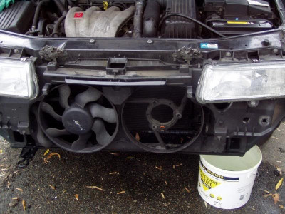

The following is borrowed from Cloggz so thanks to him
You can see with the fan removed from the housing the plug /socket which is the one i was trying to refer to earlier as the motor plugs into this :-D

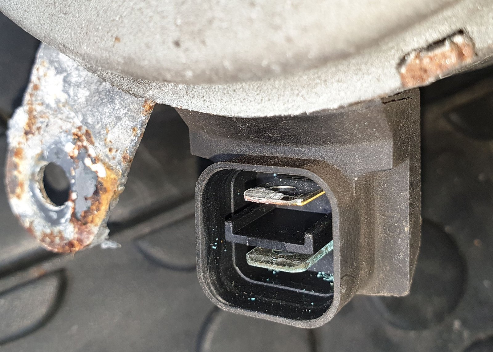

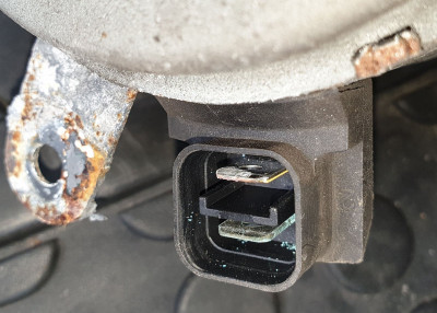

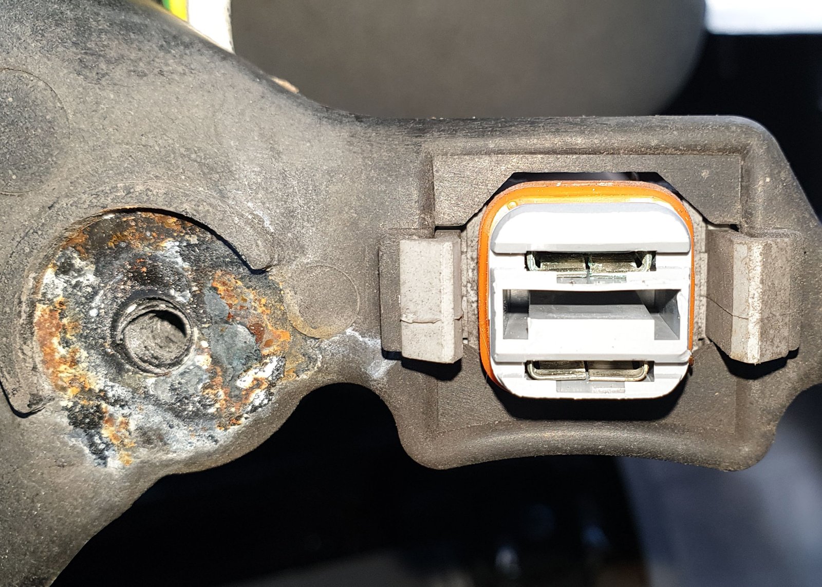

The center screw was left-handed so no problem removing, thanks. I removed the fan motor from the mount and looked at the condition of the spade connectors on the plug and the socket. The socket looked OK but the plug connectors were a bit corroded on the ends so I used wet & dry paper to remove it. Rather than attempt to break open the metal fan housing, which is very well secured, I decided to see if cleaning the connectors had solved the problem so put it back together and fitted to the car. Unfortunately if anything it seemed slightly worse so no joy there. I then took another look at opening up the motor body which is very solid and crimped in five places on each end. It didn't take me long to conclude it was not worth the effort so I have decided to buy a second-hand fan off eBay, it should arrive tomorrow and I will let you know if it solves the problem.

Those metal tabs in your last photo will just bend away, and should allow access to the motor parts.
When you get your 'new' motor, check that its of the same type as the old one (casing numbers etc), and do test it before the final fit.
Worth opening up the old motor anyway, to inspect the brushes. If they do turn out to be worn, you could simply fit new ones (I can suggest some web sites that specialise), test the motor, and keep it as a good spare, just in case... I have done that with a cabin blower motor.
