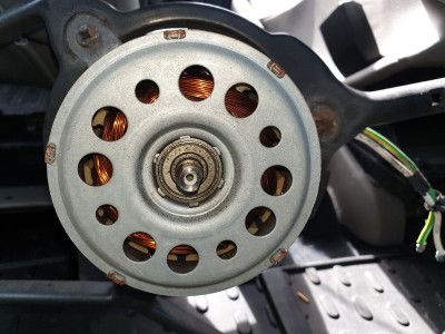

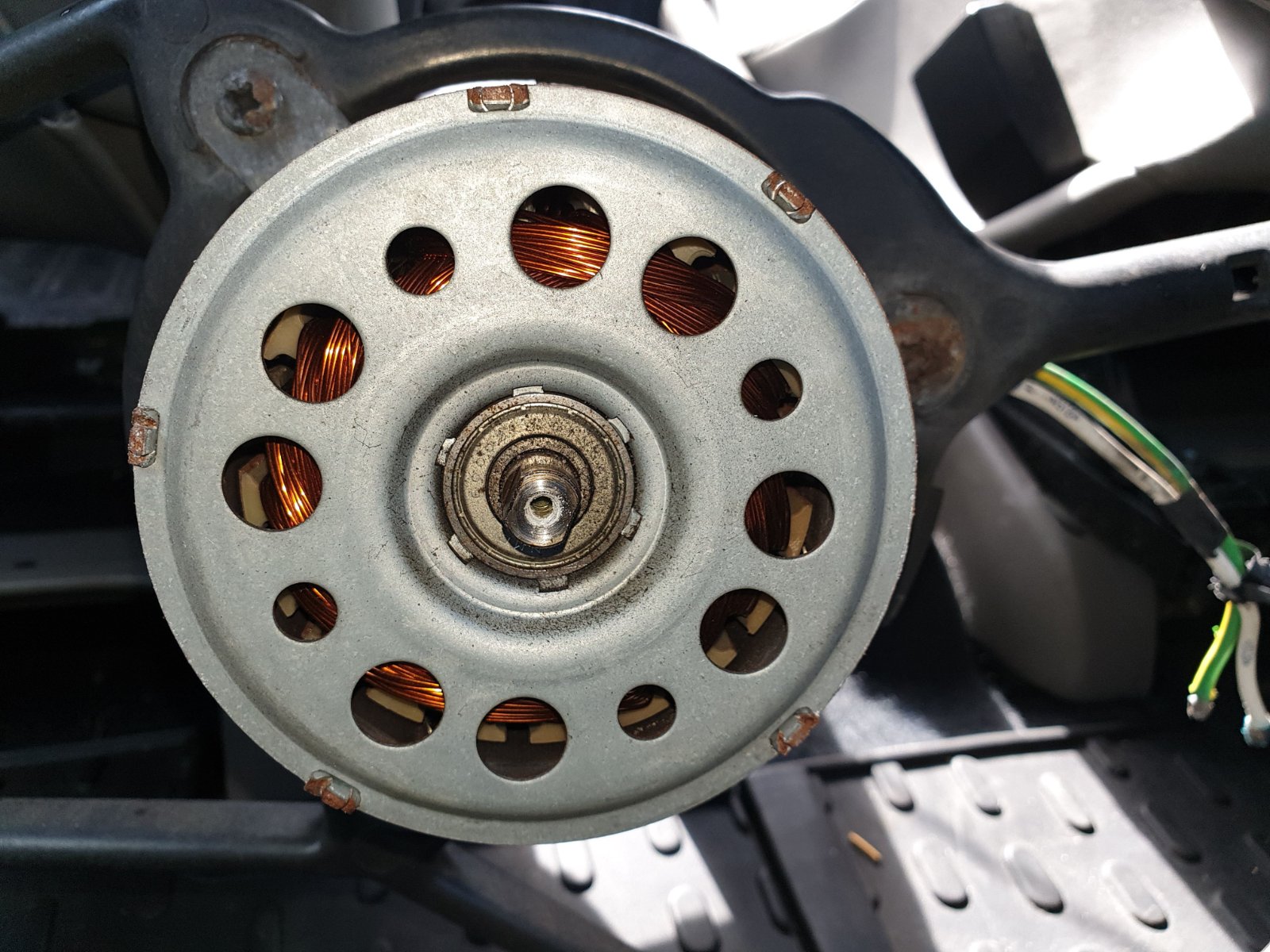

The center screw was left-handed so no problem removing, thanks. I removed the fan motor from the mount and looked at the condition of the spade connectors on the plug and the socket. The socket looked OK but the plug connectors were a bit corroded on the ends so I used wet & dry paper to remove it. Rather than attempt to break open the metal fan housing, which is very well secured, I decided to see if cleaning the connectors had solved the problem so put it back together and fitted to the car. Unfortunately if anything it seemed slightly worse so no joy there. I then took another look at opening up the motor body which is very solid and crimped in five places on each end. It didn't take me long to conclude it was not worth the effort so I have decided to buy a second-hand fan off eBay, it should arrive tomorrow and I will let you know if it solves the problem.

Progress! :P
Those metal tabs in your last photo will just bend away, and should allow access to the motor parts.
When you get your 'new' motor, check that its of the same type as the old one (casing numbers etc), and do test it before the final fit.
Worth opening up the old motor anyway, to inspect the brushes. If they do turn out to be worn, you could simply fit new ones (I can suggest some web sites that specialise), test the motor, and keep it as a good spare, just in case... I have done that with a cabin blower motor.

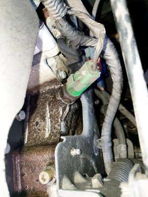

This is the only temp sensor I can see. Do you know the location of the other one.

That 2-wire green connector should be the Fan control temp sensor (#1220).
Try disconnecting that, with the IGN on (and maybe engine running).
I don't have the wiring diagram for your car, to find the details/colour of another temp sensor (for the gauge), if there is one.
The numbers of separate temp sensors were gradually reduced over the years. Originally three (gauge, injection ECU, water temp control), later two, and now (maybe) just one. Circuit diagrams would confirm.
Try pulling that green one, and see what happens - to either gauge, or fans, or . . . will engine run?

admiral51 wrote: 03 Apr 2020, 14:30 When i removed the plug on my thermostat housing on the Xantia it did not effect the dash temp gauge,i think the OP needs to find the right plug to unplug if that makes sense
That's because the Xantia wasn't multiplexed & could have up to 3 coolant temp sensors for different functions. One of the reasons for multiplexing is to reduce the amount of unnecessary sensors & wiring. Whats the point in having 3 sensors that all read the exact same thing when one sensor could just share the information with other systems?
Its most likely the Picasso only has the one coolant temp sensor that will do the dash gauge, the engine management fueling & the cooling fans, If you unplug it with the engine running it should put the cooling fan on full speed, put an engine temperature warning on the dash & will probably log a fault code in the ECU too so remember to clear the faults afterwards. I also wouldn't recommend doing it with the engine totally cold as it can also make the engine run very rich which can flood the engine.

Pulled if off and all that happend was the dash guage went to max, which is what happend with old original fan. Then after about 12 seconds the fan went into warp drive! Looks like it needs a new temp sensor.

Going to order a new temp sensor. I think there were multiple faults with the fan, both resistors, the fan motor and temp sensor. Hopefully replacing it will solve the long standing engine cooling problems.
