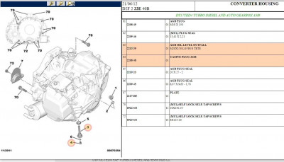

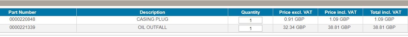

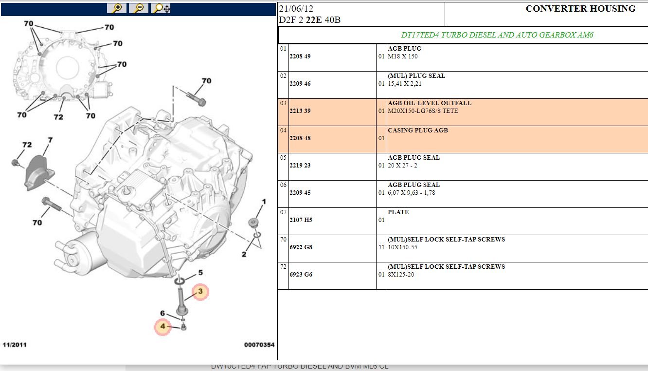

Just read a useful tip from the C5 site. If the small T40 central level plug is knackered and can't be removed, this stops you removing the drain plug because there's no access for the 17mm allen key. I was think about drilling the centre of an allen key out but then came across an easier method. Drill out the threads of a 17mm nut. The T40 still needs removing, but can be done carefully on a bench. Just checked the prices of both. The T40 is roughly a couple of quid, the larger drain plug which incorporates the level tube is nearer 40 on a site I've quickly looked at, don't want to be damaging that one!

Got the bugger out. Couldn't use the 17mm nut method because it wasn't deep enough to give traction to drain plug and socket but the theory is sound if you've got a deeper / longer nut. In the end I drilled the centre out to use an easy out, wouldn't grip. The drilled out centre did allow a torx bit to be tapped in though, so partial change done. Just 3 1/3 litres (with this quantity I can get an extra change out of the 20 litre tub). Still black with a hint of red. Going to do another next week. Certainly smoother with no abrupt sneezes going from 2nd to 1st when warm.
Does anyone know what kind of mileages these boxes can do? I'm on 182k miles, 1st double change in it's (motorway) life at 167K
And another bonus, the 'most expensive bolt in the world' survived. I got 2 T40 plugs for the princely sum of €1.68 (both) from my local Citroen main dealer.
