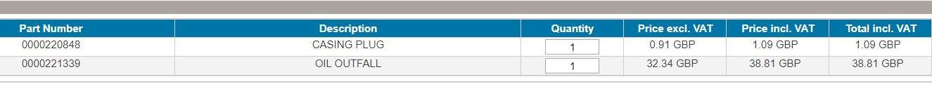

Just read a useful tip from the C5 site. If the small T40 central level plug is knackered and can't be removed, this stops you removing the drain plug because there's no access for the 17mm allen key. I was think about drilling the centre of an allen key out but then came across an easier method. Drill out the threads of a 17mm nut. The T40 still needs removing, but can be done carefully on a bench. Just checked the prices of both. The T40 is roughly a couple of quid, the larger drain plug which incorporates the level tube is nearer 40 on a site I've quickly looked at, don't want to be damaging that one!

The world's most expensive bolt??

And another bonus, the 'most expensive bolt in the world' survived. I got 2 T40 plugs for the princely sum of €1.68 (both) from my local Citroen main dealer.
