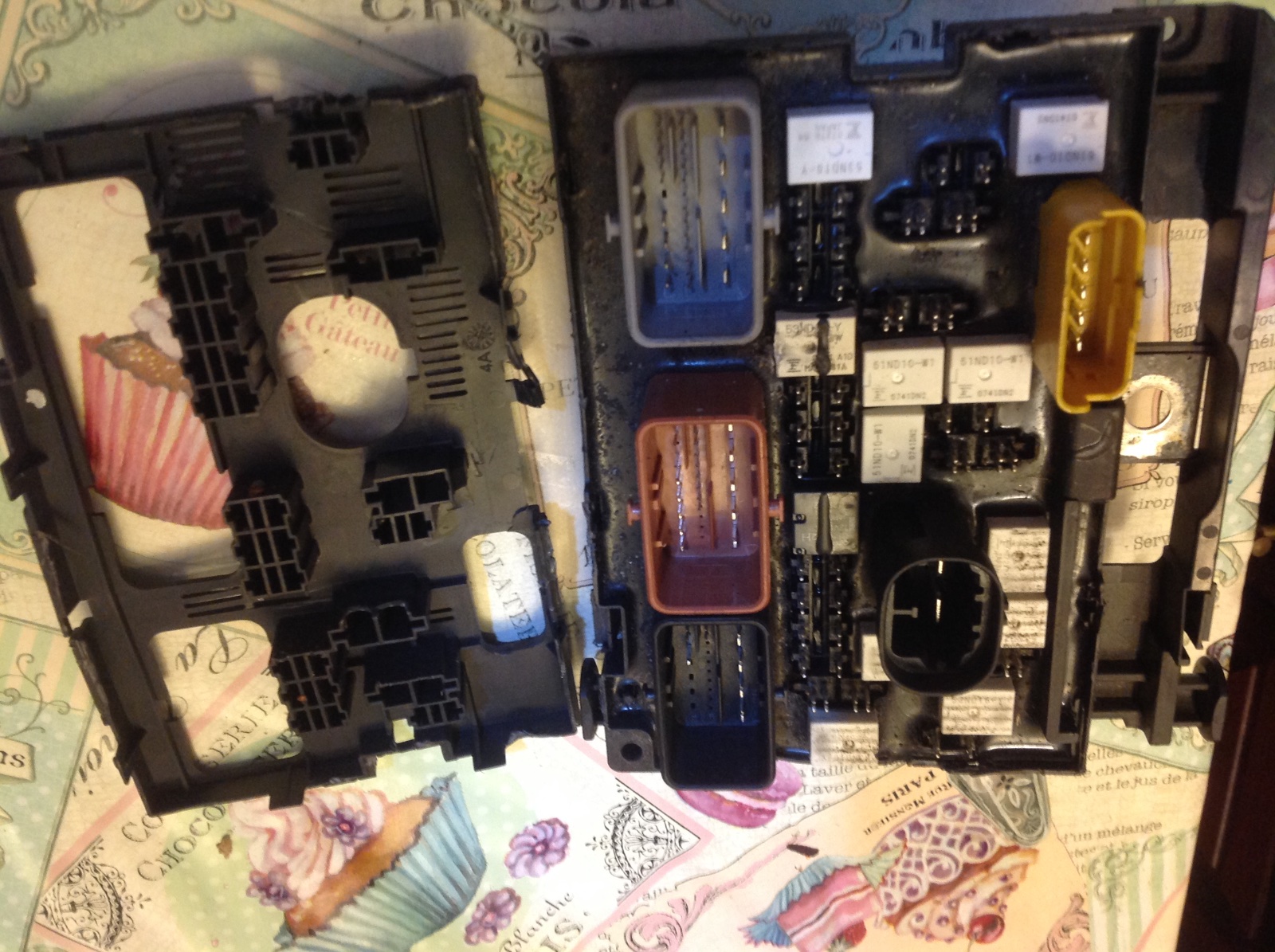

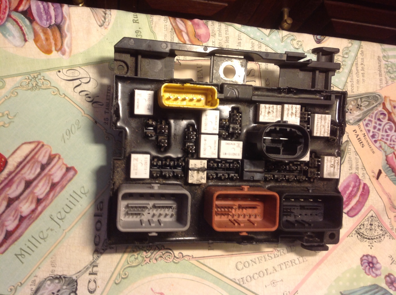

Hi, got the code for BSI it is F5FF just as before. Will try to clean the fuse box maybe lucky there. Thanks guys for all your support.

I would spray a proper contact cleaner (I use something called Servisol) into each plug and socket and then plug/unplug them a few times. That way the action should help remove any corrosion/dirt on the metal.

I could of saved you opening the fuse box, as there are no serviceable parts inside, but I guess you know that now!
