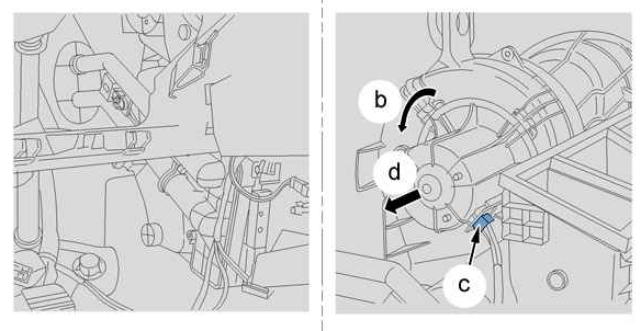

Ok, chaps - Pete, this is for your specific car: This is the blower motor location - for a right hand drive, this should be under the passenger side'
Unlock and disconnect the connector "" (at "c").
Rotate and detach the blower control module (following the arrow "b").
Blower Control module
