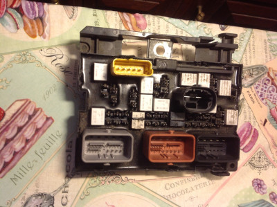

Hi, got the code for BSI it is F5FF just as before. Will try to clean the fuse box maybe lucky there. Thanks guys for all your support.

I would spray a proper contact cleaner (I use something called Servisol) into each plug and socket and then plug/unplug them a few times. That way the action should help remove any corrosion/dirt on the metal.

Hi guys,haven't had any success so far, I took it to a local garage to have code reading,it came up with blower motor code. But we know there is no power going to the motor. So now have been reading on forums and others had the temperature sensor to blame,others had the electronic control module. I took both of them out for cleaning and visual inspection but found no visible damage to either. Could the display unit be the one to blame? It has lights and all icons are there as everything is normal. This one is a dual zone control ac. Thanks for all your info so far

I’ve just been going back over these posts, and because it has been tagged into an existing thread with similar issues, I’ve just realised that I didn’t ask whether you checked the blower control module yet? Power is going to the blower motor itself, but if the blower control unit in the diagram I posted (item 3) is duff, then it will not pass the current onto the motor.
These are usually bolted on to the blower motor itself and can be replaced independently.
I could of saved you opening the fuse box, as there are no serviceable parts inside, but I guess you know that now!

Hi Marc, I have taken the blower control unit out but haven't seen anything to look like faulty on the board inside it. How can you check if is faulty or is good? Thanks

Looks won't help if the resistors are shot - these do fail and often it would seem. These modules are not really serviceable for the DIYer, and just need replacing - but quality of replacement units can be a factor - a decent branded one should be sought wherever possible as the PSA originals can be anything around £160 depending on type and vehicle. If you can bypass the control module and determine that the blower works, then I think you may have your answer.

Blower is working.so the module is to blame then... Found on eBay replacement. Will see if it's the answering my question

I've just tried replacing the control panel on my 308 ( same aircon system and fuse box) didnt work, so I've tried the motor n it works, replaced the resistor, bridged the 2 wires in the fuse box, still nothing, and now I've tried the control module, I've seen talk of an ignition cable being the issue, could it be that?

It seems that you have changed enough random parts, and it is time to measure some voltages to see where there is poser, and where there isn't.

Hi let me give you guy another tip. Peugeot and citroens tend to use small 30 to 40A fuse for the aircon system. I have intermittent aircon system function in my daughter 206. after checking numerous times I finally realised the fuse is okay BUT the contact for the fuse will sometime spark at the contact points between fuse legs and the fuse metal gripper when the aircon system is switch on. If you use a multimeter to test you will probably get a false positive as current drawn during testing is very low. What I did was
Clean the fuse metal legs with 1000 and 1500 sandpaper lubricated with contact cleaner.
Use a fine thin metal file to push the fuse holder contacts closer together for a firmer grip and also lightly file the side of fuse gripper
contact. Clean sparingly with contact cleaner. Make sure when inserting the fuse a firm push in is required . If the fuse is easy to insert
then you will need to do again this steps.
Never spray too much contact cleaner as the cold blast will promote water condensation on the metal parts and will wreck havoc with
all the contacts and connectors in the fusebox.
PSA Fusebox modules and connectors are not so well design compare with the japanese counterpart. Alway look for bad contacts and
connectors if you have intermittent faults. Buy good quality fuse and relays .

Be careful! The fan motor running flat out probably draws 30 A but the accessories socket is probably only rated at about 15 A.

Hi guys,I have changed the control module without any success, have also changed the control panel but again no better output. Have run out of options, will try to clean again those contacts. The blower is working when direct power is fed to it.

Hi All . . . Many thanks to all for this post . . I was recently in Australia . . A family member lent me their spare car . .petef wrote: 10 Nov 2017, 18:56 Just to be clear the bridging was done by splicing into the two wires.......
C4 1.6HDi . . But the Heater Fan/Air Con was not working . . .Temperature in the high 30degC . . !!
For 4 days we drove around with all the windows open. . . Then I thought . . 'I can fix this. . . onto this forum.
Connected a 20Amp link-fuse across these 2 wires . .and Hey Presto! . . Air Con and Fan working fine.
For the next 3 days I was driving around in blissful coolness.
Many thanks to all that posted.
(My brother-in-law has now ordered a spare part, fuse box from UK, and will fit it soon . . .
BR, tc542
