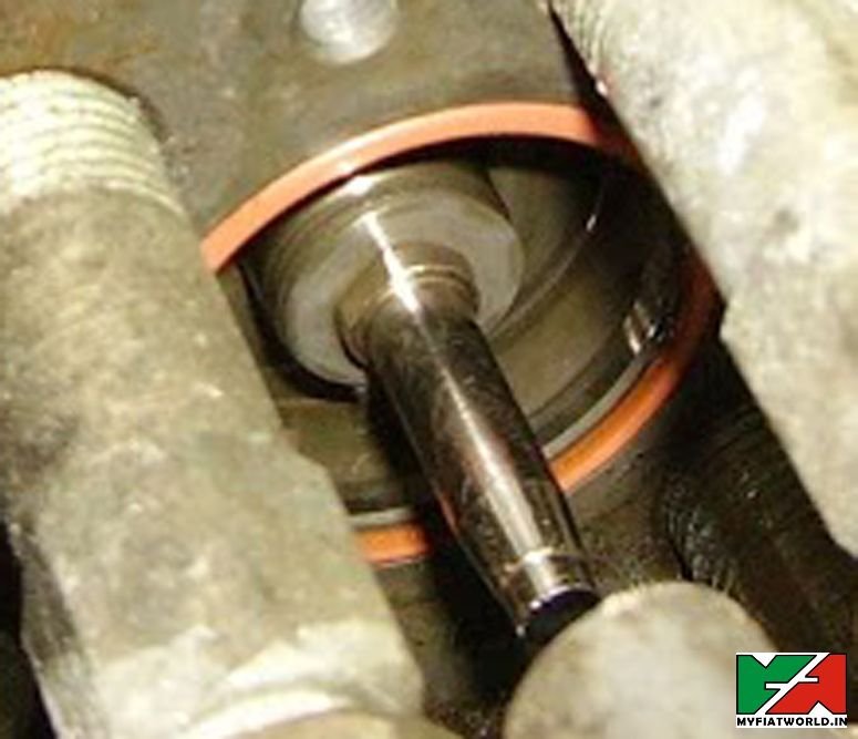

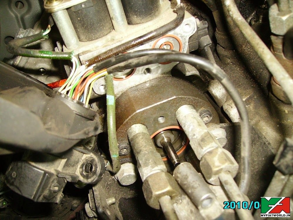

You have the o rings in the kit, but when you do the in car fix you will use them, so you need to get some more to put back in the kit to do the complete recon. Before removing the top solenoid clean around it well with a bit of diesel and a toothbrush, then wipe off. When you do the full reseal, set all the o rings out on a bench grouping the same sizes together, then count them, cross reference what you have of each size with the quantities stated in the kit to find out which ones are which numbers (not explained that very well but I hope you follow). The kit only gives part numbers, not sizes. Some are very similar. If you need a manual PM me.

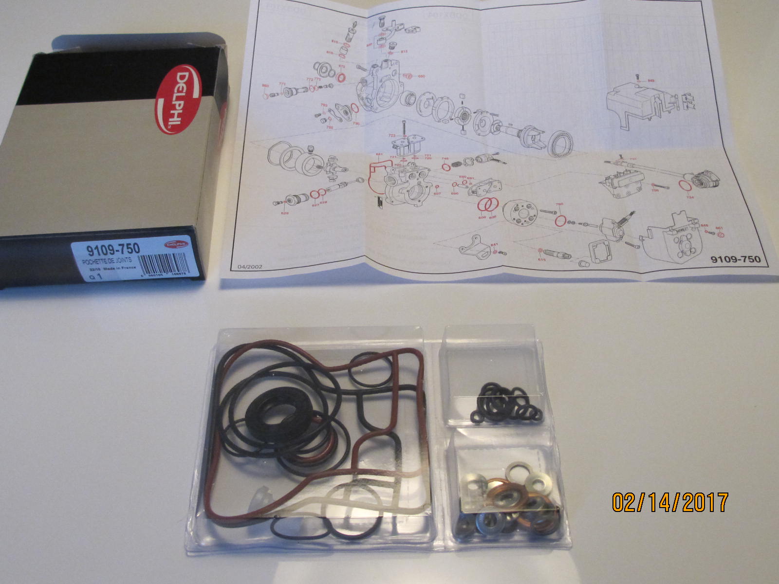

Hi, my brother just brought several Delphi seal kits from France, so I plan to start overhauling one of the diesel pumps. I`ve got one on the table now, cleaned and ready:) I guess a manual would be very helpful. Tried to send a PM to moizeau but it does´t seem to leave my outbox. Anyone got a manual to shear?

Adi, the problem will most likely be the viton o rings under the top solenoid. They can be replaced in situ for next to no money. Have a read through the post, there will be measurements mentioned and a description on how to do it. Only use o rings that can cope with fuels, not garden equipment. If you decide to go a head, make sure everything is very clean before you remove the solenoid and use petroleum jelly to hold the new ones in place during reassembly. Also be aware that the wires that you will see (13 I think) will have very brittle insulation that can fall off exposing bare wires. This will then require a new fasceau soldering in (200 euros for the part) or replacing each wire. Although air ingress can be a problem, if the problem gets worse when warm, it's generally the o rings.

XMcoda wrote: 14 Feb 2017, 08:15 I haven't noticed any leaks but I will check this. I have to renew timing belt and water pump, so it`s not so much extra work to dismantle the pump. It would be interesting to try the one hour in-car-fix to locate the problem(s). I already purchased a gasket kit: Delphi 9109-750. I guess this contains all the parts I need?

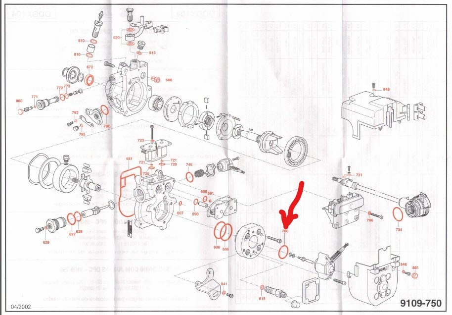

Hi,
I know this is a old thread but i need some help. I am in Australia and cant find a Gasket kit for my pump. I only need Size of "O" Ring shown as Part Number 760 shown in Kit Diagram above.
ID and OD would be a great help.
