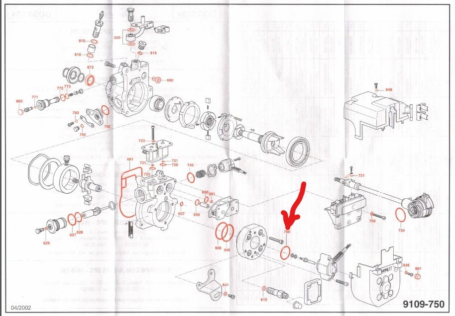

XMcoda wrote: 14 Feb 2017, 08:15 I haven't noticed any leaks but I will check this. I have to renew timing belt and water pump, so it`s not so much extra work to dismantle the pump. It would be interesting to try the one hour in-car-fix to locate the problem(s). I already purchased a gasket kit: Delphi 9109-750. I guess this contains all the parts I need?
Hi,
I know this is a old thread but i need some help. I am in Australia and cant find a Gasket kit for my pump. I only need Size of "O" Ring shown as Part Number 760 shown in Kit Diagram above.
ID and OD would be a great help.
