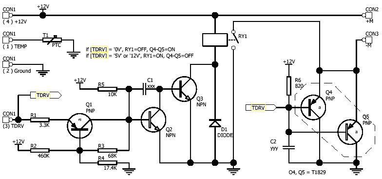

If this is the wire going to pin 3 of the brown plug then +12v here will stop the fan whereas an earth will make the fan run at full speed.Peter.N. wrote:That will be your problem then, if I remember correctly there should be around 3 volts on this wire, its the control signal from heater panel, if you connect it to 12 v the fan should run, sounds as though the fault is in the control panelDHallworth wrote:OK....
On the orange cable (thin one) going into the fan multi-plug there is less then 0.1 of a volt.
David.
Don't be confused by trying to measure a voltage at pin 1. This is just a thermistor measuring heatsink temperature on the regulator. It signals the ECU to make small changes in speed to compensate for heating effects.
Here's a diagram of the blower regulator.

No worries Peter. I've alwas had trouble with PNP transistors; possibly as there was never really a PNP concept in the days of valvesPeter.N. wrote:Sorry Jim, forgot they were PNP transistors
Whenever I look at a circuit diagram containing transistors I mentally relace them all with triodes. I can then understand better how they work....
Just imagine if the blower regulator did have valves in it... No need of a heater matrix for sure....
