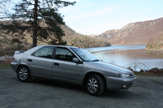

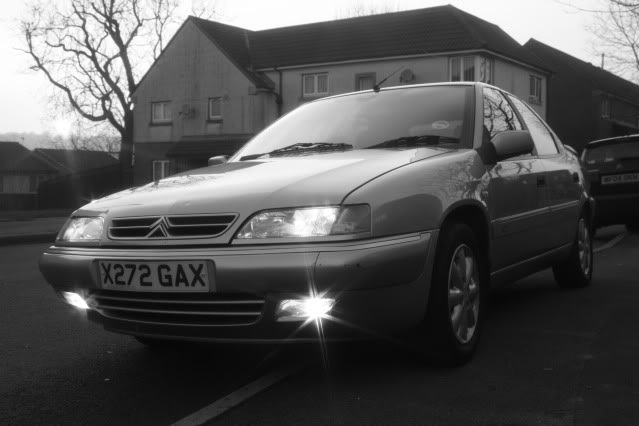

Took the Xantia out for a run today, It's first long run since we have had it.
Very smooth since i did the spheres. Did 215 miles all through Mid Wales and back. Very pleased with the ride and performance.
Can't wait to do all i need to do to it and looking forward to using it on the annual Cornish holiday this year..I need a trailer now though as the boot get's full with everything we take..
Couple of photos from today.
