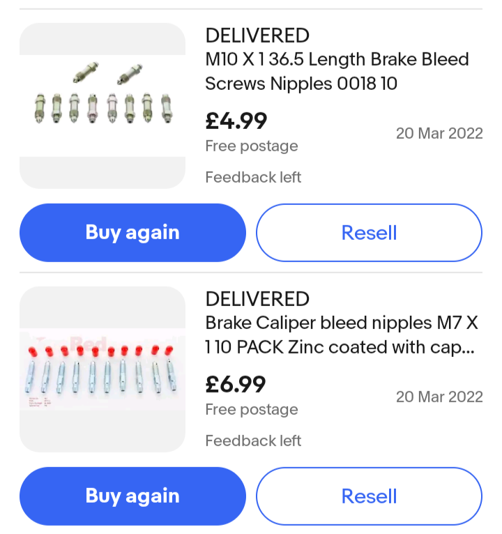

Thanks Jim. I've got new front Flexi hoses "in stock" as were advisory last year (not mentioned this time) I'll put a request on the parts number thread for the bleed nipples front and rear - I always put new on first time I've some bleeding to do on a car (as usually find some "rusty stumps" waiting for me at each corner!) Not sure if the Brembos are different to the Lucas calipers (M10x1.0 from memory) rears are M7x1.0.CitroJim wrote: 05 Dec 2023, 17:47 Mick has said it all most eloquently Matt and I can only agree![]()

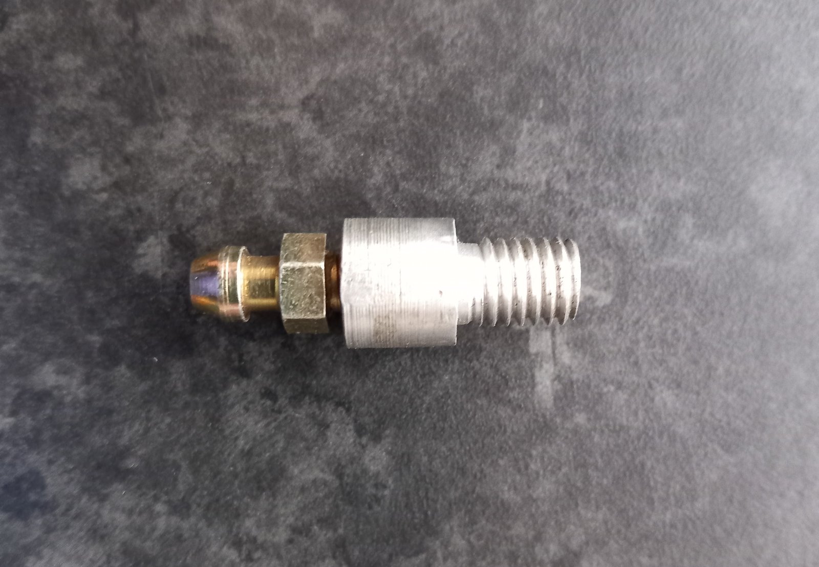

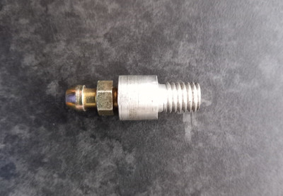

Yes, M7x1 is the standard nipple size Matt... I've a feeling the Brembos will be these... Must say I've not come across an M10 nipple from memory but have seen M8 and M6 ones...
M8 can be good when you need to drill out and retap an M7 and I've used M6 ones to make up little adaptors to retrieve hopelessly damaged M7 nipple threads in alloy calipers...

Loving that bit of resourcefulness there Jim! (And excuse for a play with the lathe too
Am pretty sure the other Coupe was M10x1.0 one end, M7x1.0 on the other.
In fact, looking back in time in my eBay purchase history, it seems I bought all these: Just need to recall where I might have neatly stored them in the garage....
