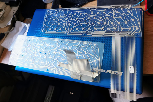

That is an original Sinclair QL power supply. I had been looking at coming up with a modern solution, however this popped up on eBay cheaply enough it just wasn't worth the hassle.
The second was also for the QL, but this time a modern replacement keyboard membrane.

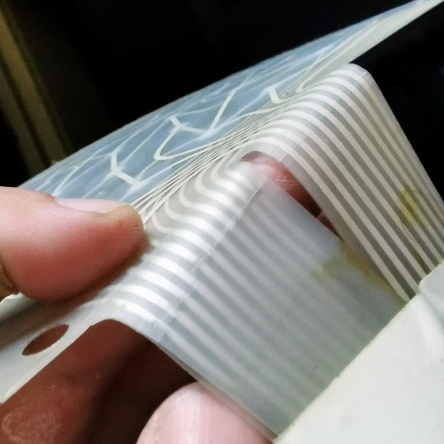

You can clearly enough see where the original one has cracked where the cable flexed.
With the new membrane fitted and the power supply hooked up we do now have a working QL.

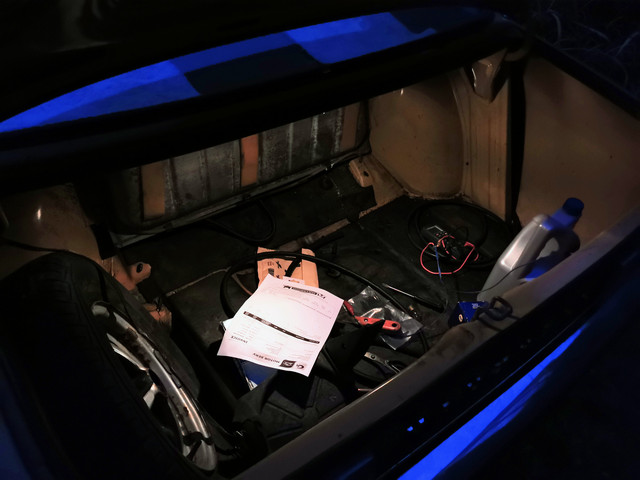

Spotted this light in the boot somewhat at random.

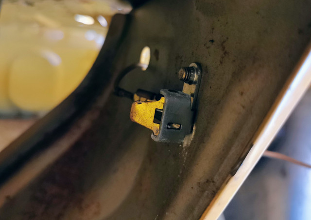

Initially this caused a bit of head scratching as I couldn't immediately find the switch. Turns out to be quite a tiny little thing hidden behind the nearside hinge mount.
It's a little normally closed switch which is pressed by the hinge as the boot lid is closed.
Initially this was resolutely dead. Turned out we had a poor contact on the power supply lead, in the lamp holder itself *and* at the switch. Once all of these had been cleaned up we had a working light.
Of course having established the light worked there was a very important test to then be made.
Excellent, yes the light does actually turn off when the boot lid is closed.
