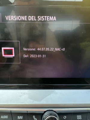

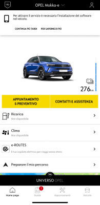

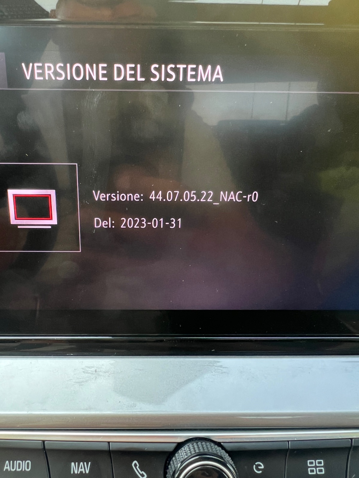

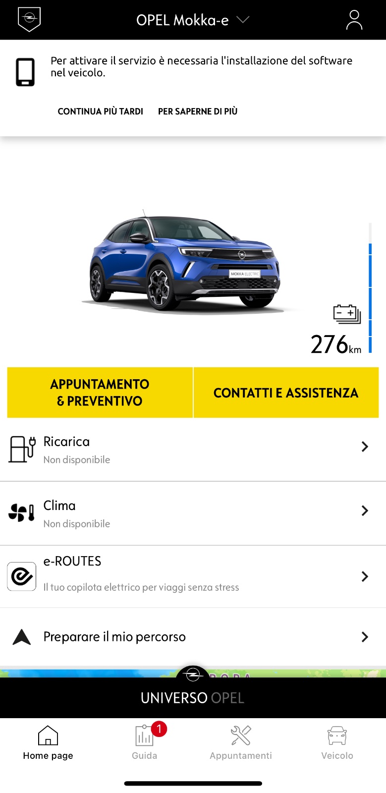

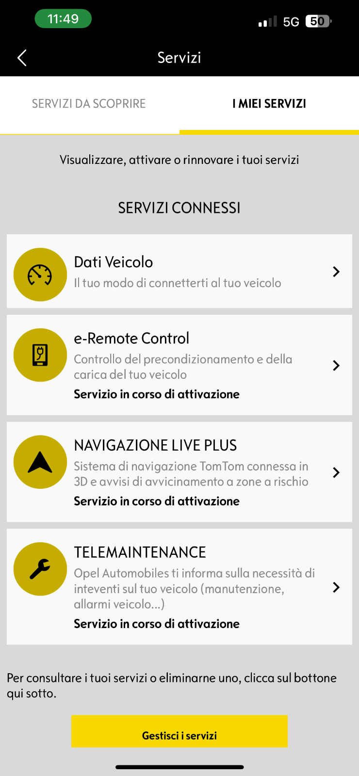

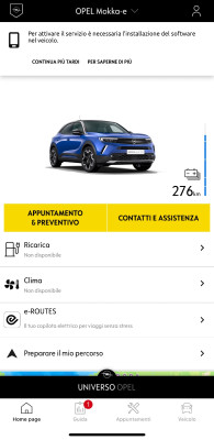

giustyle
- Posts: 2
- Joined: 16 Aug 2024, 10:42
Re: PSA NAC RCC Updates
Thanks!
My problem is the activation service:
Navigation live plus result “in activation” but I don’t see any navigation or maps in my car.
E-remote service, the activation final step is blocked, “wait the sw install on car” I try to travel for hours but nothing.
Myopel is a bad app
Myopel is a bad app
- x 6963
That message would indicate that your dealer needs to check the activation status of your services subscription. For later vehicles I think you only get 3 months free of live services, then you have to pay via subscription to receive further updates.
So it is no uncommon for there to be issues with the service activation from your account.
My advice is to log into your Peugeot live services account via the web and check the status of your service activation.
