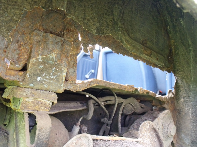

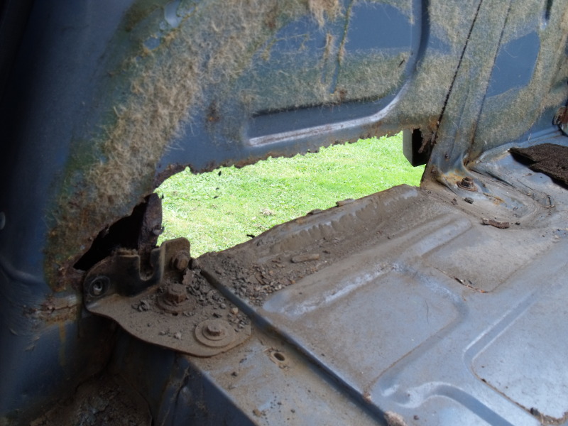

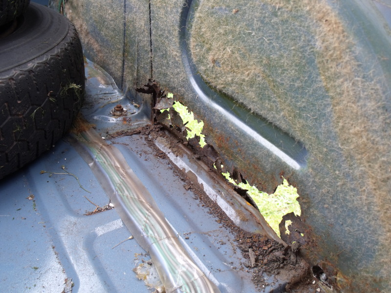

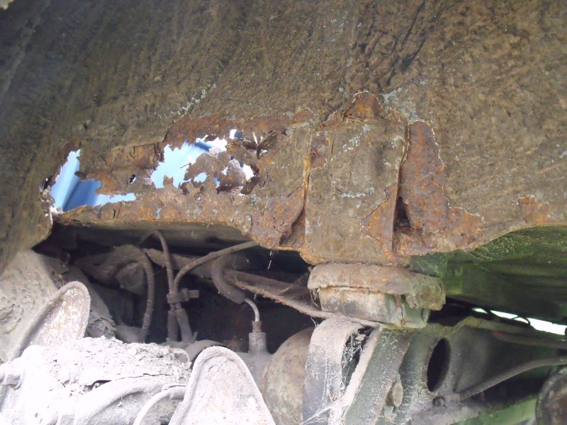

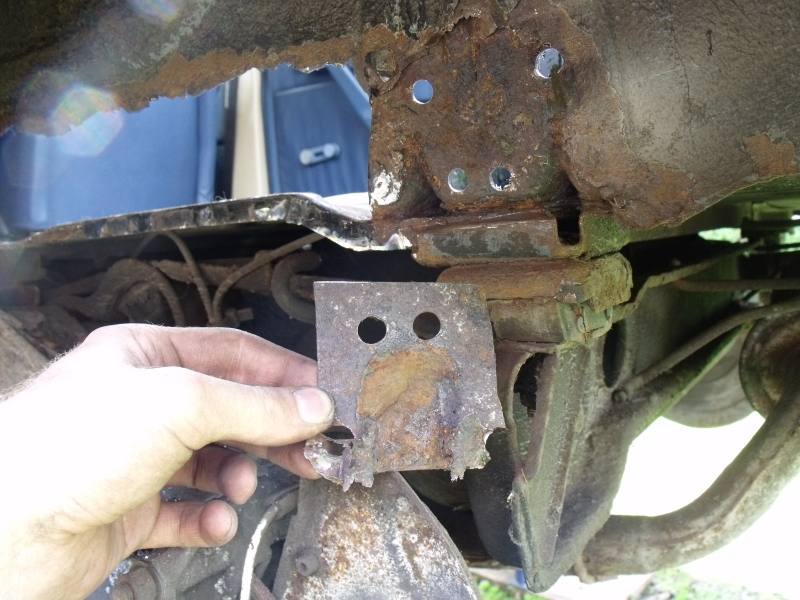

I spent most of yesterday working on Annabelle, the rear wing holes just keep getting bigger and bigger. To start off with I wasn't going to worry about the NSR until I thought I'd better give it a quick tap just to be sure its solid. Many thanks to Malcolm and Anthony (not a forum person) for their various bits of advice on doing the job here
The OS
NS
NS after cutting off the outer reinforcing bar to get to the rusty wing.
Once it's cleaned up a bit more, the plan is to make up and weld two new sections here. One covering up the big hole into the boot which will be welded from the inside at the top, arch side on the bottom and another past the subframe mount which will be welded from the arch completely.

Good progress with your GSA there, looks fairly clean in other areas in those pictures. Good luck with the welding, it'll be back on the road in no time at this rate! Its sure to pull you out of your winter blues too, what an achievement to weld a car and get it back on the road after so many years. Tbh, that is no worse than the Transit van I drive at work, im not quite sure how that goes through MOTs. T'is very handy for checking the tyre treads from the inside though!

I've done this welding job too many times of various G's before - least it's easy to access and work on!
Worth it though and pretty much a prerequisite on keeping most G's on the road. The other favourite
is rebuilding the front undertray and keep an eye on those sills...

A bit of newspaper, chicken wire and lots of filler and it'll be a proper job Kev
You'll be a very good welder when you've done that lot but at least it's all flat panels. A really great project!

red_dwarfers wrote: I spent most of yesterday working on Annabelle, the rear wing holes just keep getting bigger and bigger. To start off with I wasn't going to worry about the NSR until I thought I'd better give it a quick tap just to be sure its solid. Many thanks to Malcolm and Anthony (not a forum person) for their various bits of advice on doing the job here![]()
that was some tap there Kev was it a small tapping device or the big one the MOT tester might get out occasionally
whats this covering up bit then Kevred_dwarfers wrote: Once it's cleaned up a bit more, the plan is to make up and weld two new sections here. One covering up the big hole into the boot which will be welded from the inside at the top,
you are ment to be replacing the large holes/voids not covering them up
