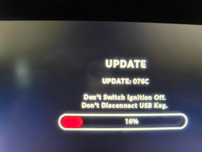

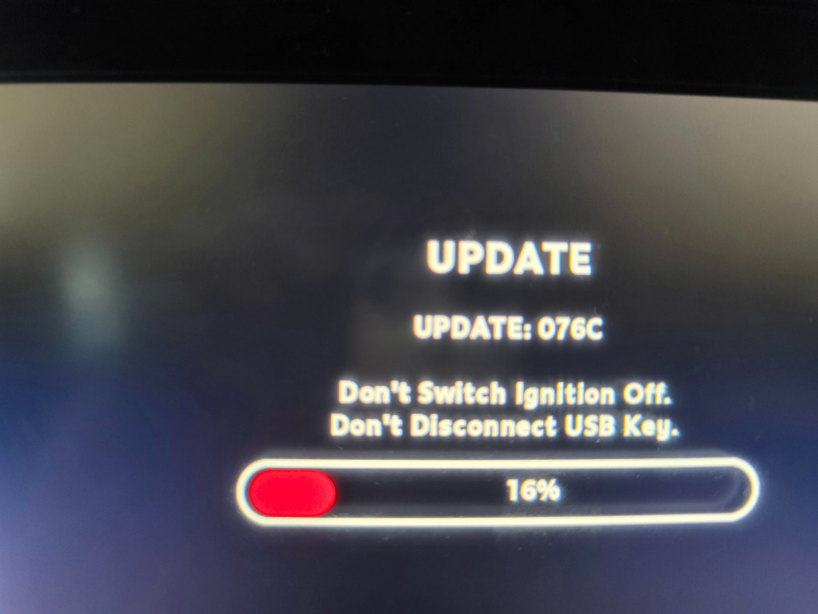

Hello again, here is the VIN VF7**************[VIN obfuscated, can be read by forum staff] of my car so you can help me.
I downloaded and tried to install this version 1_076_161B116.4 on my car and I am stuck.

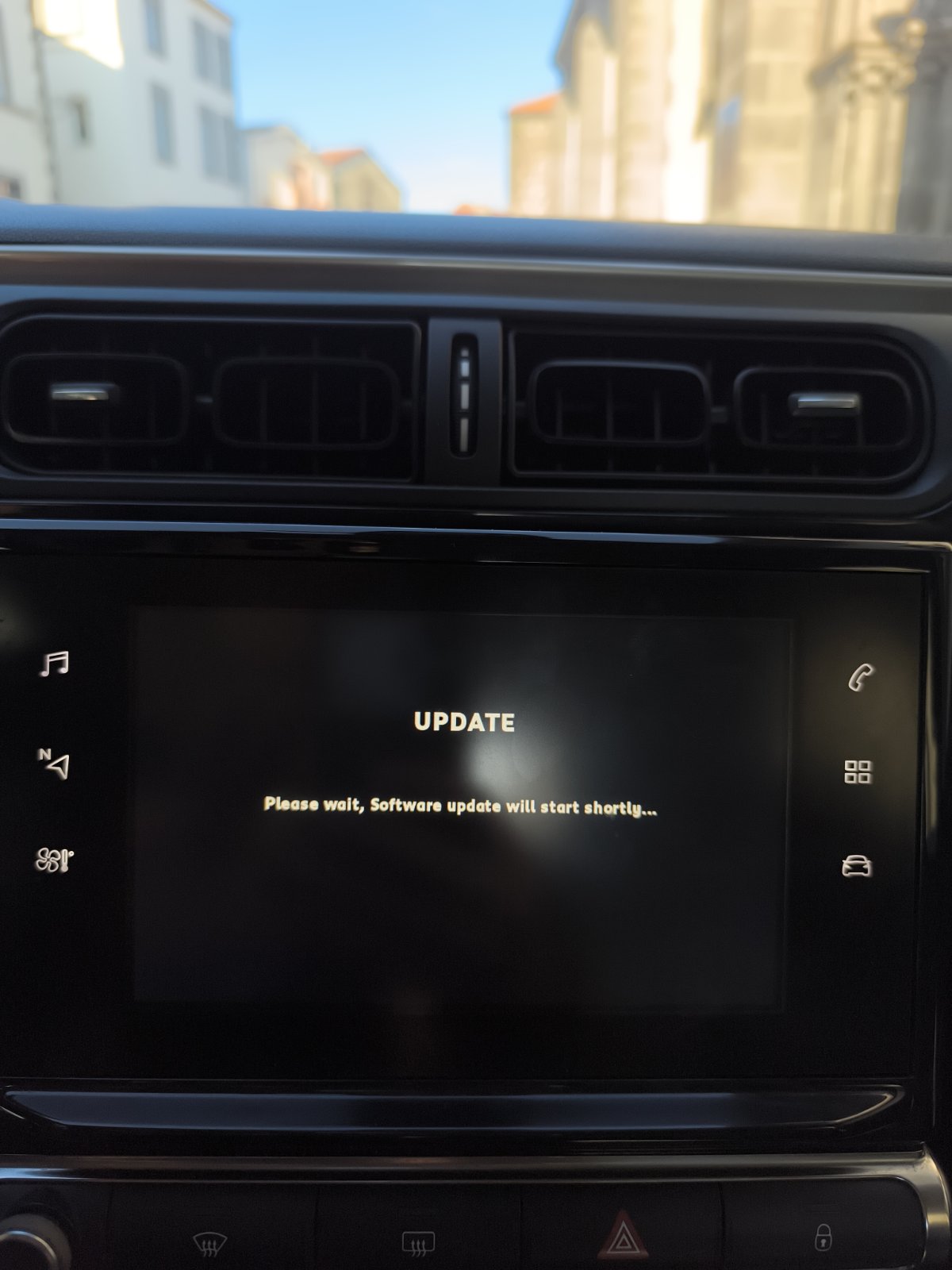

Okay I understand. Thanks for your try.
Apparently I do not have the key (anymore) and failed a update at the very end of the process. A rolling back was/is not possible. Maybe I do.something wrong but I cannot find a key anymore
- x 6963
Re: PSA NAC RCC Updates
Ok, so the original licence for the SAME firmware would still work if you had it.
The only thing I can think of now is that if you tether your smart phone's WiFi connection to the car using USB cable, then this is how the vehicle can authenticate and obtain the licence file. You would need to do this first, make sure you have a good connection and then try the firmware update again if you still have the firmware file.
Last thing is to contact your dealer and tell them it's stuck after a failed update and you can no longer get the licence or the firmware (a stupid system where it deletes it after you have downloaded it, I know).
