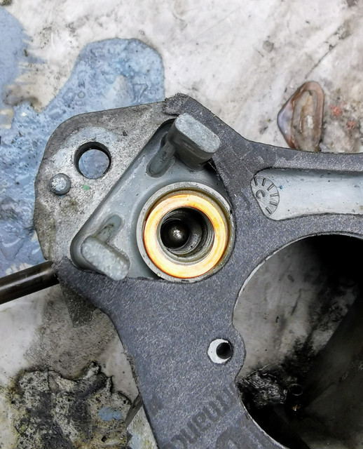

From the feel of it I reckon someone has reassembled the mechanism for the accelerator pump incorrectly or there's a spring missing. Feels like the plunger is stuck at the far end of its travel.

You should be able to rev it up without the Accel pump, as long as you go slowly. The acc pump mostly just stops it leaning out and stumbling if you snap the throttle open. I'm sure on the Visa the nozzle on the pump was blocked with petrol gum.
x 1746
Re: Zel's Fleet Blog - Xantia Activa, BX, Jag XJ-S, Sinclair C5, Mercedes 208D, AC Model 70.
The squirt of fuel when suddenly opening the throttle is an ancient Solex-etc fixed-jet feature.
Be careful NOT to peer down the carb ports* with engine running, to inspect/test! A weak mix backfire can easily remove eyebrows :shock: . How do I know??
* Use an angled mirror

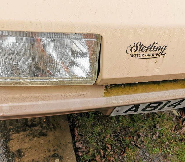

A decent wash can make quite a difference.
Bit of moss on the bumpers...
Didn't go crazy under here, just knocked the worst of the gunk off, not least the aluminium oxide dust that was absolutely everywhere.

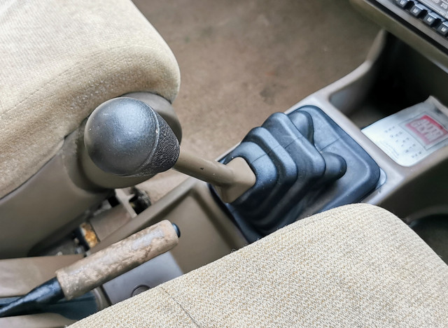

A really nice touch is how much on this car is colour coded...gear lever and handbrake both are which is a nice touch.

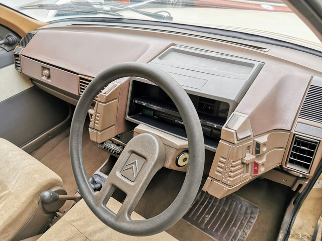

After another load of treatments the dash is starting to look a lot better.

[] Dash needs to come to bits to sort out the plethora of dead lamps...the fact that neither the low coolant or overheat lights work makes me nervous. Though I did determine the cooling fan works yesterday.

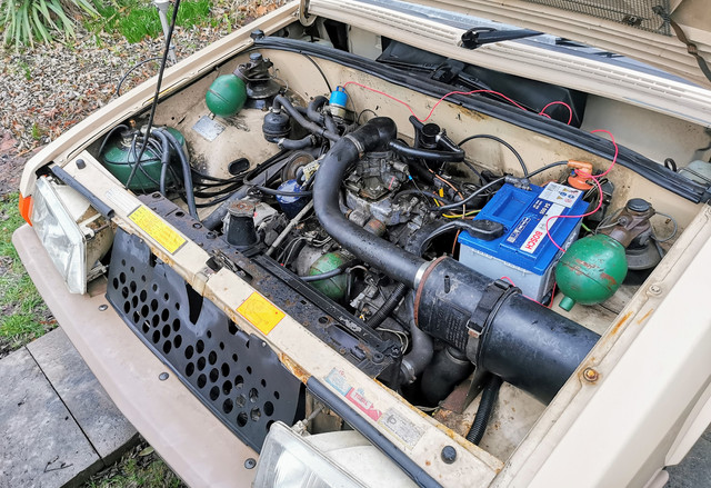

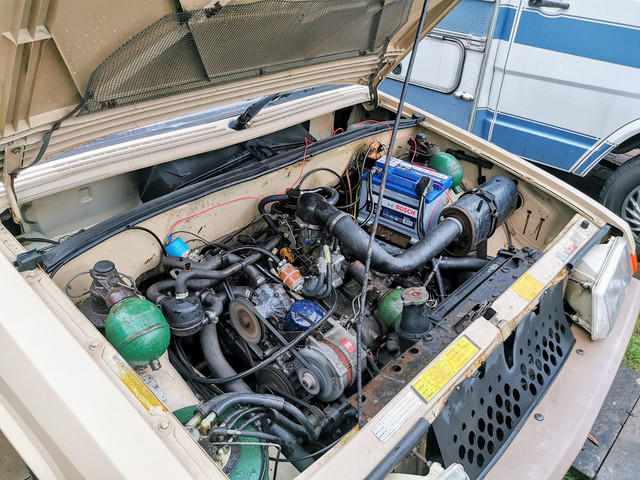

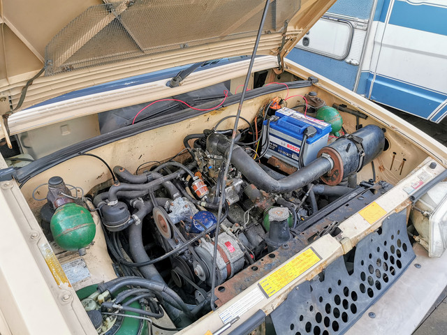

Chris, the Vin is clearly visible in the first picture of the engine bay - highlighted in yellow!
As far as I can see, the only mistake that Zel made was as you've noted - '7' in position 3. I just logged in to Service Box and got the same result as you. Perhaps the database doesn't go back that far?
As an alternative, I tried just selecting 'BX', expecting to be asked for some details. To my surprise all BXes seem to be lumped together - under Engine Block there are 11 separate items - presumably all unique!

The VIN is correct - no '7' in it as you would expect. I've seen similar BXs with the same VIN format. It's just age-related and a time when they didn't really have the electronic systems in place - it was all on microfiche or paper. So a lot of the info was never transferred over to the main database used now on a model by model basis for these early vehicles.

Quite a productive hour or two this afternoon.
Fuelling mystery solved. Well, functionally anyway...

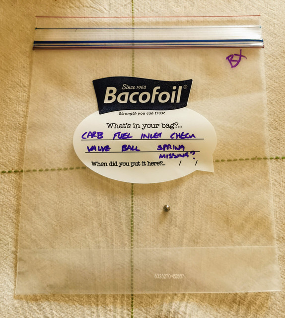

There were two separate issues I'd been having. One was that initially I struggled to get things primed at all - this was quickly traced to the fuel pump being very weak - which it definitely is. However even with a known good electric fuel pump fitted I was still having a huge hassle actually getting fuel into the float bowl.

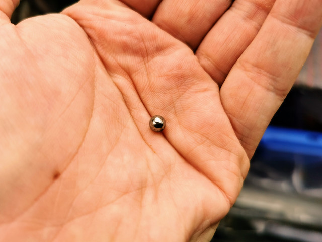

Today I decided to dig into things to find out what on earth was going on there. With the top off the carb the mystery was solved the moment I removed the float bowl needle valve (the needle and seat are an integral assembly in this carb) and I found this.
The thing which interested me the most if it's not clear from that photo is this...
I assume that this little ball is meant to be part of a check valve, probably to assist in stopping the fuel draining back to the tank. However for it to work as intended it would need to have a spring under it, without a spring it would simply sit quite happily against the fuel inlet port under gravity...only sealing more tightly as fuel pressure was applied. Essentially working nicely as a check valve...just in the wrong direction! Clearly the reason that I was really struggling to get any fuel into the carb. For the time being, I've removed the ball, bagged, labelled and stored it with the rest of the spares in the car.
I'll see if I can find a suitably tiny spring shortly and use that to refit it. Though it's not shown on either of the diagrams I have for the carb...which leads me to think there are two possibilities. 1. It actually belongs somewhere totally different in the carb (I know something is amiss with the accelerator pump). Or 2, that it's a later addition to the design (no idea if this carb is original to the car, given the mileage it's entirely likely it was replaced years ago) so not on my old diagrams.
For now though this has resulted in a car which starts first touch and *stays* running properly.

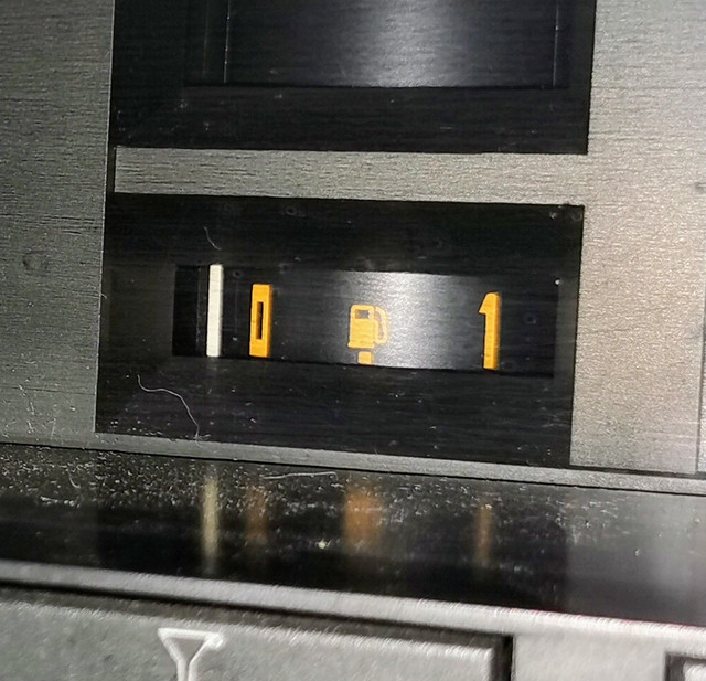

Which took me a second to realise was because the tank actually appears to be full.
Despite the claims of the gauge!
The gauge never even twitches from the stop. I'm hoping that this is a grounding issue at the tank or a faulty sender rather than a fault with the gauge itself as finding a replacement for that I would expect to be quite a challenge.

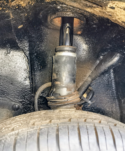

Do have one obvious suspension job to do - the strut gaiter on the nearside has totally disintegrated.
Not particularly surprising to be honest, and simple enough to sort - albeit a bit of a faff because of the amount of stuff you need to dismantle to get to it as I recall. I've done this job on a Xantia a couple of times albeit a number of years ago - I'm assuming the process is pretty similar.

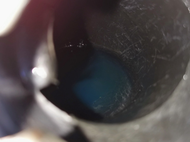

One real good thing from today as well is that I think I've tracked down one of the main spots where water is getting into the cabin.
This is the only place I've actually seen water dripping in, and the passenger footwell is by far the wettest bit of the car. This seems to be coming from the intake grill for the fresh air vent, guessing the gasket has just failed due to old age. Re-sealing that should be pretty simple hopefully.

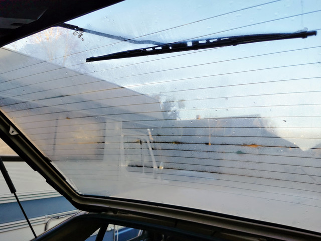

There's a bit of damp in there though - not helped by the heater blower currently being dead. The rear window heater kind of almost works...

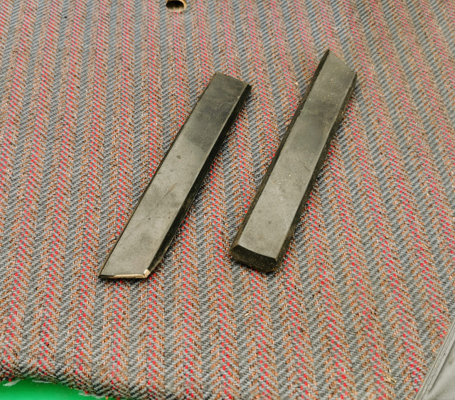

While having a rummage around in the boot I found the bits of trim that are currently missing from the front wings, just need to get some really good strong double sided foam tape so I can reattach those as it will tidy the car up no end.

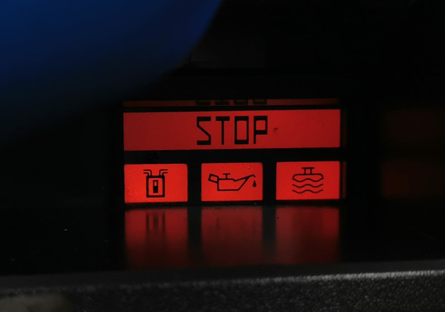

Also discovered that the low coolant warning light does work (on test at least), just the test button has some seriously scratchy contact issues going on.

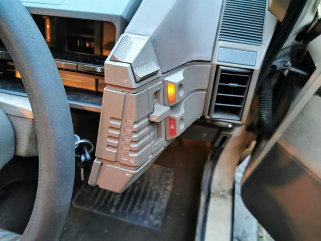

Question for those of you who know these cars better than me...How do you get into these switches to change the lamps?
The one in the hazard light switch is dead...Rear window heater one works nicely though. Likewise and tips on getting the instrument panel out? Given how much of a reputation these cars have for brittle plastics I'm guessing "carefully" is high on the list.
