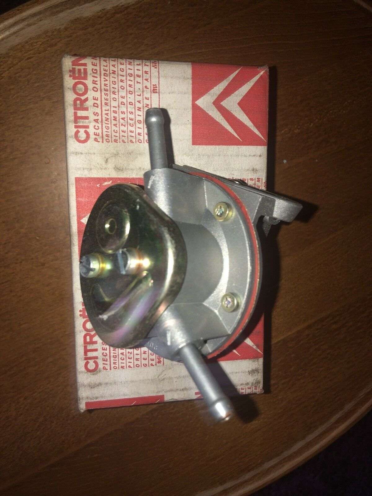

Annoyingly today I had barely any time to look at the cars, though I did drop the last two instruments into their holder on the Invacar when they arrived. Not wired up yet, but they look far better than the cheap modern tat I had previously in there.
Yes I'll clean all the finger prints off once the wiring has been done. I'll need to pull them out again to so that so it would be pointless doing it now.
Location seems a good blend between out of the way and clearly visible.
My garage is about a worst case scenario where reflections are concerned because of the lighting. If I have issues with that on the road I can adjust the angle of the bracket a bit as required.
Once I was finally released from my boring actual responsibilities I really was only left with just over half an hour of usable daylight to look at the BX. Based on yesterday's testing first task was to remove the fuel pump.
Pretty trivial to get to, all of those coolant lines nearby have enough give that you can push them out of the way as needed.
Five minutes later we had the pump off and in bits on the workbench.
Not too dirty actually. The diaphragm isn't as supple as I'd like but I've seen far worse still working. I couldn't actually find any cracks or pinholes in it.
After it was cleaned and put back into the car...absolutely nothing changed.
Best I can tell one of the valves is damaged or the diaphragm has a pinhole I can't detect. It just doesn't seem to be able to generate any decent pressure. I've checked again and can get a solid flow of fuel from the tank under vacuum, so this pump looks to be to blame.
I did note that the oil smells quite strongly of petrol, I had put that down initially to the reported miss and lack of a decent run in forever, but if the pump has been leaking internally that could also explain it.
If I'm not mistaken This looks to be the right part even though the body design is slightly different.

Is your fuel pump the same as this gen-u-wine Citroen one on Fleabay ?
https://www.ebay.co.uk/itm/Citroen-BX-1 ... 1909488000
Edit - cheaper non-genuine one for £18.05 if you get in before close of business tonight ?
https://www.ebay.co.uk/itm/Fuel-Pump-fi ... 3844305997

That's the one.bobins wrote: 19 Feb 2021, 20:42 Is your fuel pump the same as this gen-u-wine Citroen one on Fleabay ?
Have gone for the third party one for now - I've not had great luck with NOS things involving diaphragms in the past so figured we'd try this first.
