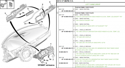

Xantippa wrote: 16 May 2014, 10:59 I´ve ordered that 16069478ZD from citroen-accessories.com to a friend of mine, and it had 88mm high opening. I thought there is some newer model too. This 16069478ZD isn´t the original part number though. I think sellers are selling old ones with new part-number because they don´t understand there´s a difference on these panels.
We tried to order this, which is the older model I think, but it wasn´t available in last year: http://www.citroen-accessories.com/home ... 069-4.html" onclick="window.open(this.href);return false;
As far as I can tell looking through some VIN codes on service.citroen.com the correct part number for the RNEG2 RT6 DG4 screen-compatible DASHBOARD PANEL (94mm height, left-handed drive) is: (8231 06) RP 16069484ZD
88mm height opening 16069478ZD dashboard panel is indeed for the RT4 screen, which is what I have right now.
- x 6955
Re: C5 X7 2-in-1 navigation tutorial
None of those are C5 X7 screen part numbers I'm afraid. You're probably looking at another vehicle....
Available screens for the X7:
Click to Zoom Note LE-2013 options have now also been replaced with 9804707380.
lkraav
- Posts: 32
- Joined: 29 May 2018, 20:59
- x 2
GiveMeABreak wrote: 07 Jun 2018, 16:41 None of those are C5 X7 screen part numbers I'm afraid. You're probably looking at another vehicle....
Yikes, I missed specifying that I was replying to "finding the bigger screen opening dashboard panel" problem. Made the edit now.
- x 6955
That makes more sense!
Click to Zoom
Click to Zoom
lkraav
- Posts: 32
- x 2
Thanks, ^^^^ is exactly right and also confirms what I thought I saw. My service.citroen.com view seems to be somewhat less detailed, or maybe I don't know how to use that website yet (it is literally the worst website UX I've seen in years, lol).
My ebay screen supplier happened to "miss" sending me the screen-unit connection cable(s). After some ebay messaging, he agreed to send them over. But just in case, Marc what's your take on what the cable(s) part number(s) should be?
Is it just 6574KZ that's required to connect RT6 to DG4?
6574LA USB connector cable would also be nice to have...

- x 6955
What's your VIN? - as parts changed throughout production and I'll have a look.
- x 6955
6574KZ is for the NG4 Navidrive 3D connection not the RT6. You need 659366 for the RT6 to Screen connection - however my information suggests it may be the same cable for the RNEG systems (i.e. MyWay or eMyway / RT6).
Again that USB cable is for the NG4 Navidrive 3D system.
- x 6955
Ok, have your VIN and confirmed the screen cable is the same for both units, so you won't need to change that.
