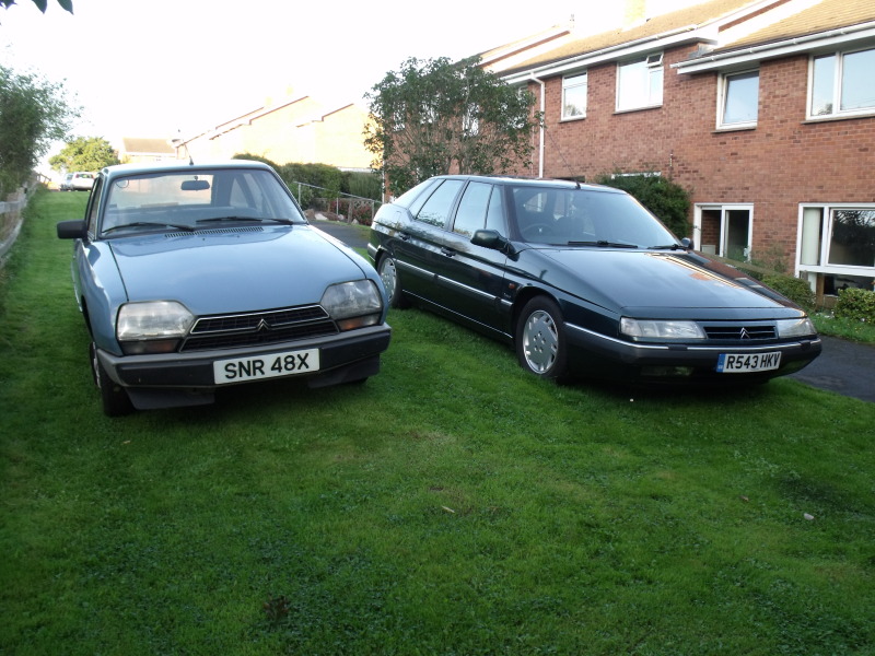

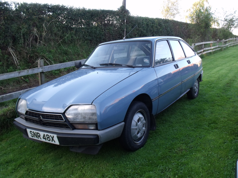

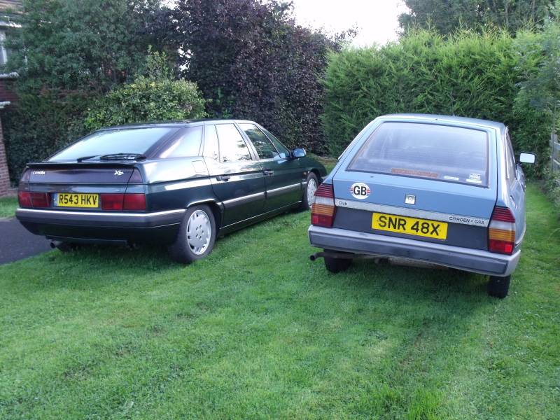

Annabelle arrived this afternoon via a very helpful local Citroen nut with a car transporter trailer :D
Here's Samantha the XM introducing herself to Annabelle:
This photo was taken a good 20 minutes later, neither of them have moved so I assume they're getting on well :)
