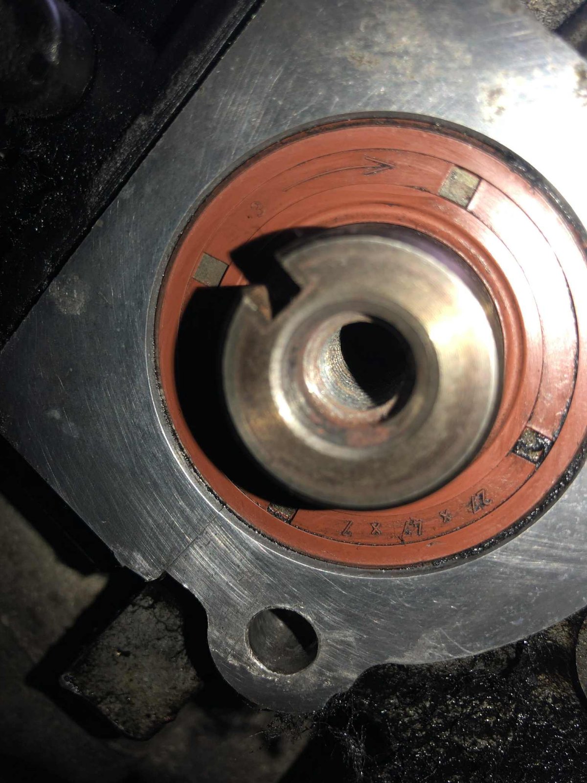

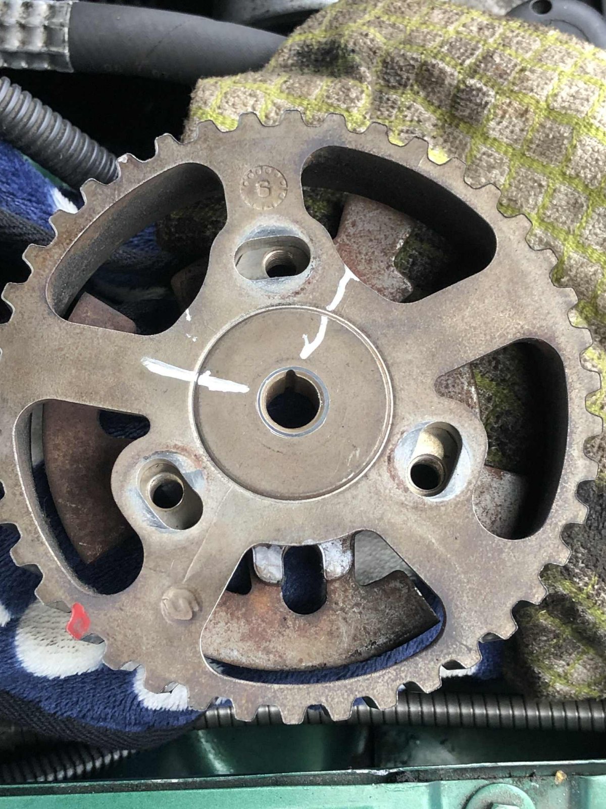

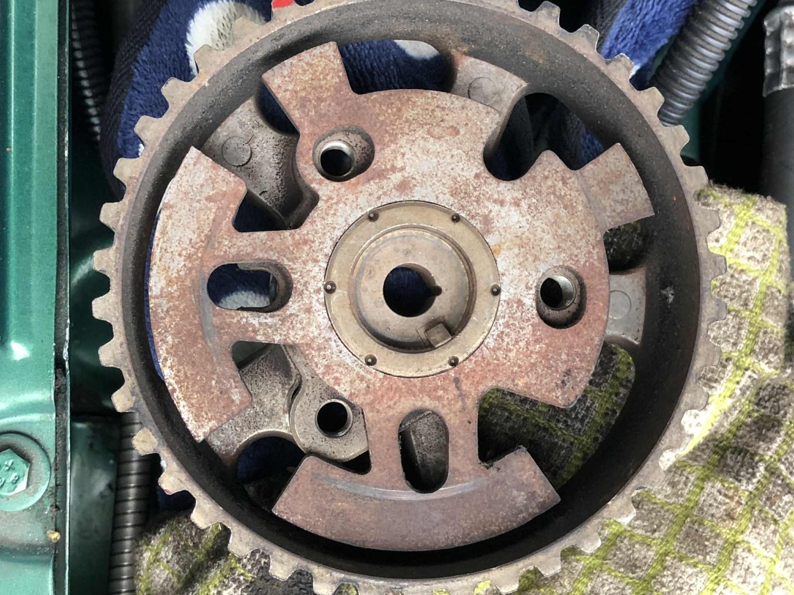

Well the Camshaft Sprocket and Hub have been removed today.
Skull's - Removed for Woodruff Key Inspection
Skull's - Rear of Camshaft Sprocket & Hub
^ The 'Woodruff Key' but not as we know it Jim (more of locating lug) intact. Looks to be all one piece to my naked eye, but on the photos looks seperate - tight at least and undamaged. ?

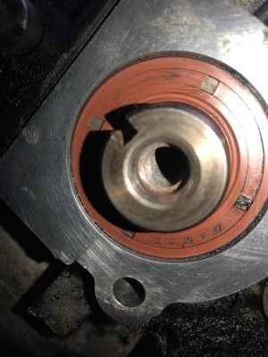

Skull's - Camshaft slot for lug
Camshaft slot to allow correct position of Hub.
Interestingly but unrelated to the current problem, looking at the various red paint marks on the engine and sprockets, at least the Cam Sproket has been off the Hub before I got the car (in 2015) as if I rotate the sproket 1 bolt hole I believe it will line up with the red dot on the cam cover on assembly. I never used those marks when I done my belt change in 2021.

Sorry for asking this , if its already been done (sorry) is the head gasket ok ?

Worth checking and you get to see the oil seal condition too.
:-D

Middle photos of the sprocket it has scrape marks on 2 sections, could it be possible that its been touching somewhere ,,then moving backwards the shaft itself is or has that been hit or warped ever so slightly? Just a niggle , hope I'm wrong
:-D

Huskyxantia wrote: 16 Nov 2025, 07:17 Middle photos of the sprocket it has scrape marks on 2 sections, could it be possible that its been touching somewhere ,,then moving backwards the shaft itself is or has that been hit or warped ever so slightly? Just a niggle , hope I'm wrong
Good spot but that's historic I would imagine. It would surely be shiny if caught recently. Worth a closer inspection though for sure.

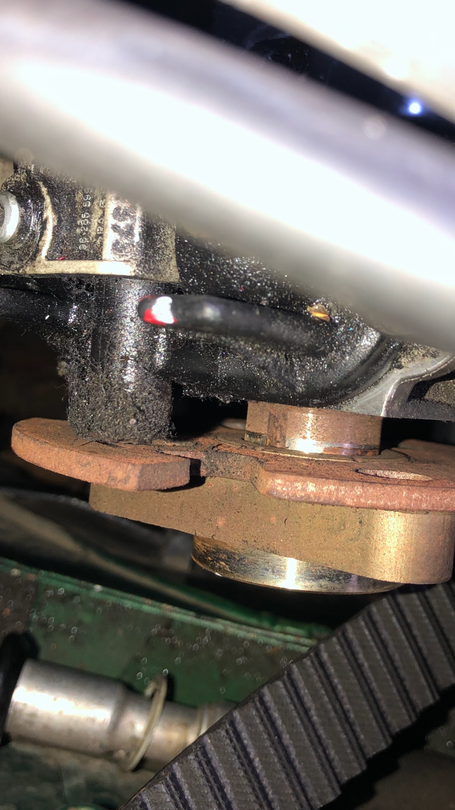

Yes I saw that and just thought it was very minor rubbing at some stage from either the cam cover nose or the engine lip. [EDIT] That’s the Cam Position Sensor (cam cover ‘nose’)
Skull’s - Cam Hub partially removed
I’m not concerned about it though HuskyXantia - I have bigger problems …

Rhothgar wrote: 16 Nov 2025, 09:42 Good spot but that's historic I would imagine. It would surely be shiny if caught recently. Worth a closer inspection though for sure.
Maybe that’s why the Cam Sprocket was rotated, that would explain why the old ‘red’ timing marks prior to my ownership were out of line - possibly, as mentioned above it has been off for some reason.

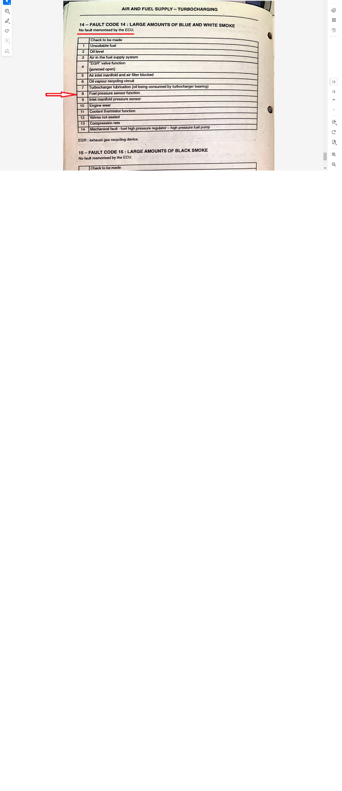

Rothgar sent me some pages from his Citroen Diagnosis Manual....
Am I enterpreting this right in that the ECU may not or does not remember these faults :?:
Jim thought as there was no temporary fault listed for the Fuel Pressure Sensor that my theory about the coolant shorting the connector out was wrong.
Where / How do you get the Fault Code 14 from then?
Rothgar's - FAULT DIAGNOSIS
^Sorry about the size of this ^
Gary

Skull wrote: 16 Nov 2025, 10:48 Rothgar sent me some pages from his Citroen Diagnosis Manual....
Do you not get them from here:-
or perhaps they are Elit or Proxia codes? Jim may well know.
Yes. You are interpreting it right. The ECU may not memorise a code. Don't ask me how. Maybe if there is no communication with the ECU at time of event would result in no code being stored. So my question would then be where else are they stored if not in the ECU? Very probably a chip in the dash perhaps?
