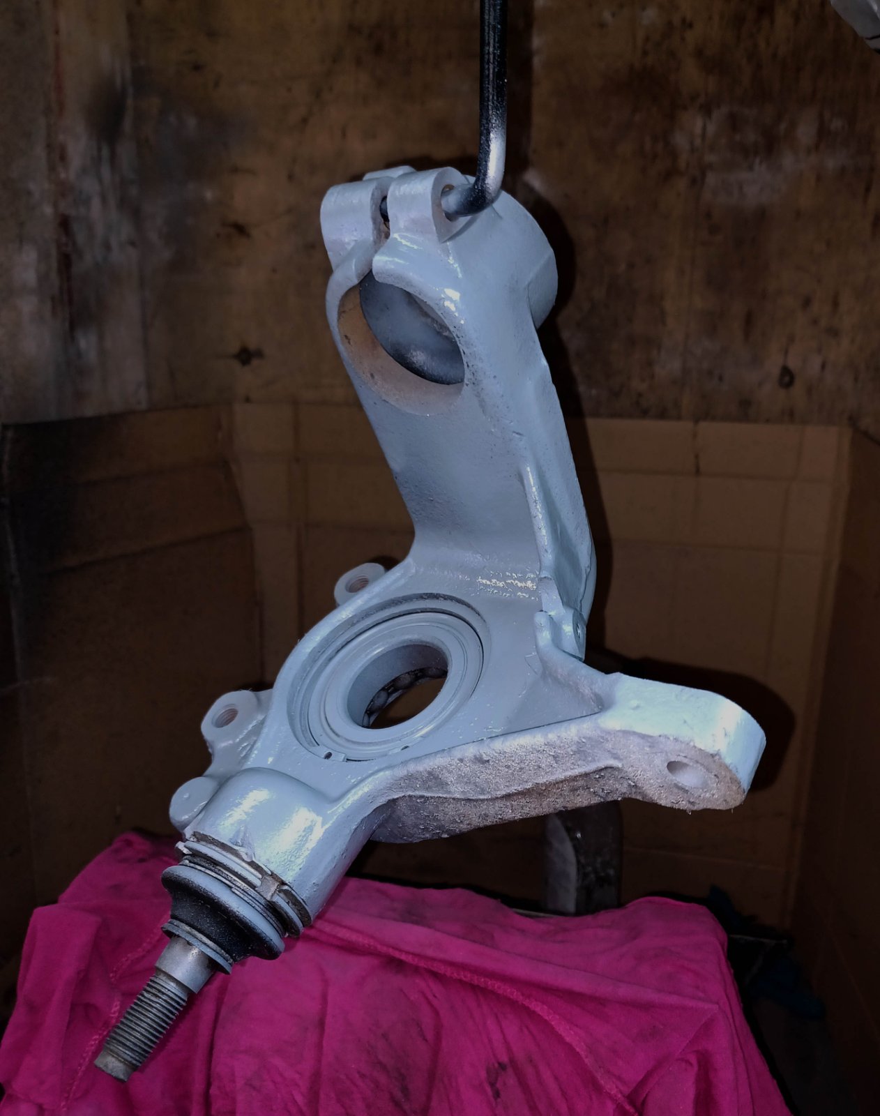

Attacking the very very loud front-RH wheel bearing............hub carrier off, cleaned and primed ready for a new bearing to be pressed in (when it arrives).

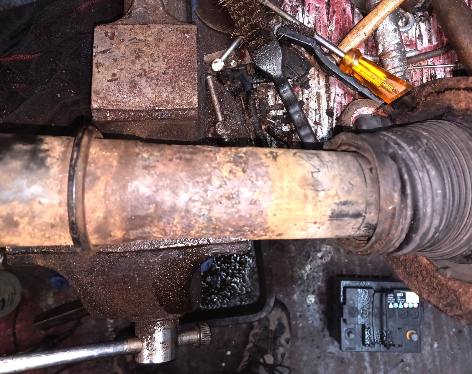

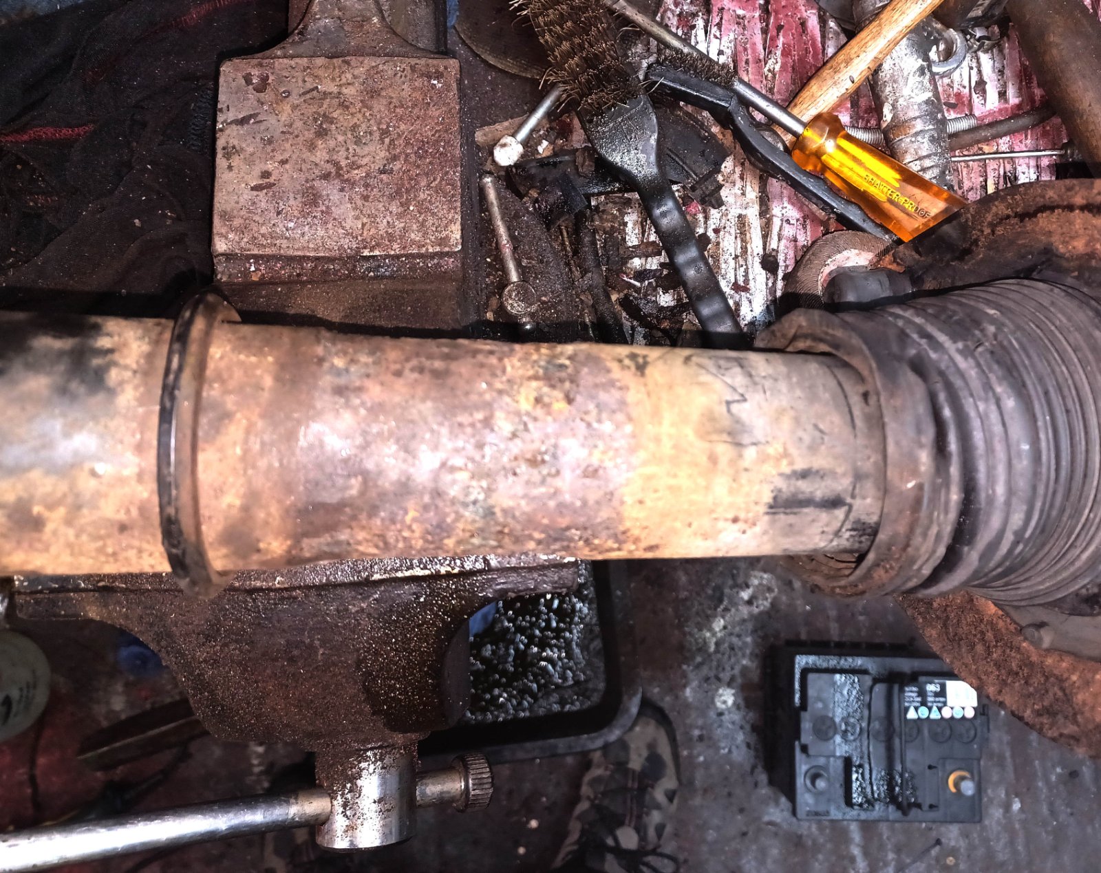

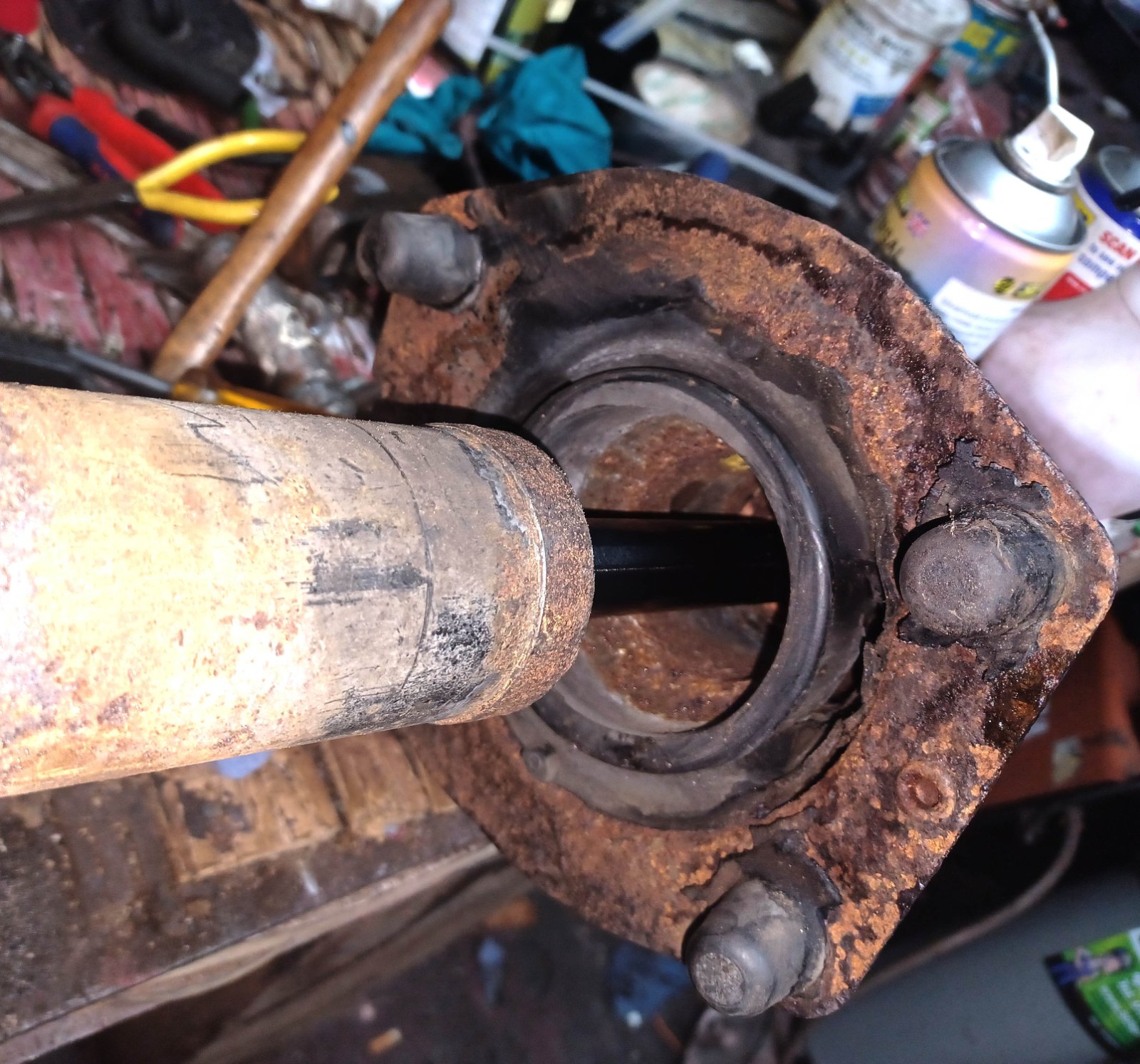

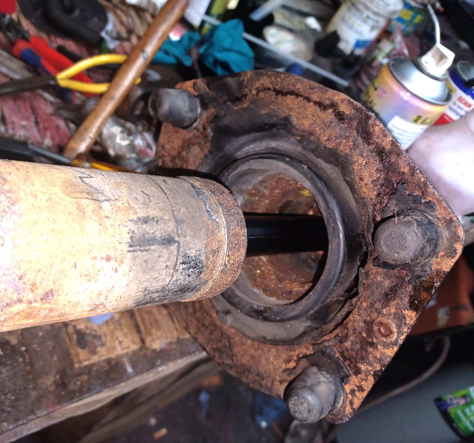

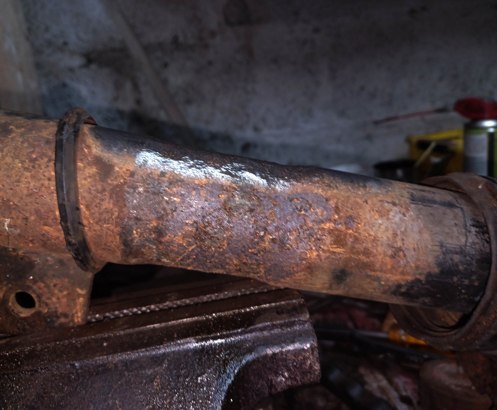

Well.....that is an "interesting" discovery !....bugger, but not really a surprise on a 30 year old Xantia.
Note the corrosion "waisting" on the strut body caused by a split gaiter and the subsecant build-up of crap inside.

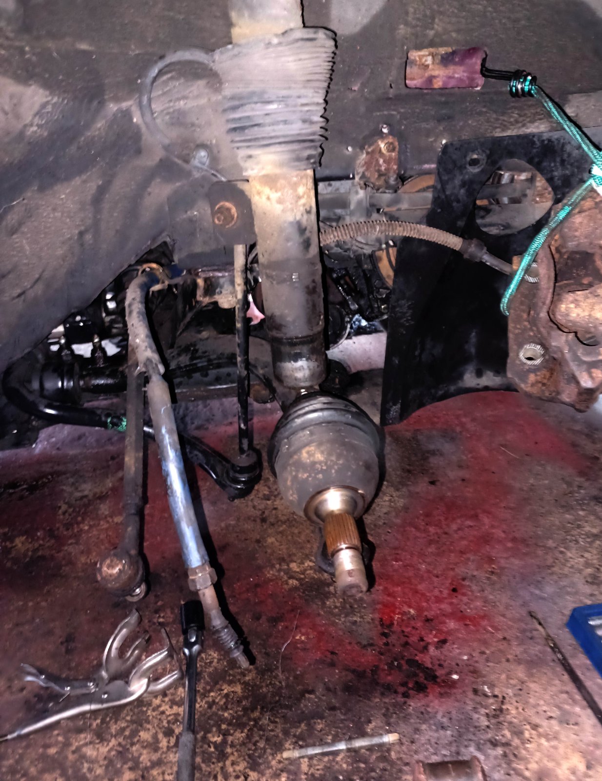

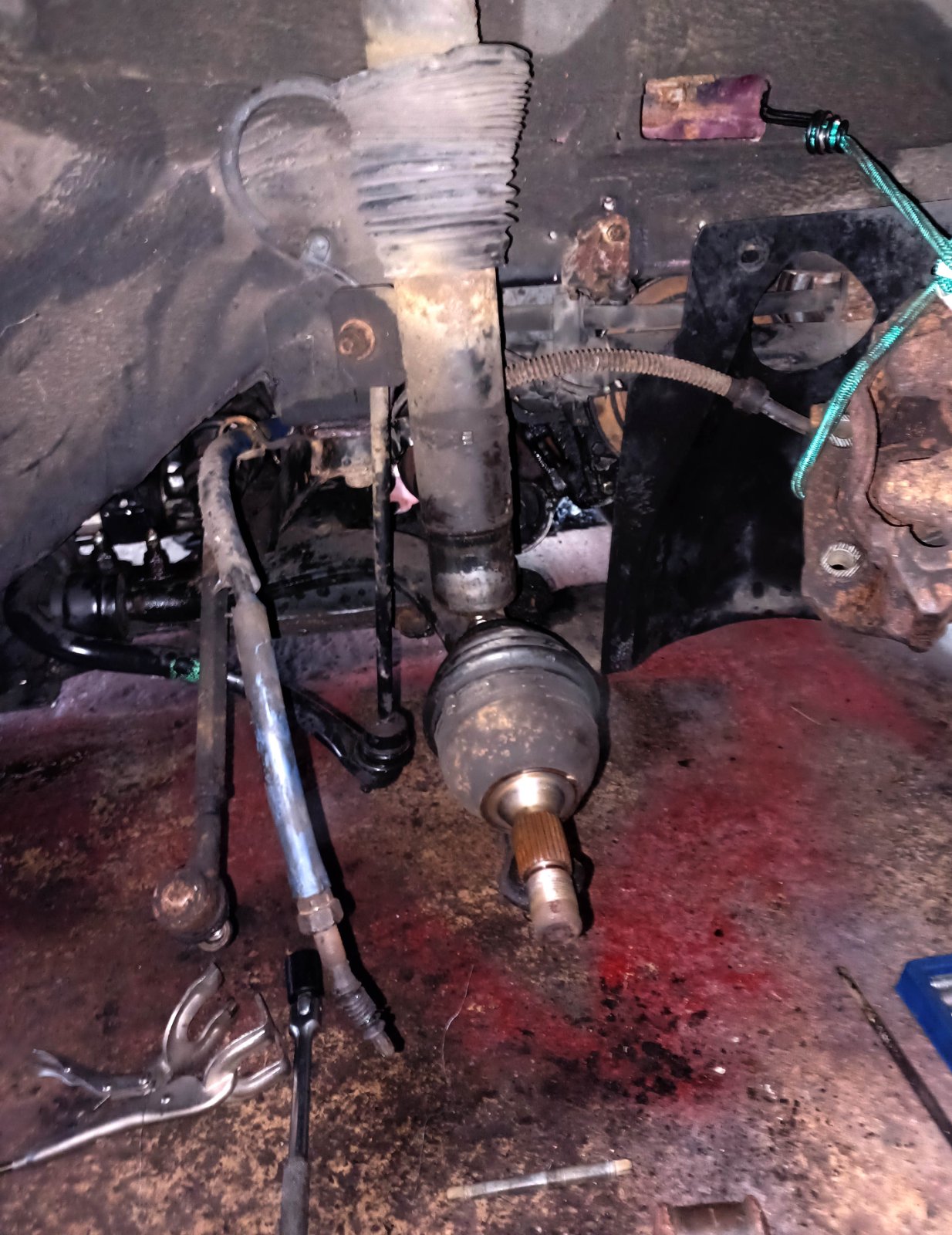

I also have to remove the steering rack to replace the gaiters on that as they all need doing.
I think it will be quicker to remove it whole rather than my normal "struggle" method.
The car being so simple...vrs the v.6 Activa.... will help a LOT and make it a somewhat easier job to do as access is so much better (or not impossible without removing the engine :) )
