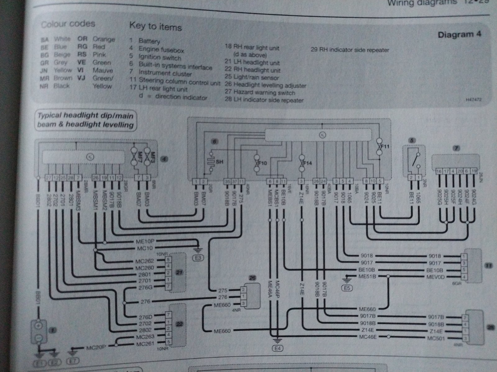

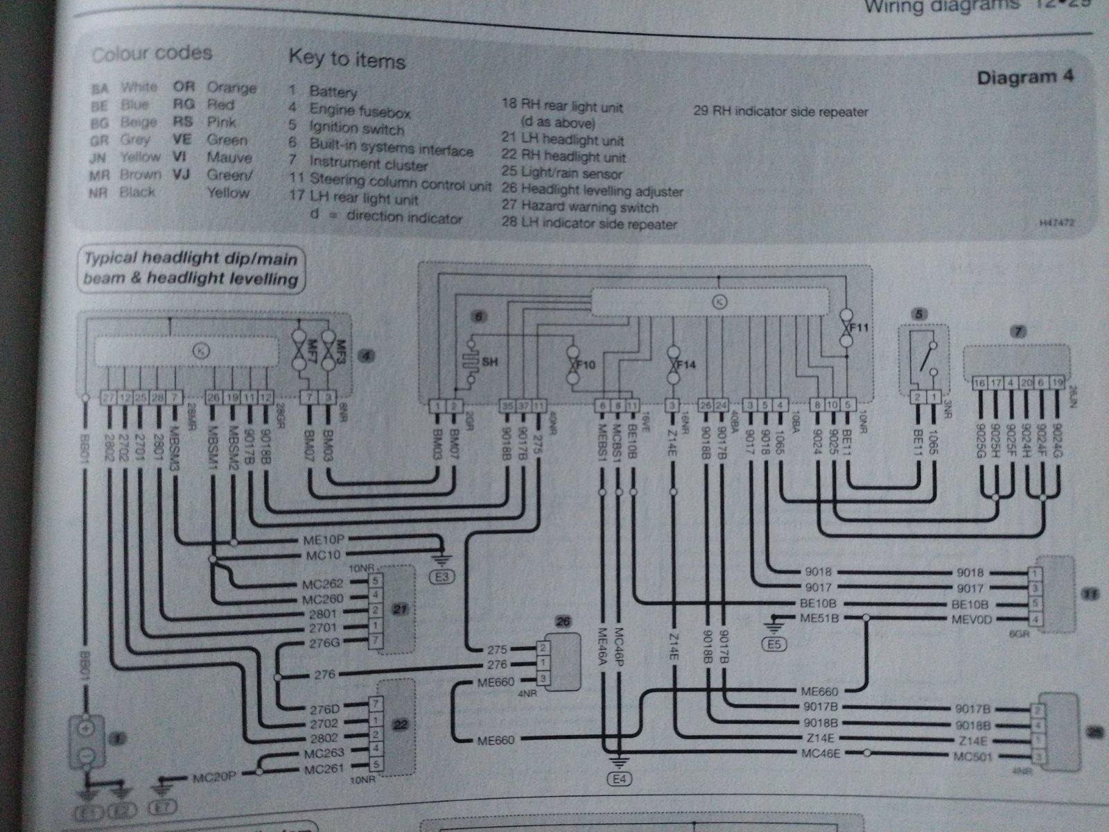

Huskyxantia wrote: 24 Jan 2024, 15:52 Need to know what wires are to what lights on the front head lamps.. any one ?
On the 308?
I can have a look what wiring diagrams are included in the Haynes for it if that helps?

From the Haynes Peugeot 308 manual Number 5561**
Headlights
Headlights
** which is my first encounter with the newer paperback type Haynes = don't like it at all! Not sure quite how much saving was realised by omitting two bits of thick card!

I to didnt like the new paper back versions , thanks for this Matt very useful, im hoping to do a small upgrade to my 308 headlights.

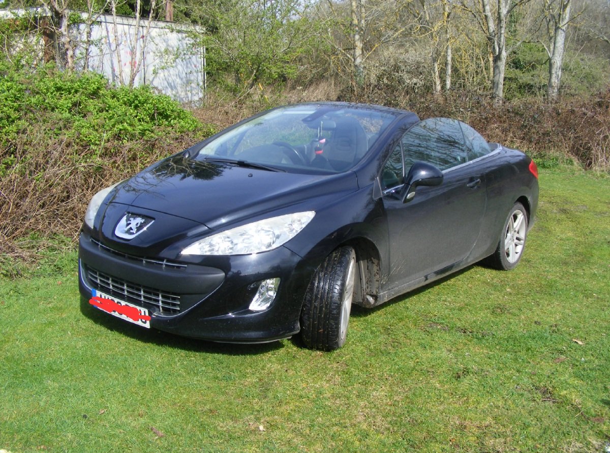

Needs a wash

Ha ha, my C5 is similar poor grubby thing. I'm trying not to even think about washing it as seems to summon rain clouds even just the thought!
