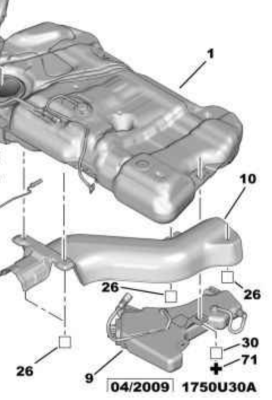

Not mentioned as yet, but will attempt to top up DPF additive tank at the weekend, have the rest of the stuff bought for the 308 SW, which "suits all 4 types of DPF".
It thinks there is "666.2" ml in there, we shall see!

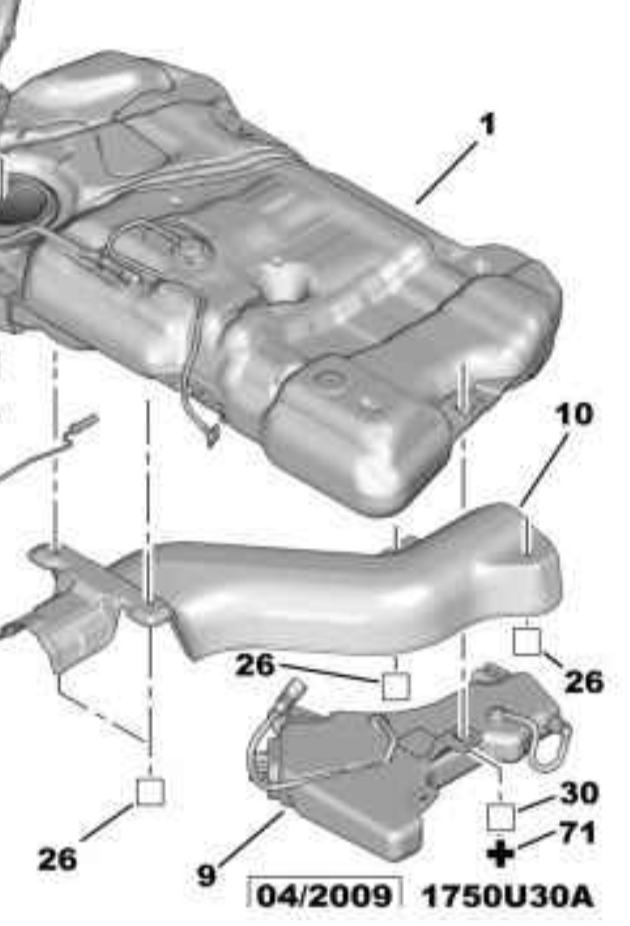

Huskyxantia wrote: 03 Apr 2024, 09:49 666.2 or a split pouch, did a 207 last year it said ther was over 500 till i dropped the cover of the tank , wearing 2 pairs of gloves , nice thick treackle everywhere , split pouch sort of still half full .
If the parts Asia site is correct, then thankfully it's a proper tank rather than a silly, vulnerable pouch.
From parts Asia
From parts Asia
Link, contender for longest URL I've ever seen!?
Spoiler: show
https://catalogs.ssg.asia/citroen/?lang ... BwbGllcj09
Edit, seems the forum automatically shortened it, here it is without the first bit, just for entertainment purposes!
Catalogs. ssg. asia/ citroen/?lang=en# c3Q9PTgwfHxzdHM9PXsiMTAiOiJNb2RlbCIsIjIwIjoiQzUgKHg3KSIsIjQwIjoiQm9keTogNSBET09SIEVTVEFURSBcLyBFbmdpbmU6IDIuMiBIRGkgcGFydGljbGUgZW1pc3Npb24gZmlsdGVyIDE3NSIsIjUwIjoibWVjaGFuaWNhbCIsIjcwIjoiYWlyIGFuZCBmdWVsIHN1cHBseSIsIjgwIjoiRlVFTCBUQU5LIEZVRUwgR0FVR0UifXx8Y29kZT09MUNYN3x8Ym9keT09QjBEQzV8fGVuZ2luZT09QjBGSjB8fGNhdF9pZD09RkNUMDAwMXx8c3ViR3JwX2lkPT1GQ1QwMDEwfHxyZWZkb2NzPT0wNjEwMDYxNzUwMzBBfHxyZWZkb2M9PTA2MTAwNjE3NTAzMEF8fHN1YkdycE5hbWU9PUZVRUwgVEFOSyBGVUVMIEdBVUdFfHxzdXBwbGllcj09
Part number ( 1500 NK ) brings up the tank on eBay,
Description 3/10 for accuracy here:

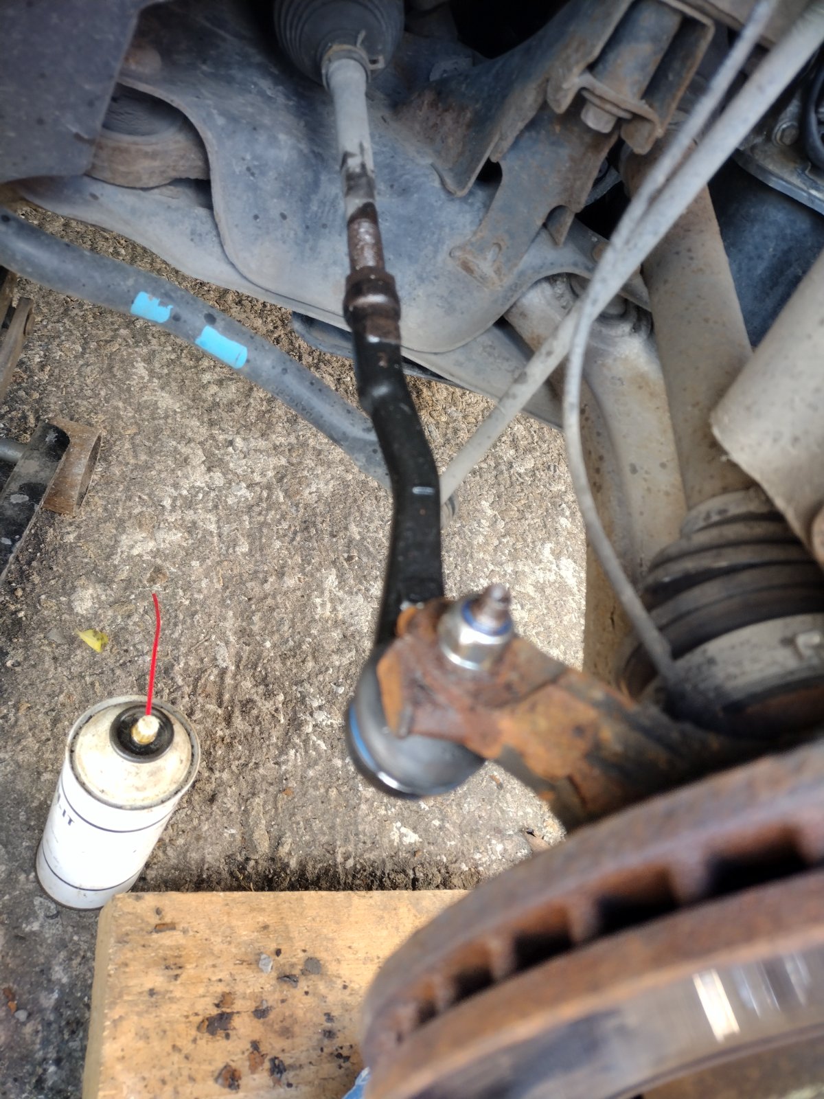

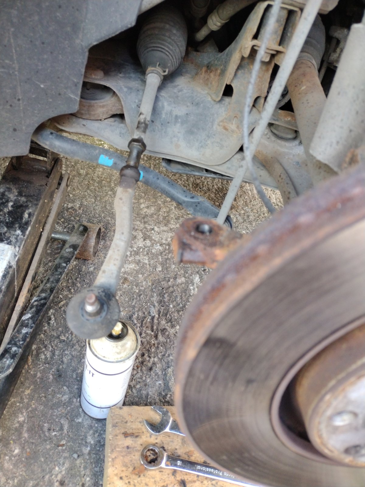

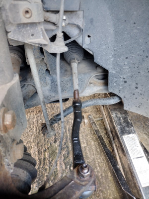

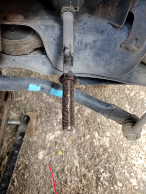

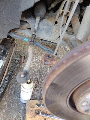

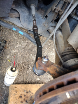

Brief update, some pictures and add the words on later
Wonky track rod end detached from hub.

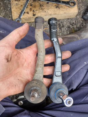

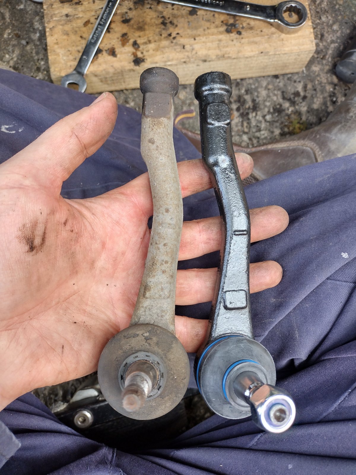

Old and new. Flats (inline with my thumb) suit a 19mm spanner which is handy

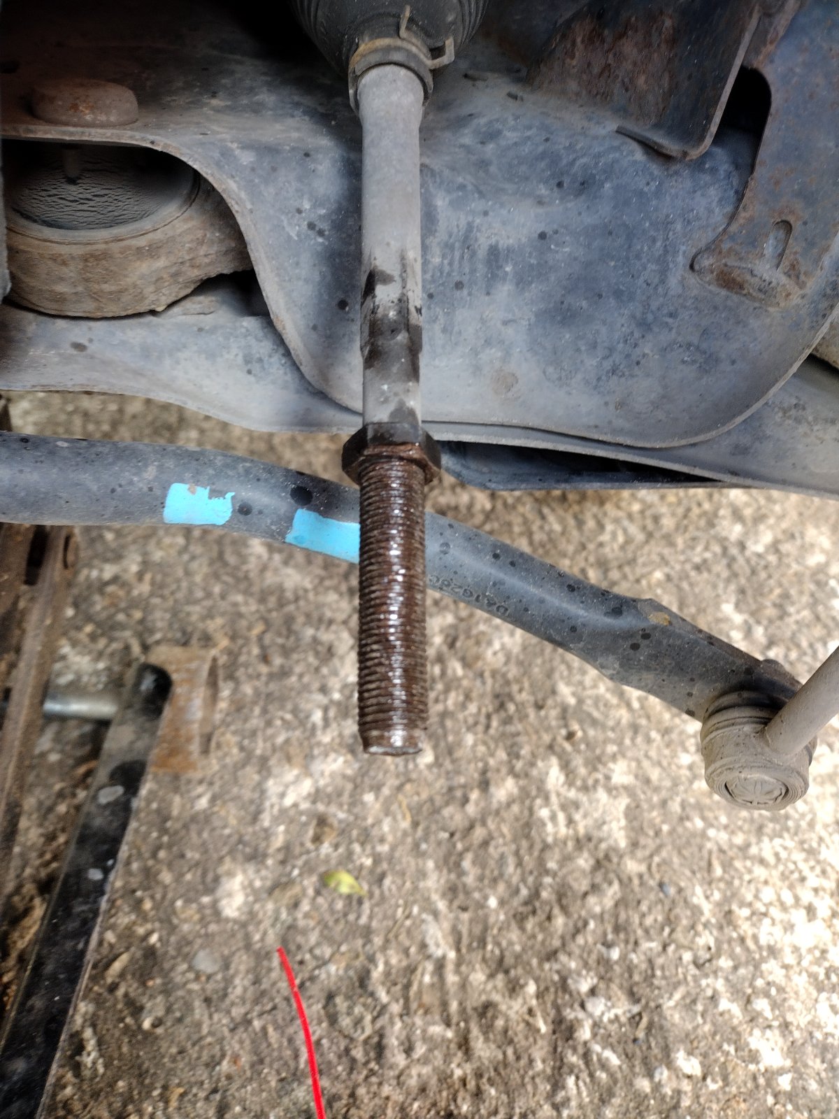

Track rod, liberal copper grease

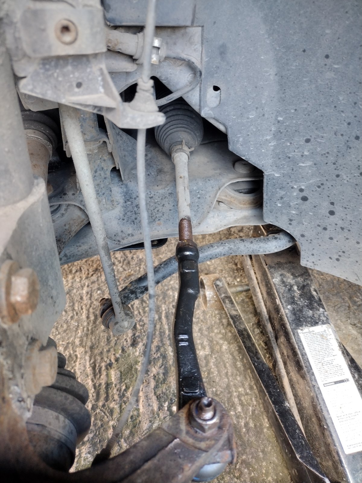

Driver's (right) side completed
A left hand side changed too (seemed ok for play)
Track rod end lock nut: 19mm
Track rod end itself has 19mm flats to allow you to grip it (great idea!)
Inner track rod has 13mm hex beyond the threads.
Track rod end cone nut (hub end) is M10 fine thread Nyloc. Original (with the weird plastic washer thing) is 16mm, replacement is 17mm

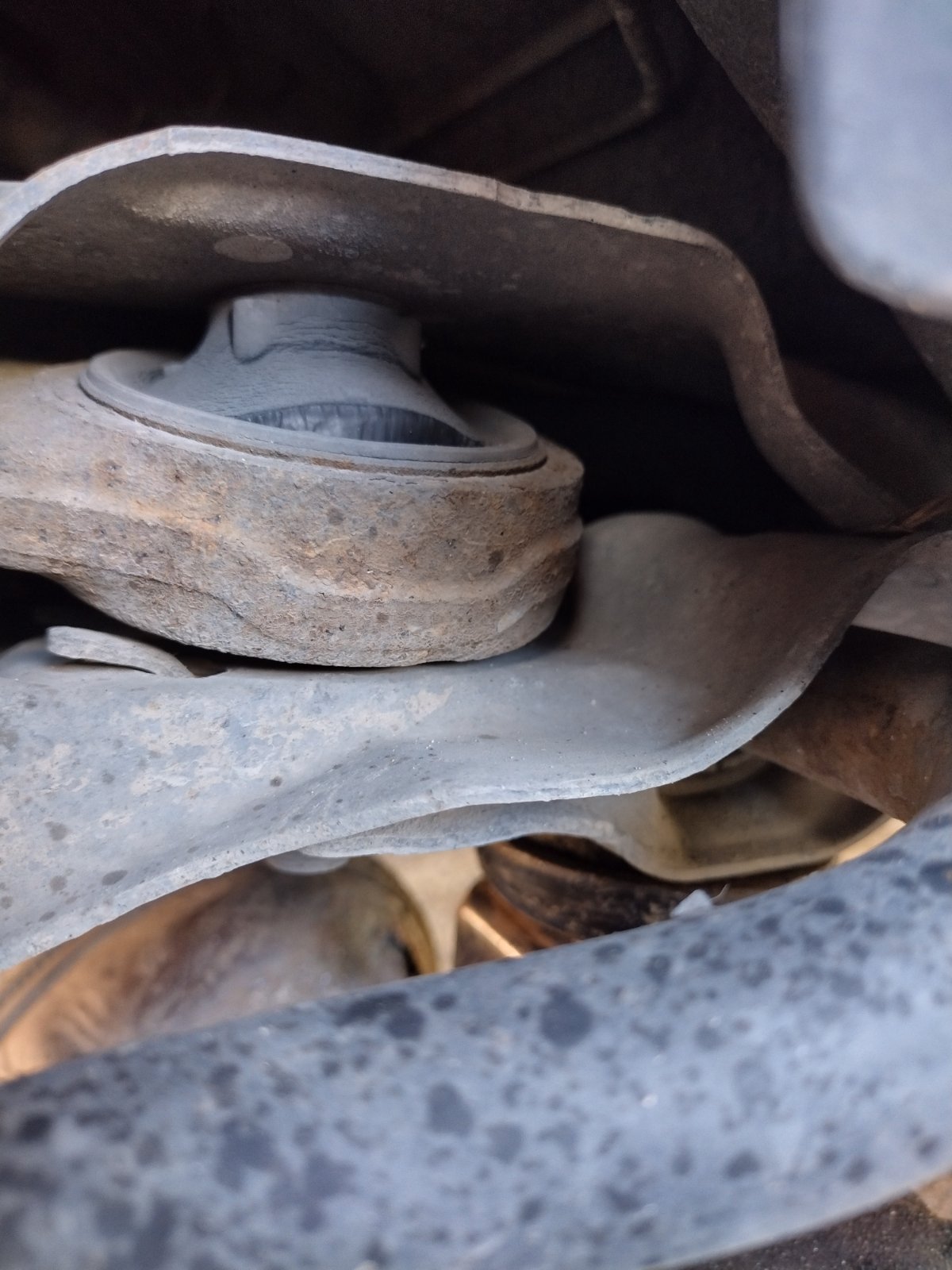

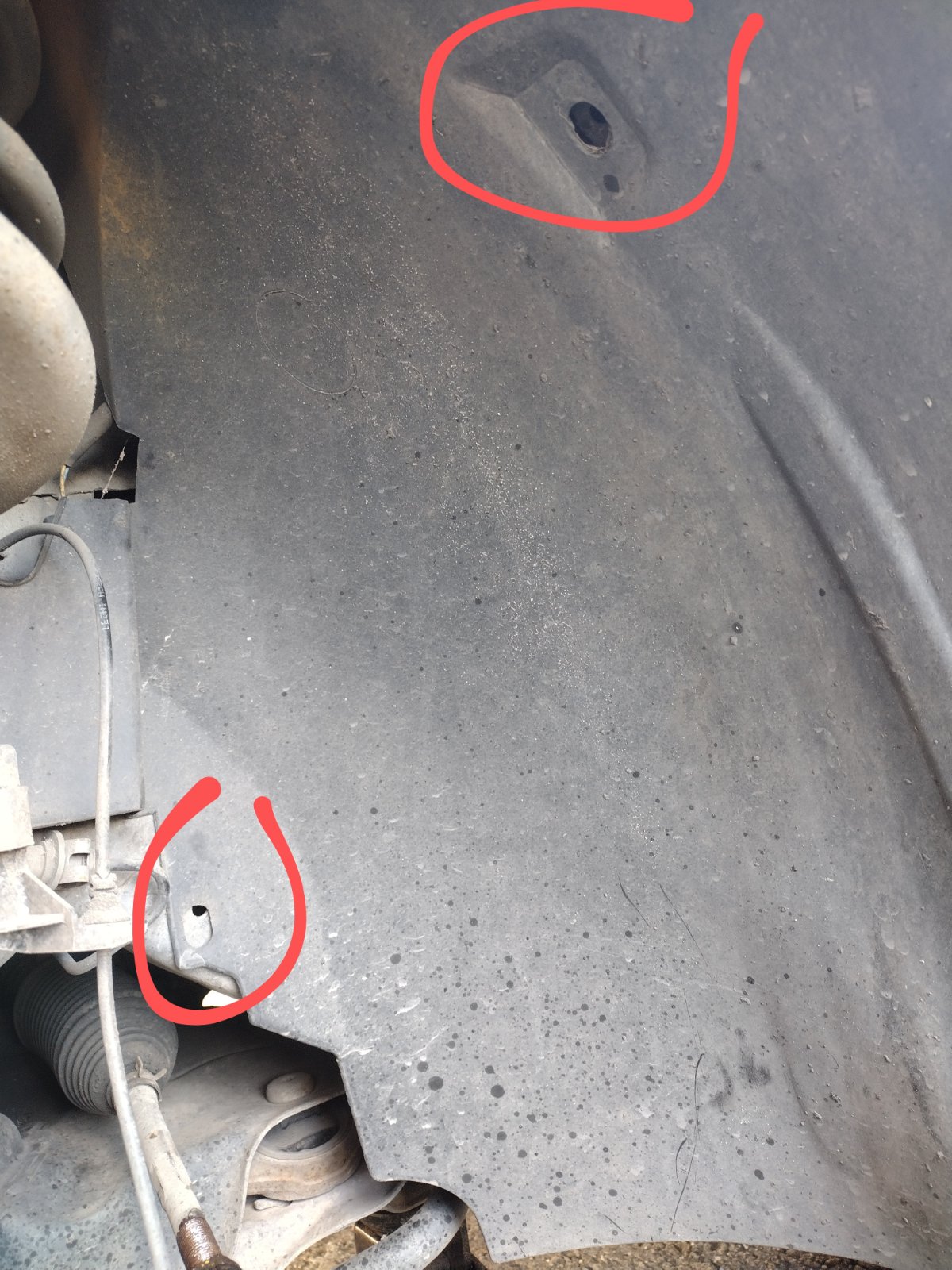

Couple of arch liner fastening positions devoid of clips

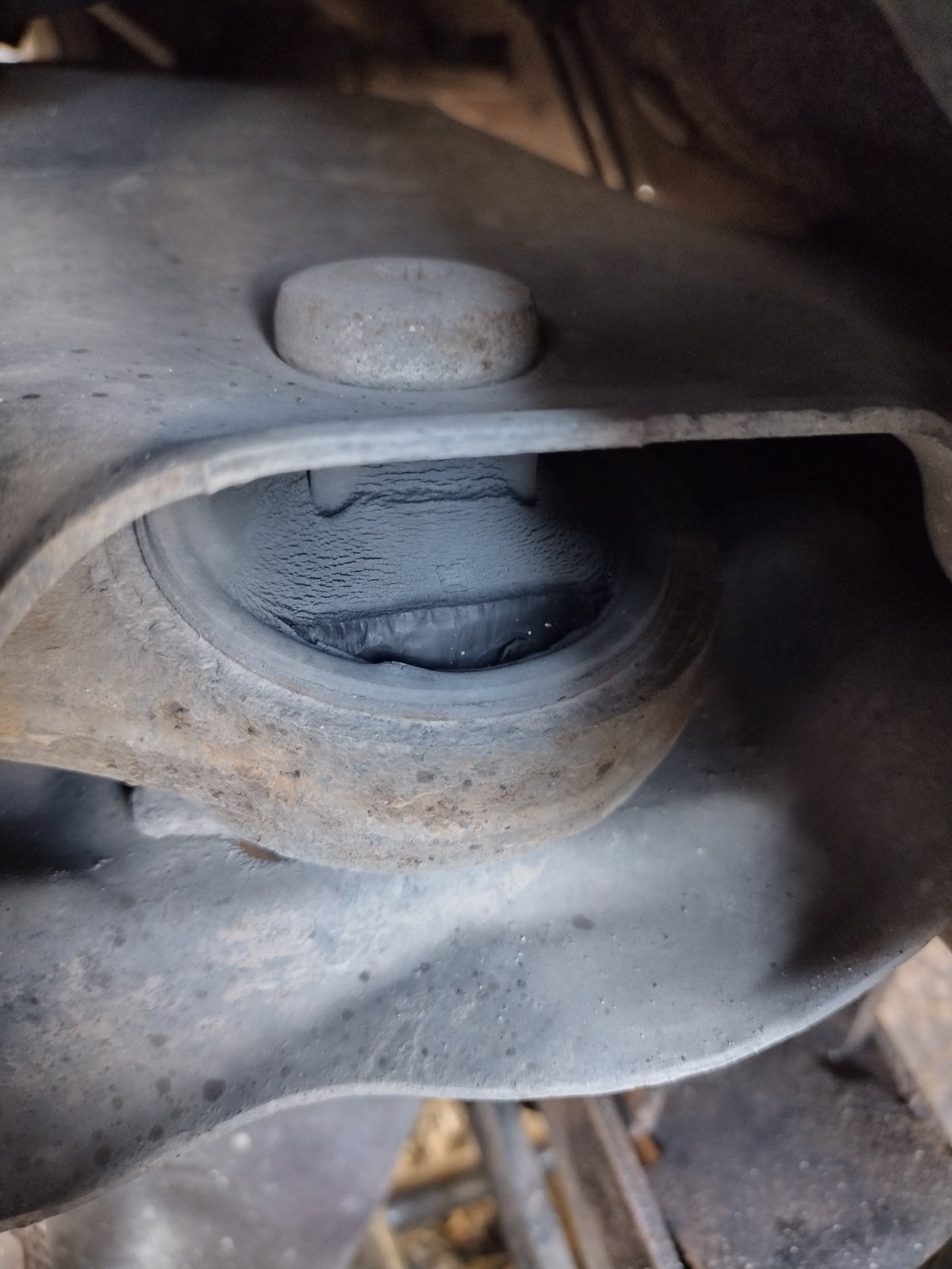

Not happy with the look of this bush:
Another angle of view
Front Wishbone, rear bush, front left

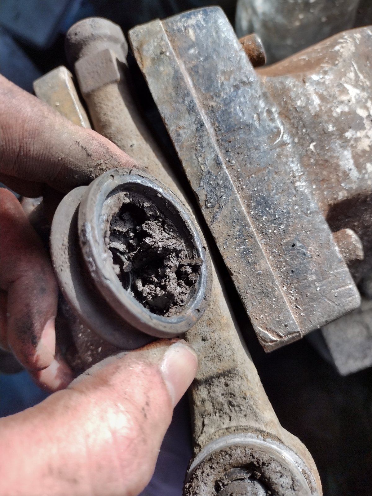

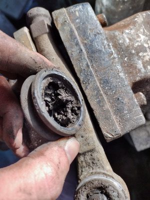

Just for interest, I took the (intact and good condition) rubber boots off the old track rod ends. This is what counted for grease in the failed joint!
Mud? Or at least Crud!
