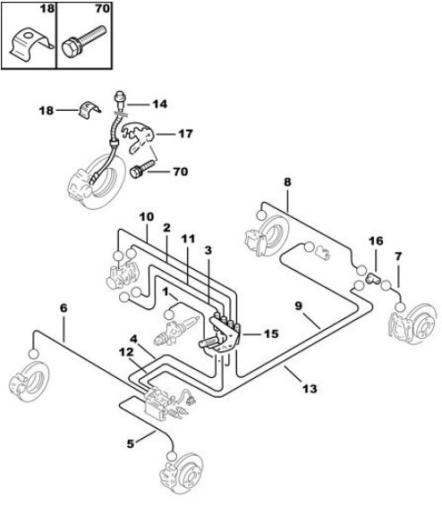

Rhothgar wrote: 27 Mar 2023, 17:05 Cheers Marc.
There appear to be SIX pipes but hard to tell without further stripping.
Parts 1, 3, 11, 2 and 10 please.
(1) Hydraulic Pipe (DIAM 3,5 L=170), part: 488501 NFP
(2) Hydraulic Pipe (DIAM 3,5 L=926), part: 488502 NFP
(3) Hydraulic Pipe (DIAM 3,5 L=1001), part: 488503 NFP
(10) Hydraulic Pipe (DIAM 3,5 L=882), part: 488506 NFP
(11) Hydraulic Pipe (DIAM 3,5 L=748) part: 488507 NFP
NFP: No longer Available

Thanks Marc. Oh dear. It looks like they will need to be made up.
Gone down another rabbit hole as Jim has informed me that there is a rubber return from the doseur valve.
However, I cannot make any sense of the orientation of the brake returns you kindly provided. Just awaiting on Jim to confirm which part number he thinks they are as they look like LHD to me. I always thought that the fiches were correct orientation but there is nothing on those that looks like a return from the doseur running along the line of the bulkhead.

Afternoon Marc.
Could I have the fiche for the rear braking circuit and in particular the availability of, what I think is the braking offside brake pipe please?
Either way it is the one with the coils in.
x 6946
I've already provided those here on your other thread Roger: viewtopic.php?p=749957#p749957.

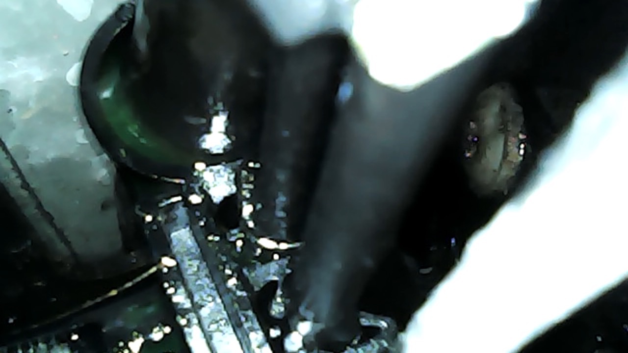

Rhothgar wrote: 27 Mar 2023, 19:08 Cheers Jim.
Invaluable advice.
Now using my mate’s borescope. I can see what appears to be green blood accumulating on a bulkhead clip. It’s SO damned difficult to manoeuvre around.
Whereabouts exactly are you looking Roger? Give me an exact location where you have poked the boroscope and I may be able to help pin-pointy likely suspects...

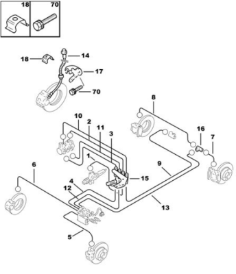

GiveMeABreak wrote: 28 Mar 2023, 15:43 I've already provided those here on your other thread Roger: viewtopic.php?p=749957#p749957.
I’m going daft I think. I’m expecting the diagrams to look something like. I’m sure they used to be more representative not diagrammatic.
In that case, it is pipe 8. Could I have the data for it please ie part number, diameter and length? If I cannot get one NOS. Then I will have to make one.

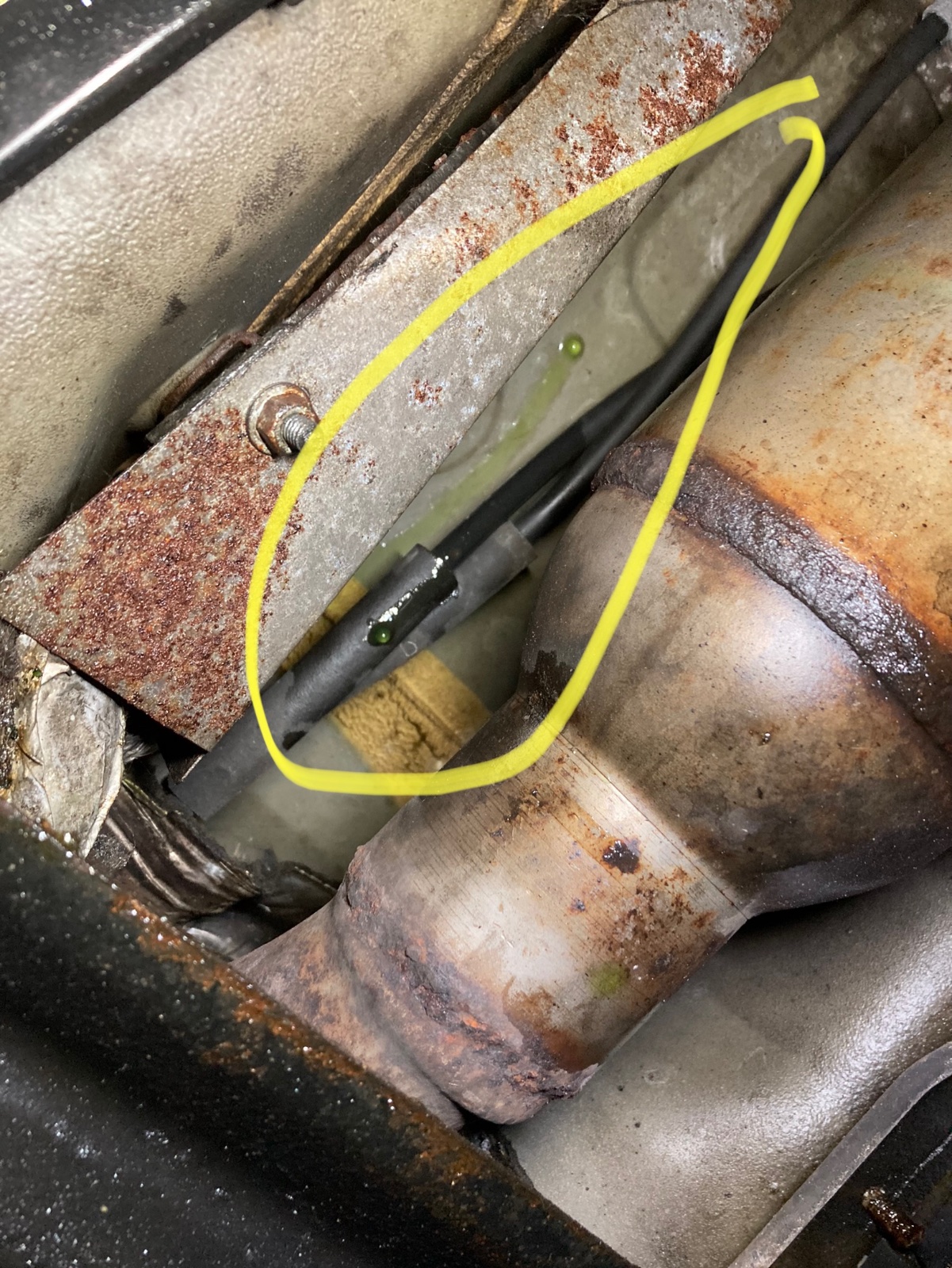

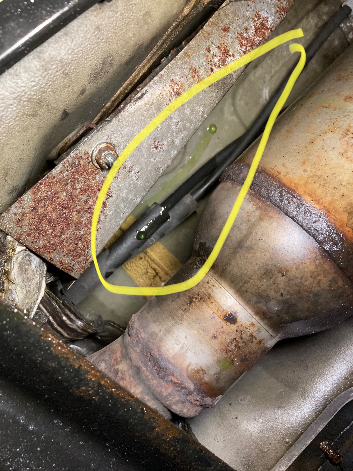

Rhothgar wrote: 27 Mar 2023, 14:24 Image
No expert or indeed direct experience of Xantia, but is gear cables looking to be inside the exhaust heat shield (just spotted with brown rust and secured with a nut on a stud in that picture) normal routing?
Seems very close to exhaust indeed!
Gear cables run above heat shield on my similar but admittedly different 406 Coupe (EW10J4 petrol - but catalyst seems to be in similar position and gets rather hot petrol or diesel)
Posts: 55151
x 8422
Re: Hydraulic Leak 2.0HDi Xantia - STUPID QUESTION
MattBLancs wrote: 28 Mar 2023, 16:04 Seems very close to exhaust indeed!
Well spotted Matt! These look more like the handbrake cables to me. The gear cables being a bit chunkier...
Both should be the other side of the heatshield... Looks like the cables may have been swapped without due care. As I recall, if it is the handbrake cables there's no need to remove exhaust or shield, just release its star clips and pull it out of the way where needed... It does not need to be pulled far...
I'd be very tempted to re-route them properly as soon as possible...

Roger, as Mystic Meg is on holiday :-D , can you please tell me which diagram you are referring to in the thread linked above as I have provided quite a few and I have already provided Header names for each of them? Better still, locate the relevant post in that thread and quote the post where I have provided the diagram, so I know which number (8). :wink:

CitroJim wrote: 28 Mar 2023, 16:10
They’re fine. It’s an optical illusion. They sit a good 2-3” above the exhaust.
Never been touched from memory since I have had the car (10 years).

GiveMeABreak wrote: 28 Mar 2023, 16:11 Roger, as Mystic Meg is on holiday :-D , can you please tell me which diagram you are referring to in the thread linked above as I have provided quite a few and I have already provided Header names for each of them? Better still, locate the relevant post in that thread and quote the post where I have provided the diagram, so I know which number (8). :wink:
Sorry Marc but I don’t know how to link to a specific post. It was yours from yesterday at 15:31 entitled Brake Piping 😁
