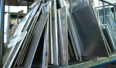

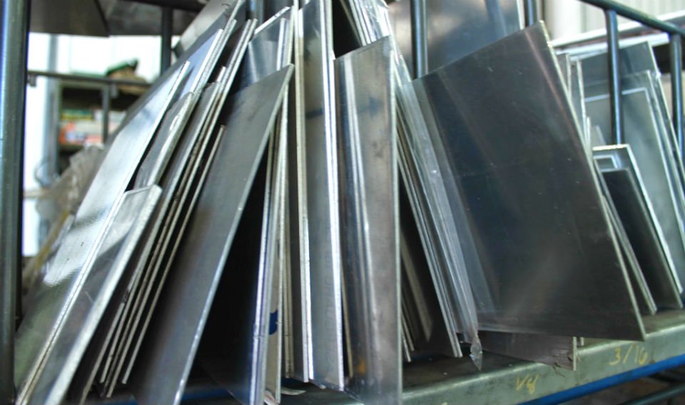

zs&tas wrote: 26 Nov 2020, 19:48 I've just taken delivery of some metal for welding it 👊
I saw it being delivered...
Is that enough?
Is that enough?
