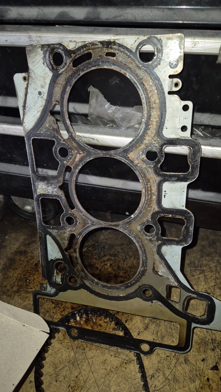

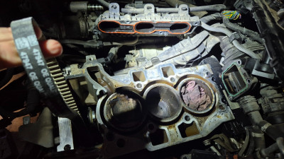

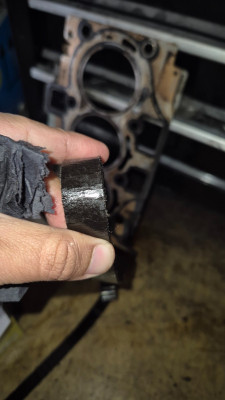

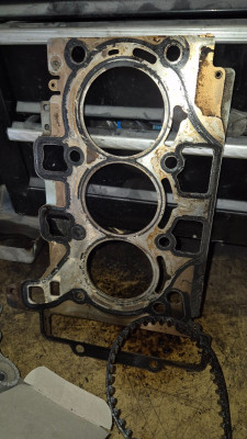

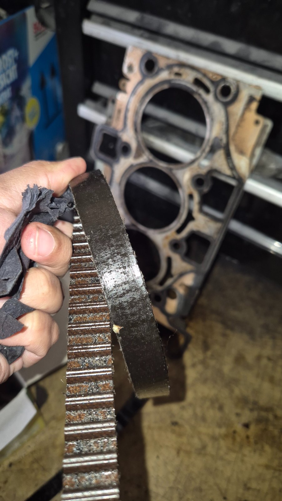

adhi89
- Posts: 9
- Joined: 12 Feb 2025, 07:53
Re: PSA electronic thermostat operation
Hello all
Just wanted to provide some feedback.

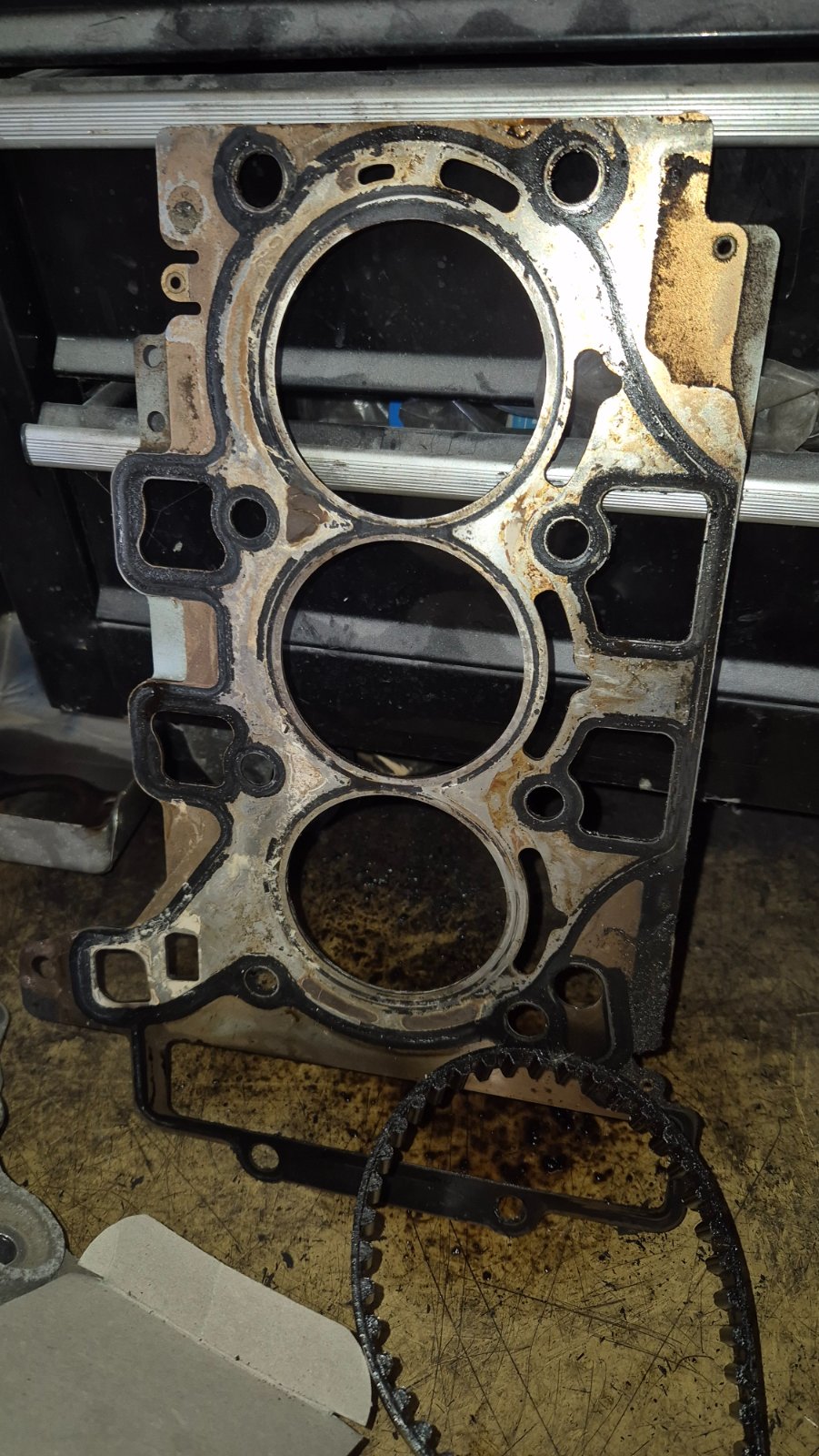

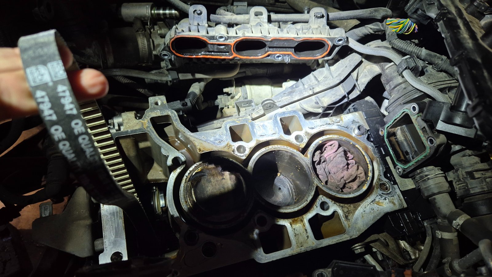

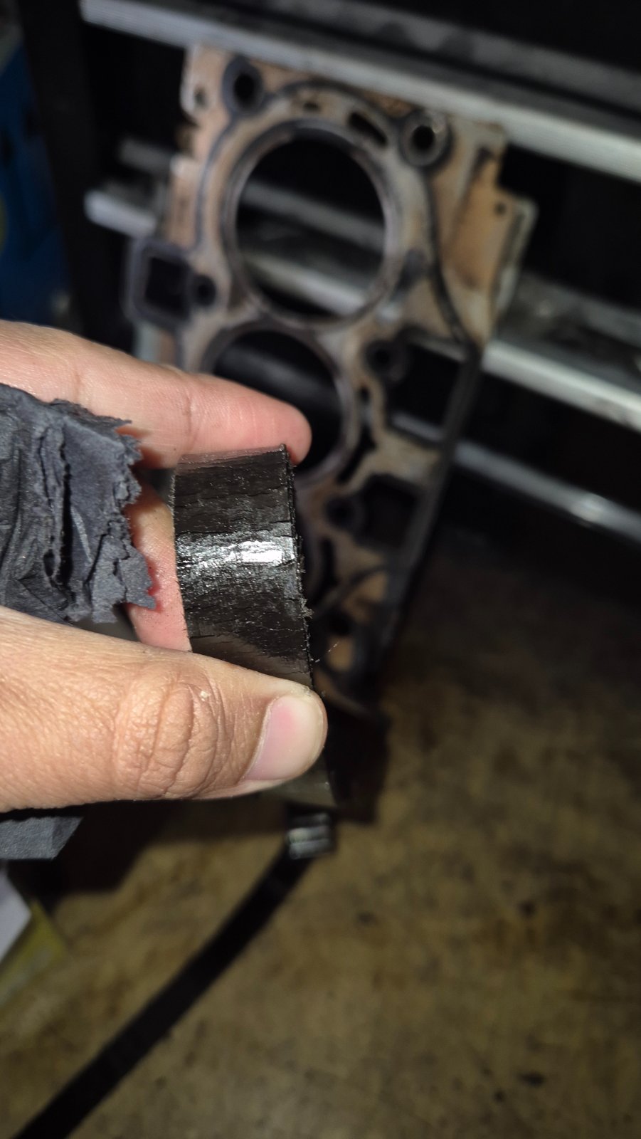

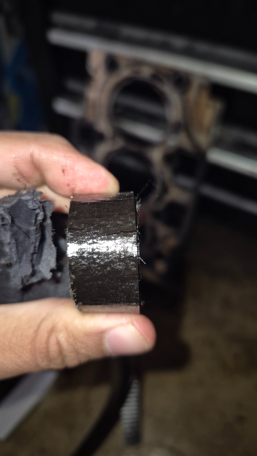

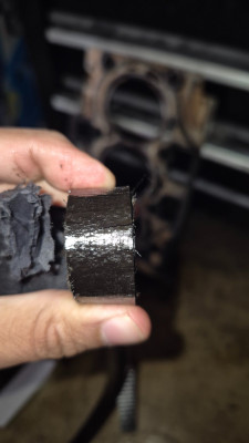

So got the work done by a workshop. Provided him with Parts through Autodoc (wanted to select the best aftermarket stuff possible). Sum is around 1600€ including New timing Belt, head Gasket, Oil with Filter, Coolant, and Seals. All stuff what Peugeot recommended in their estimate. Plus new NGK Spark Plugs, Airfiilter and WaterPump.
The Head gasket was not punctured but the black rings (seals) around Piston holes was worn off at multiple locations. I think the water entered from there. The head had slight deformation as per Mechanic and is grinded on special tool.
Now i really hope all is well and i can test it somehow soon enough.
Some pics attached.
Some pics attached.

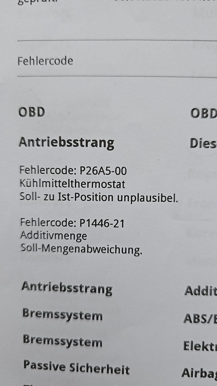

Brankobass
- Posts: 3
- Joined: 14 May 2025, 11:55
Hello everyone, a few days ago I was at the local service center because the air conditioner in the car was not working properly, it was only blowing warm air... The service center said that it was not a problem with the air conditioning system, but a problem with the coolant thermostat, because it gave them the error P26A5-00 and that is why it was blowing warm air into the cabin. It is DS5 08.2016 2.0 180hp. From the previous posts I can assume that they were right. Is this possible, will the air conditioner work properly again if the thermostat is replaced?
Sorry, the service report is in German.

It is likely that the A/C will work again when the thermostat is replaced.
