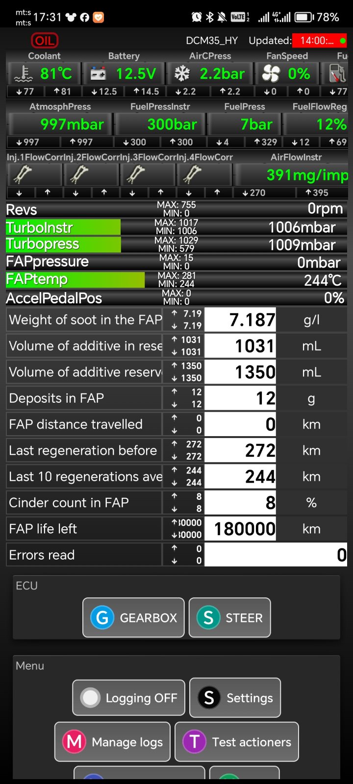

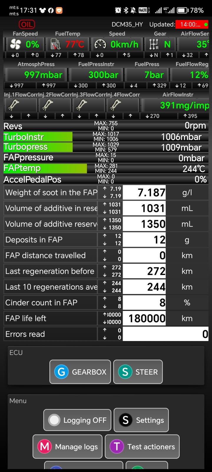

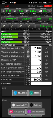

rkomzz
Posts: 14
Joined: 04 Oct 2022, 13:30
Re: DS5 2.0 Hybrid - Overheating & Temperature Issues AFTER Engine Shutoff
Unread post by rkomzz »
After a short run, coolant temp is 81°C and car isn't fully warmed up yet, but the fuel temp is already 77C, how is that possible?
