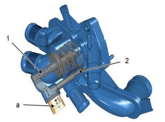

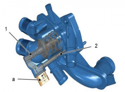

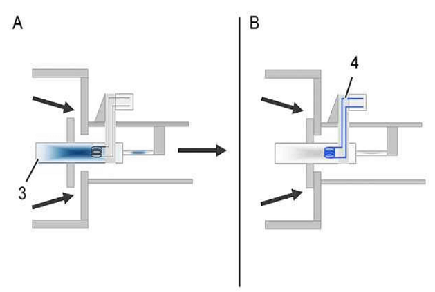

So you have a Piloted thermostat with integral engine coolant temperature sensor:
Here is some general info:
(1) piloted thermostat.
(2) Coolant temperature sensor
The sensor is a resistive, negative temperature coefficient (CTN), sensor.
Roles:
The piloted thermostat permits:
The engine coolant temperature sensor informs the ECU of the temperature of the engine cooling fluid.
Key:
"A" Thermostat open (Piloted or non-piloted depending on the temperature).
"B" Thermostat closed.
(3) Wax.
(4) Heater element.
The wax (3) contained in the piloted thermostat (1) starts to melt from a temperature of 105°C.
During normal operation, the thermostat is not piloted, it regulates the coolant temperature at 105°C.
For full engine loads:
The operation of the piloted thermostat is also determined as a function of the following parameters:
Roles:
- A faster increase in the temperature of the engine for better control of the exhaust gas pollutant emissions
- A higher engine temperature to reduce friction and obtain a reduction in fuel consumption
Key:
(3) Wax.
(4) Heater element.
- The engine management ECU controls the regulation of the thermostat 85 at 105 °C
- The engine management ECU supplies the heating element (4) of the piloted thermostat (1) to add the 20°C that the coolant lacks to melt the wax (3)
- Vehicle speed
- Engine coolant temperature
- Intake air temperature
- Ambient air temperature
- Knock detection
- Engine load
- Engine speed
- Engine management ECU temperature
- Temperature of the alternator

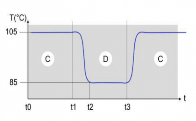

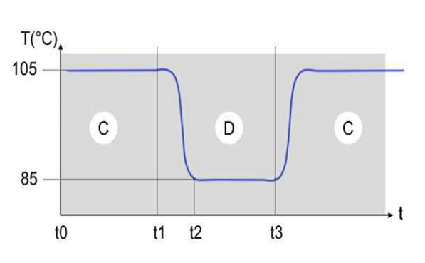

Some further info to explain how it is regulated:
"C" Partial load.
"D" Full load.
"T" Coolant temperature (°C).
"t" Time.

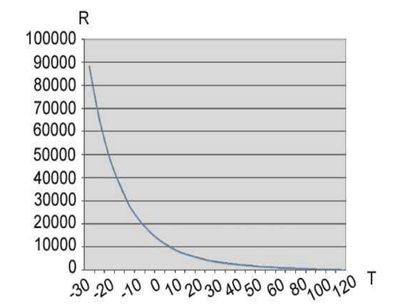

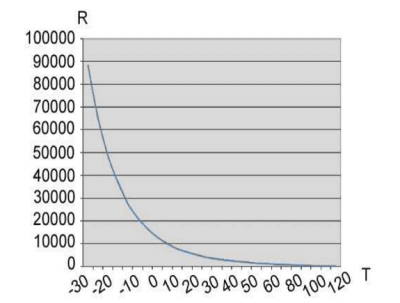

The NTC (Negative Temperature Coefficient) resistance value "R" changes in relation to the change in the temperature "T":
When the temperature "T" increases, the resistance value "R" decreases
When the temperature "T" decreases, the resistance value "R" increases
"R" Resistance ( ohms).
"T" Coolant temperature ( °C).
"C" Partial load.
"D" Full load.
"t" Time.
| Time | Operating phase | Description of the operating phase |
| t0 and t1 | Partial load | The engine management ECU does not activate the piloted thermostat regulation control; The regulation of the engine coolant temperature is performed at 105% to guarantee a saving in fuel consumption |
| t1 and t2 | Full load | The engine management ECU detects a full engine load and controls the opening of the piloted thermostat by means of the internal resistor which melts the wax, simulating a temperature of 105°C. The engine coolant temperature decreases and stabilises at a temperature of 85°C |
| t2 and t3 | Full load | The engine cooling is regulated at an engine coolant temperature of 85°C, to avoid an excessive engine operating temperature |
| t3 | Partial load | The engine management ECU detects a partial load and no longer controls the activation of the piloted thermostat internal resistor ; The controlled thermostat again regulates the engine coolant temperature at 105 °C |
| Temperature (°C) | Resistance (OHMS) | Tolerance(s) (in °C) |
| -30 | 88500 | ± 0,97 |
| -25 | 65200 | ± 0,97 |
| -20 | 48535 | ± 0,97 |
| -15 | 36475 | ± 0,97 |
| -10 | 27665 | ± 0,97 |
| -5 | 21160 | ± 0,97 |
| 0 | 16325 | ± 0,73 |
| 5 | 12695 | ± 0,73 |
| 10 | 9950 | ± 0,73 |
| 15 | 7855 | ± 0,73 |
| 20 | 6245 | ± 0,73 |
| 25 | 5000 | ± 0,57 |
| 30 | 4028,5 | ± 0,57 |
| 35 | 3266 | ± 0,57 |
| 40 | 2663,5 | ± 0,57 |
| 45 | 2184,5 | ± 0,57 |
| 50 | 1801,5 | ± 0,57 |
| 55 | 1493 | ± 0,57 |
| 60 | 1244 | ± 0,57 |
| 70 | 876 | ± 0,57 |
| 80 | 629 | ± 0,34 |
| 90 | 458,9 | ± 0,34 |
| 100 | 340 | ± 0,30 |
| 110 | 255,6 | ± 0,30 |
| 120 | 194,6 | ± 0,30 |
| 130 | 150,5 | ± 0,70 |

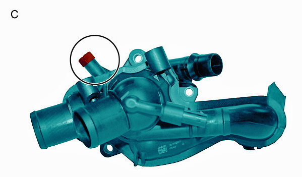

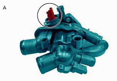

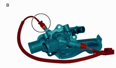

HI
I just revisited this topic in light of your recent post and did a bit more research - and it seems there was a modification made to the outlet cooling housing due to various incidents linked to the engine coolant temperature sensor.
This only affected Euro 5 engines (which your is) and of course the modified housing or the repair that needs affecting will vary on the type of housing fitted, which depends on whether an Auto Box is fitted and whether there is a Turbo or if it is naturally aspirated.
I won't put up the repair procedure at this stage, but this may help you identify which version you have fitted to start with. If the repair then needs undertaking let me know. Some vehicles may have had the modification already undertaken post sale, so if you have 'A' or 'B' then the mod has been done, but if you have 'C', then it needs doing.

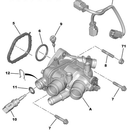

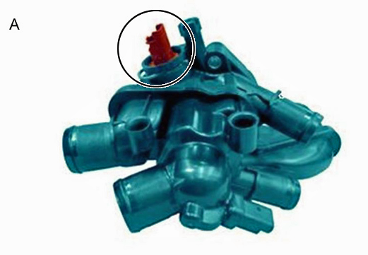

| Figure "A": Coolant outlet housing with removable engine coolant temperature sensor installed next to the bleed screw: Fitting correct; No operation is necessary. |

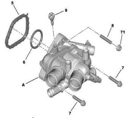

| Figure "B": Coolant outlet housing with integrated engine coolant temperature sensor and engine coolant temperature sensor fitted with a wire installed in place of the bleed screw: Fitting correct; No operation is necessary. |

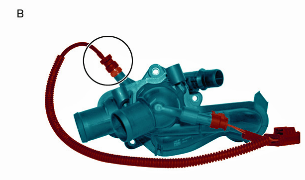

| Figure "C": Coolant outlet housing with integrated engine coolant temperature sensor and bleed screw: Incorrect fitting; Carry out the repair. |

Re: PSA electronic thermostat operation
Thank you Marc, that is very helpful.
My 2007 Peugeot 207CC 1.6 VTi automatic had Type A fitted, with the removable temperature sensor and separate electrical leads for it and the heater element. There was no adaptor harness so I assume it was original? (VIN VF3**************[VIN obfuscated, can be read by forum staff]). The mistake I made was buying a new thermostat meant for the MINI R56 with an extra outlet for their expansion tank mounted on the LHS of the vehicle.
My 2013 DS5 THP1554 (VIN VF7**************[VIN obfuscated, can be read by forum staff]) puzzled me at first because I could not find the bleed screw, until I realised that it was on the same fitting as an electrical lead. Instead of a cross screw head the fitting had only a single slot, and to bleed the thermostat meant winding up the harness lead a number of turns. I thought that quite strange. So it appears to have the integrated ECT sensor AND the bleeder combined, and would match C if it had a lead connected to it?
- x 6947
If the tank looks like 'C', then it would look like 'B' after the modification. 'B' is showing the tank after the modification was applied.
