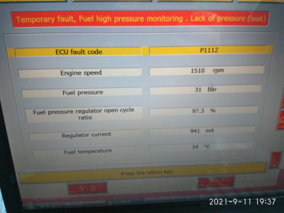

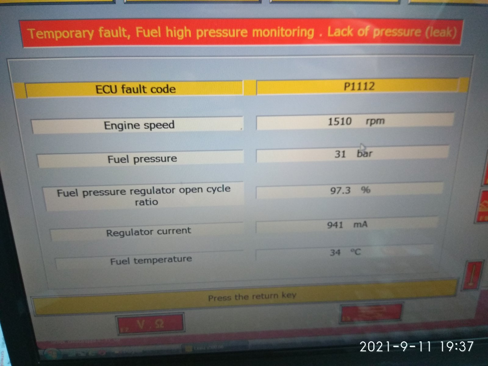

Was driving at low throttle behind a car today and the engine starting making single bangs which I knew was fuel shortage. Didn't put the eml on though for about a mile.
Waited a few minutes and then it started again.
Here is the fault p1112.
wheeler
- Posts: 7927
- Joined: 21 Sep 2002, 19:07
- x 1056
Re: Xsara II 2.0 HDI 90 limp mode
OK as per your PM. Cutting out that yellow connector certainly wont do any harm & they can be troublesome but normally the problem this causes is the engine runs on for about 5 seconds after turning the key off. It also usually logs a fault code something along the lines of 'fuel pressure regulator stop requested but still active' (or words to that effect). Like i say it wont do any harm to chop it out. If i remember right the wire colours are different at each side of the plug so best to cut & re join them one at a time.
I also notice that the fuel pressure when the fault occurred is only 31 bar, if there is a fault with the fuel pressure sensor or its wiring i would normally expect to se a default value reading which from memory is around 450 bar. The fact it is showing such a low reading kind of suggests that the fuel pressure is actually low. Now i've only skimmed over all the previous posts so i may have missed this but has the low pressure fuel pump been replaced? last thing i remember reading is that it was replaced around 15 years ago? I would say getting anything more than 5 years out of one of these pumps is a bonus. It may be cutting in & out. If you disconnect the fuel pump when the engine is running it will run for about 5 second then splutter out, it could be stopping then kick back in after going over a bump.
Unfortunately being so intermittent it could be a pain to pinpoint this fault. If this was mines & the LP fuel pump was over 5 years old i think i would be replacing it.
