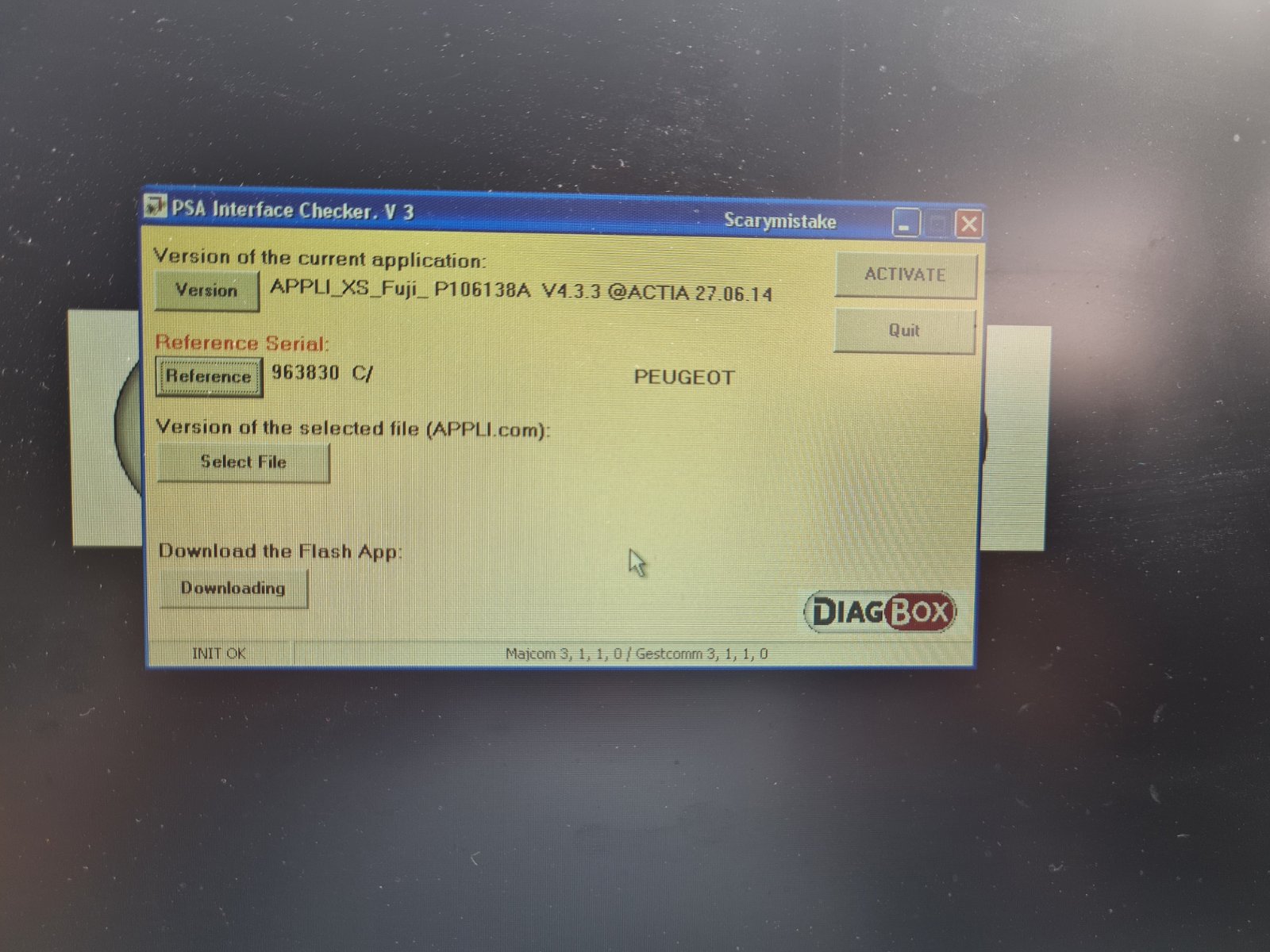

At the moment the version of my interface is 4.3.3 and I am using diagbox 7.57. The diagbox is unable to detect the VIN. Please help me sort this out.

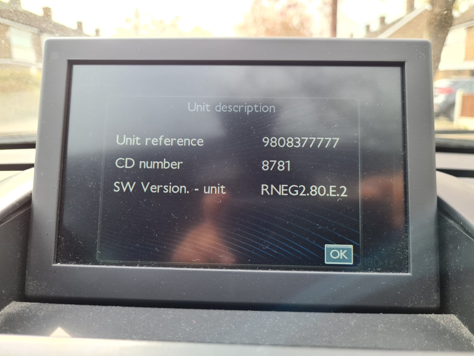

AlamSAsif wrote: 05 Apr 2020, 13:10 Hi. Received the unit and connected it. It powered on and it keep beeping. Its because of the VIN not configured I think. The firmware is 2.80. I will connect my pc and try to update the VIN code fist and see if it works. Will update after that because I think need more configuration as well because the Hybrid information is not showing on the display. Thanks
Yes - if you have Firmware 2.80 - I strongly suggest you leave it at that! Get all the options working. I would not update it to 2.86 as it is a well known fact that it will reset the Head Unit again and you will be back to square one. It will go into secure mode and will require the dealer (an expensive diagnostic session) or Mirascripts to rectify - as it can't be configured with Diagbox.

Thanks for your reply. Any suggestion regarding the issue with my diagbox. Thanks

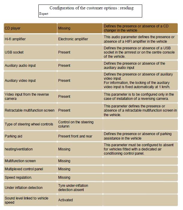

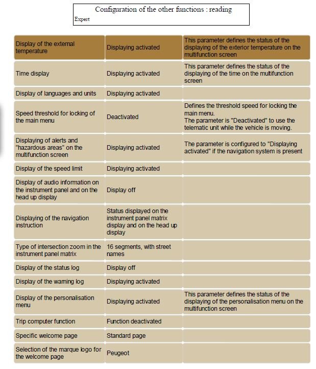

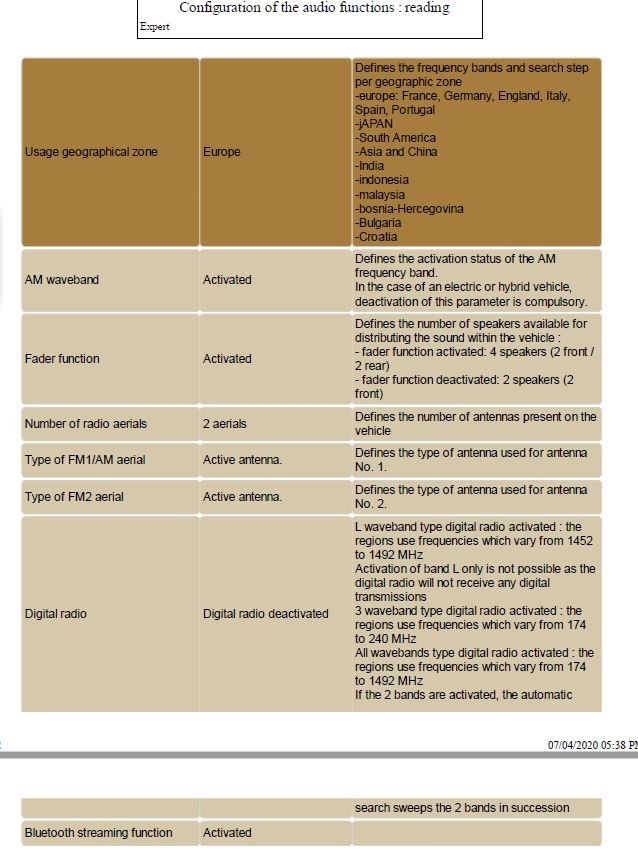

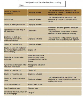

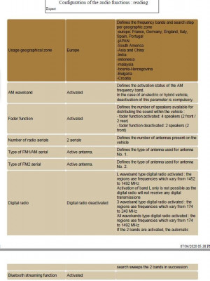

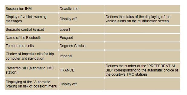

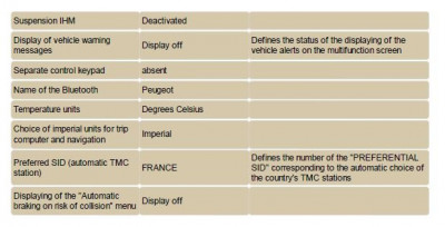

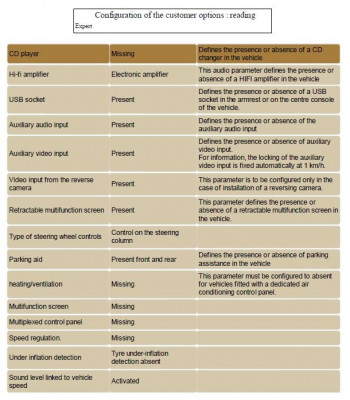

The current settings of donor unit are as follows:
x 6945
Re: Peugeot 3008 Hybrid RT6 not booting.
Ok, that's great, leave it with me and I'll sort something out for you in the morning. :)
x 6945
Actually, had time to scan through and these are the areas I think you need to change:
Preferred SID (Automatic TMC Station): Set to UK
Auxilliary Audio Input: Present
Auxilliary Video Input: Missing / Absent
Video Input from Reverse Camera: Missing / Absent
Parking Aid: Rear Only

I didn’t mention the AM waveband option also had to be deactivated too - as I thought that was self explanatory in the notes on the right, but Paul reminded me to make sure you set that to deactivated.
x 6945
Paul-R wrote: 08 Apr 2020, 12:39 Slightly off topic - why should the MW have to be deactivated if the vehicle is all electric or hybrid? Could it be because the electric motor and associated electronics pump our so much electronic interference that it would be unusable I wonder?
Yes Paul - the electromagnetic noise from the electric motor can interfere with the reception, but nothing more clandestine than that. It just creates a lot of static feedback rendering it pretty much useless.
